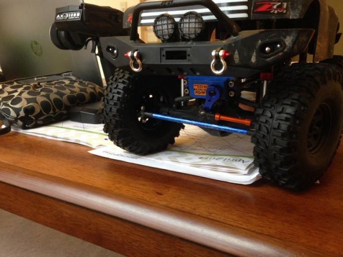

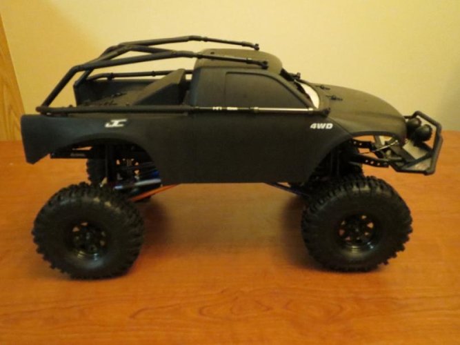

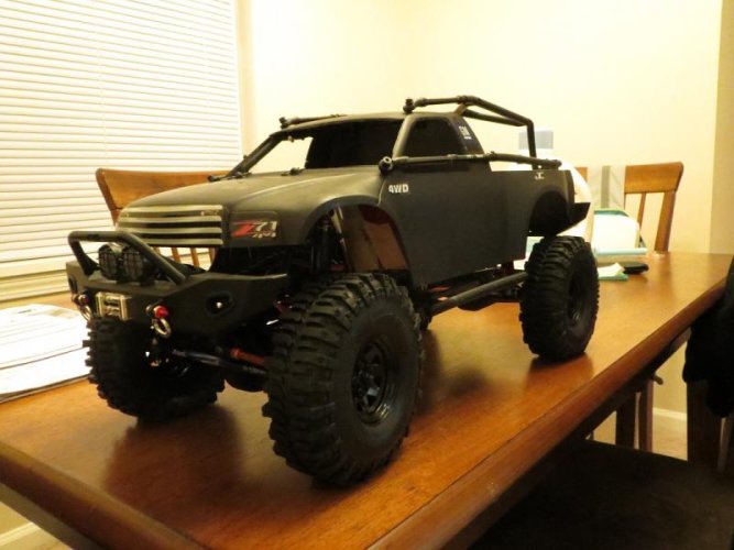

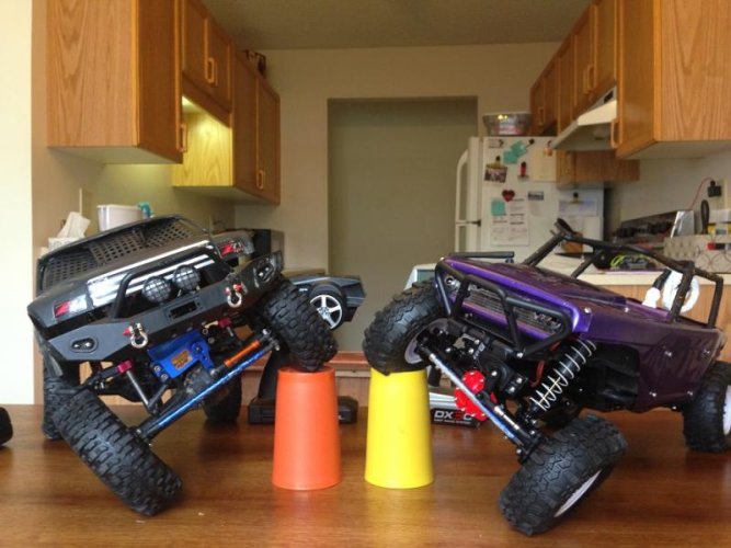

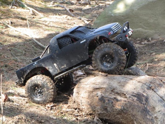

Fiddled with shocks, lowered the rig a bit while preserving the travel. Without doing a lot of trimming, and other fab I don't feel comfortable doing without a dremel, I think the body will sit at its current height on the frame. I took some shots of new bumper and ride height. Still probably too high, would like to know if I'm getting there though.

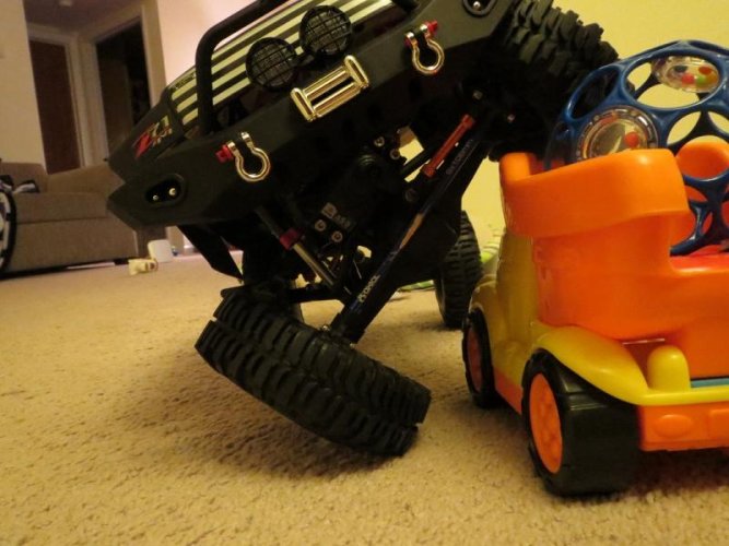

Pics of articulation and ride height(first pic before, the rest after). New bumpers as well. Think I should shorten the wheel base a little bit also.

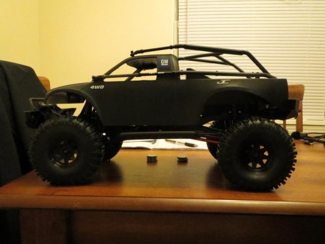

Looks way better! Only thing I still cant justify is that contraption of a cage on the back. Without it, it would look tits IMO. Could even give brake line a chance and make your own cage.
Are those swampers 1.55 or 1.9's? Sitting here squinting my ass off trying to read the tire hahaha
Body is Clean!
Swampers are 1.9s.

After taking the cage off and throwing some ideas around in my brain pan, a friend of mine(more like a brother) called me and the idea popped up to use some of the badges he has given to me on the back. After running it by him and his reply being I'll send you a small variety of newer ones I decided the cage is gone and replaced by a Velcro strip that can hold whatever patch I feel like running that day.
Gonna do some more work on lowering the rear about a half inch.
The whole truck sits at stock height now. I have done a rough measurement and I have about 5 mm more upward travel and about 25 mm more downward travel of the axle. Working on shortening the wheel base now.
My only problem withe the cage is the bars that go along the doors. Just looks wrong. Imho. You almost have a zombie survival truck look going there. Maybe some bars added to the windows and spikes! I know the zombie rigs have been kinda done but hey if it looks cool.
I have been thinking of doing a Mad Max type rig myself.
I agree. I think without adding more apocalyptic theme to it they are out of place. Not really going for that ATM so the cage is set to the side until I have some means of fabricating one to fit.
I like the height and flex I'm getting out of the truck now. I need to shorten the wheel base by about 15-20 mm. I think it will look right in the rear and I might be able to save the wheel wells I have left. Gonna take a look around and see what I can find to help with that. Put the tsl's back on to see the look and it's alright. Not sure what look I like more. Will get around to that after shortening the wheel base.

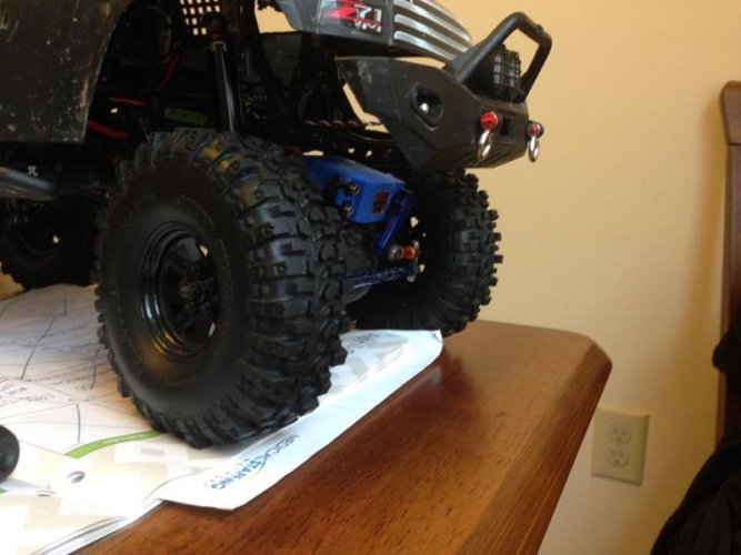

It has been a while since I have updated this thread. Shortened the wheel base by about 8mm, would like another 4-6 but I like the way it performs so I probably wont mess with the wheel base any more. Sticking with the boggers, saving tsl's for future build.
The truck still leans a little when under torque but not enough to effect it when bound up on some rocks or tree roots.
Have a set of t-rex 60 arb axles I am going to put under it and a new servo to go with. Current stock servo still works fine and will be used with a upcoming build as a secondary rig for my wife to use as well as the stock scx10 axles.
Truck is running on stock esc/motor with a 2s 20c lipo so I an confident I wont be breaking axles or anything in the T-Rex's.

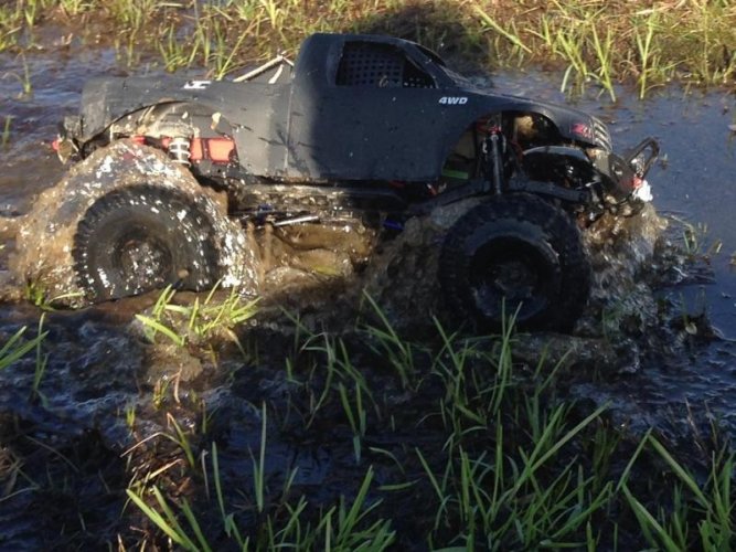

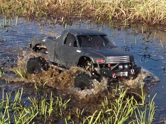

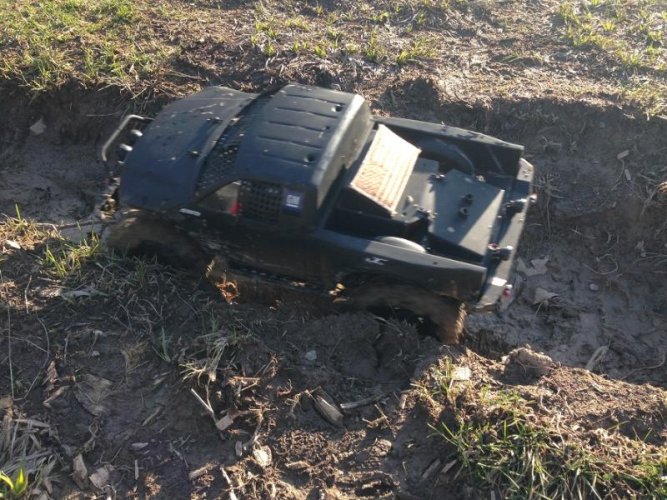

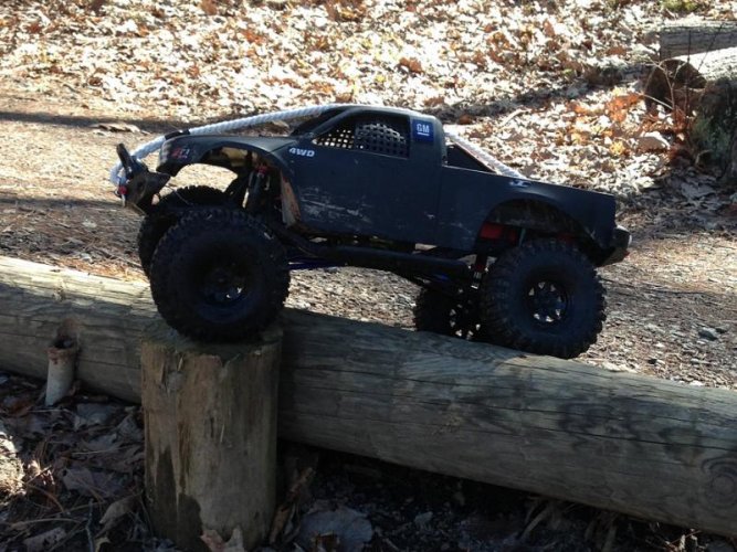

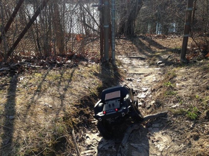

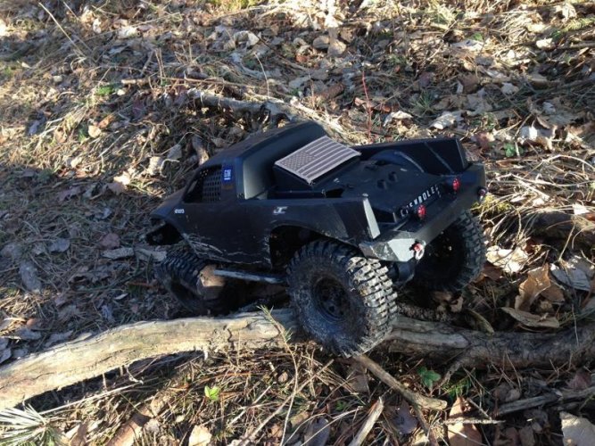

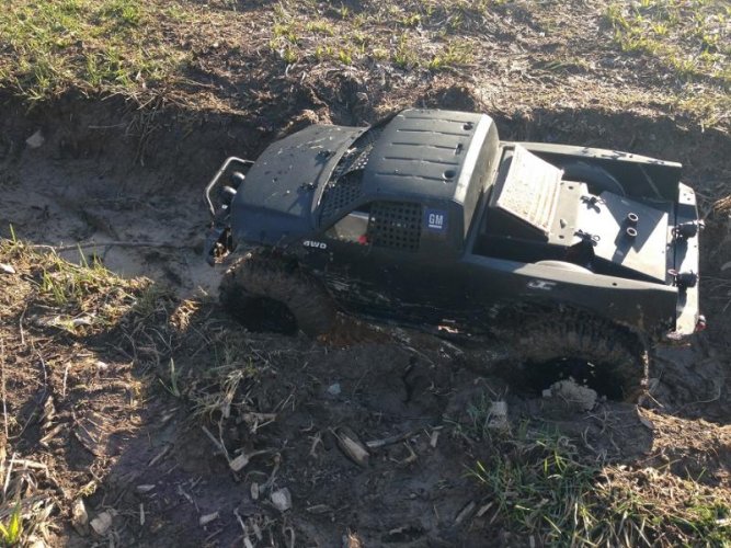

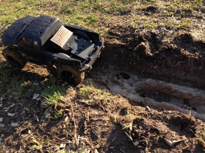

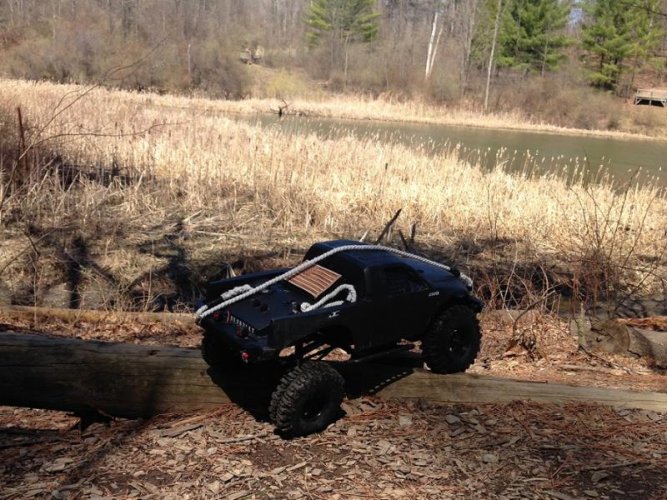

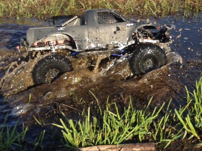

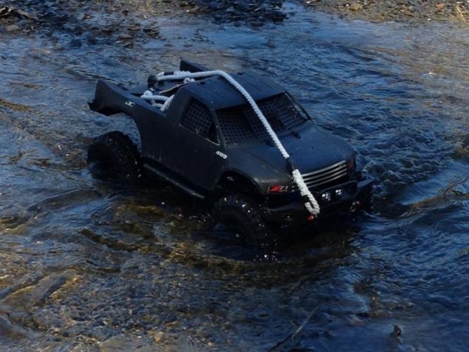

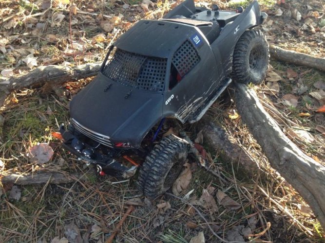

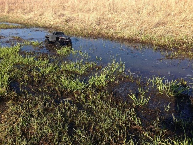

Had another hiking day. Can't wait for the 1.9 wraith to join us, but its still in the works, a lot left on it before we get to trail shots. Here are the trail shots from today. Latest upgrade is a savox waterproof servo within the 200 oz range, I don't need much more than that on this rig. I am looking into new foams for the boggers though, trying to soften them up a little bit and get some more bite on the rocks. As most of my funds are being saved to get the 1.9 wraith a motor/esc, they probably wont be here soon unless I win a give away or something.
Hope you enjoy the pictures!
Happy Crawling,
First up is a creek we found, got deep enough to hit the windows at one point but we made it through!
Next we came across I nice spot to park and relax for a minute. Enjoy the sounds of nature a little bit on a nice day.
Next was a muddy hill climb through a small wash out. Hard to capture the angle of the truck, but I'm glad I stiffened the suspension in the left side! Now if those tires weren't so bouncy( working on venting the wheels or tires when I get new foams).
Lastly on the way to the parking lot, there was a long straight bridge. Decided to let the scx pull the stroller this last bit( Mom still steering of course ).
Over all a nice day, all these pics are taken with an Iphone, apologies if some are a little choppy, Overall a nice day on the trails!

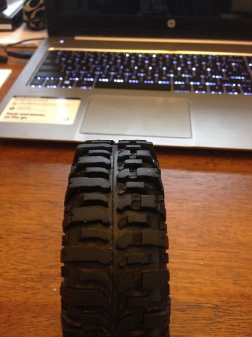

Found a way to cut them I was comfortable with even though they aren't vented or using good foams. Based of this...
Hope they perform! Should find out this weekend.
Here they are! My scx10 has a new hiking buddy. will get some shots of them hill climbing this weekend.

Nice job on the trad trimming. Best looking set I've seen yet.
