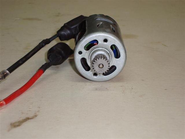

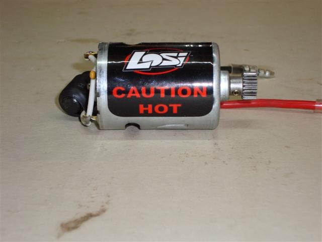

hey wondering, i was tearing down my lnc again last night...there sure is alot soldered to the motor wires...is this for the lipo option? just wondering, thinkning about a motor upgrade and didnt realize if there is really any main importance to the diode/capicitor or what ever this stuff is. any input?

No need for the capacitors on the motor. On gearing going down in teeth will up torque and lower wheel speed going up in teeth lowers torque but ups wheel speed.
well, i asked jrcheese this last night, he said it was installed from the factory for limitation of radio innerference on the reciever....so, im just gonna leave it cuz getting glitches on a precise monuver could suck! lol

the stock capacitors are to help protect the ESC, not for radio interference. I reccomend leaving them on there just to be safe.
the advil looking ones were used to cut down on the motor noise/radio interference back in the day of AM/FM radios. with FASST/DSM radios these days you dont need to use them.
Ahhh, all very interesting and new to me. Thanks guys, i am gonna leave it all in, probualy even when i upgrade the motor too. They dont hurt anything, and thinking about a bec now that ive seen one and understand what they do.

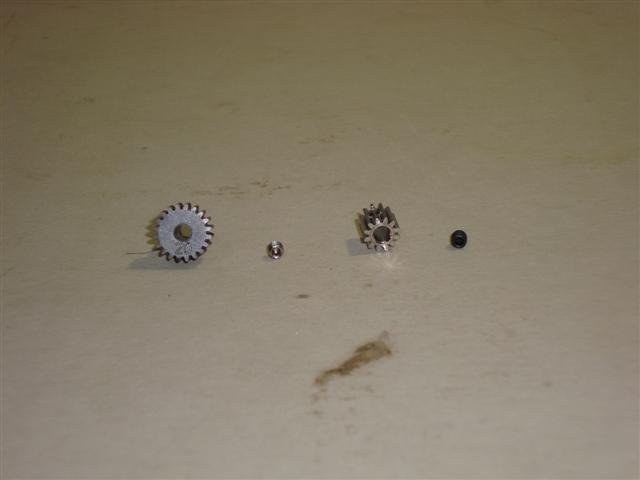

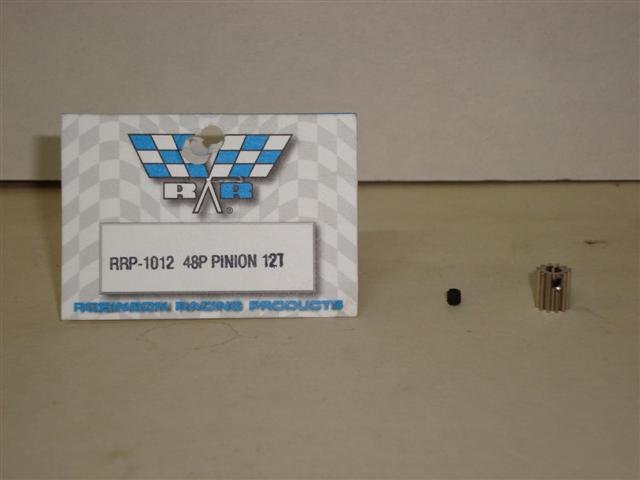

Hey Sik Boy, you know when I picked my HB Rovers I also got a pair of different pinions just to do some proves, as you are thinking before to change motor.
I got 12 teeth and 16 teeth pinions, so I first change tires, Rock Claws for HB Rovers with original 20 teeth pinion and it seems to have loosen the power:cry: you know just when I more needed the power in a tight course it got blocked, so what’s the problem, I said myself??? Thinking about I could figured out that the large diameter of the Rovers and the softer compound of the inserts and the added weight at the wheels were too much for the stock motor.
So I gearing down to get my power back, I was directly with 12 teeth pinion and the stock motor push again, but it got very slow speed.
After using this setup some months I decided to prove with 16 teeth pinion and it make a nice difference, enough power and a reasonable speed wheel:mrgreen:
Just my experience, hope it brings you some idea what to do.

lol vasco, 20t to a 12t! thats a big jump, do you pull a wheel from a standing start? i picked up a 18t pinion and swaped it out last night but im still running the poop out of my factory tires. also, as i stated in the begining of this thread the issue i had with the set screws on the drive shafts...they are locked in good! jrcheese helped me out alot last night, we had to drill the f'ers out and use an e-z out to completely remove them!

good pics on the motor/pinion swap vasco...thankyou!

The lnc motor is the same in the losi slider the caps that are on there serve kinda like a fall back for the speed control under low end use when the caps. Are removed the motor heats up faster and causes radio glitches from the static electricity from the motor
