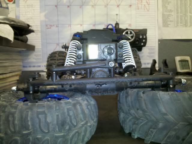

okay...here some pic updates everybody...
my new steering...
heres the P-L masher 2000's i swapped out...
this is the pic of the upper links i made that went on the rear, in this pic they are alot longer, i trimmed and trimmed and then trimmed, thealuminum one is now literally a bolt hole in the rod end longer thatn the oe upper link.

d lux, i have not raised the mounts at the axle yet. i want n need to get the adjustable upper mount head to do that. i was wondering if the links would contact my servo tray and or esc tray...would they?
The most important one and the one thats most likely causing your binding is the rear mount. You dont need the Losi part. You can simply add a .25" spacer under the mount. Doing it this way will also make it so it does not mess with your ESC mount. I wouldnt mess with the front until you get the car more dialed in.
da! ive been so mind trapped on the losi mount i feel dumb:shock:...obviously i have the small tubing to do this!
im gonna try it sir! thankyou.
