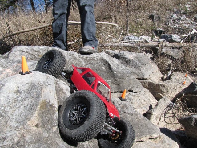

Re: Szczerba's 2012 Secret Agent'd Berg
Truck is really working now after some upper link changes.
I am liking 10.75" up front and 10.5" out back.
RTR Weight is 5lbs 4oz
Mike Manning was on his game as usual.
6 minutes, 10 gates. 3 courses had bonus gates. 40 points.
1. Mike Manning -33 (15, -20 w/bonus, -10, -18 w/bonus)
2. Shane Szczerba -14 (22, -28 w/bonus, -3, -5 w/bonus)
3. Rockedup Ricky 30 (-7, 14, 16, 7)
4. Thommy TGreer 59 (22, -9, 22, 24)
5. Psychocrawler John 83 (22, 26, 7, 28)
6. Jarred 106 (26, 22, 28, 30)
7. Boone 120 (28, 28, 32, 32)
Video from one of the runs at Crystal Lake, AR. NWARC 1st point series comp. A couple of tricky gates I get up slowed up on.
Quality is low.

Man that spot looks like some good crawling! Car looks like its working well. "thumbsup"
Truck is getting butter smooth now.
It is a cool spot. About 50 yards of it. Creek bed that is shaded during the summer too. "thumbsup"
