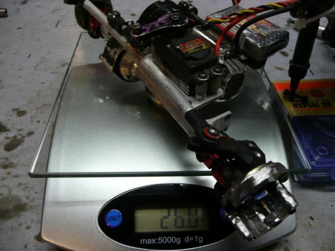

Total weight of chassis/axles etc (including battery) minus wheel/tires
52.3 oz
Chassis (including battery, links, esc's, etc)
11.0 oz
Rear Axle
15.3 oz
Front Axle
26.0 oz

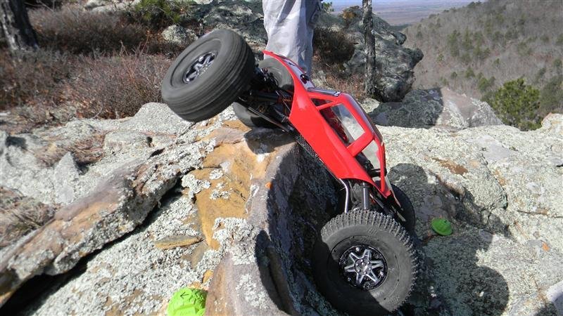

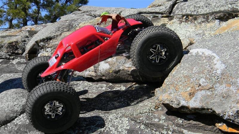

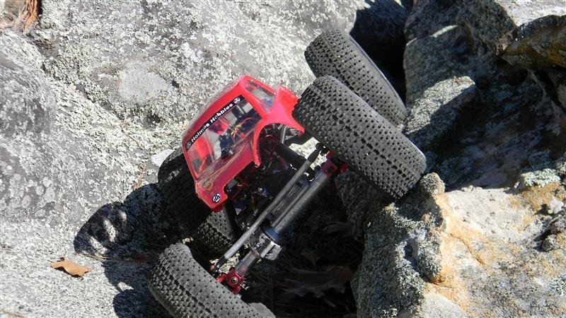

Pictures from the ARCC Petit Jean comp.
Truck looked good but my driving skills did not.
Not to mention it was 19 degrees and windy when we started course 1. :shock:
Thanks to Helhedded for the pictures.
RolandRockShop was filming the whole time. Those will be up before too long.
52.3 oz
11.0 oz
Rear Axle
15.3 oz
Front Axle
26.0 oz
I think what Manu was asking for is your RTR bias. Meaning weigh the front and rear axles with the car level, and see how much heavier your front is.
My agent car at 4lbs 14oz has a 19 oz front weight bias. And balances in front of the front rod end screws.
I would add front weight until the balance point moves to at least the front rod end screws. Also, Jesse is right about zero Ackerman. Y'all could have been enjoying the benefits of zero Ackerman and disliking the KPI with your 8* setups at the same time.

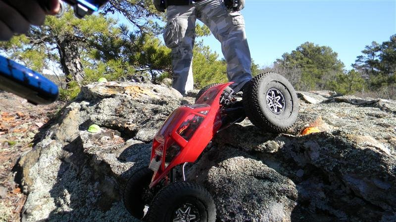

Re: Szczerba's 2012 Secret Agent'd Berg

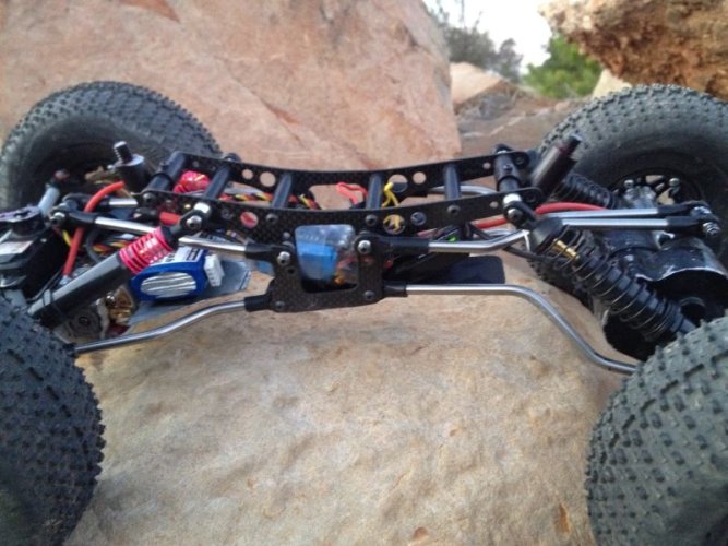

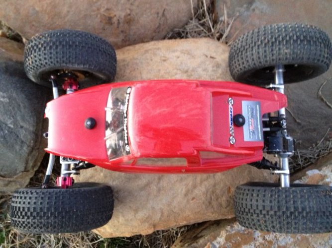

Changes over about 9-10 battery packs. Kinda in this order.
1. Got in D-Lux knuckle weights and added a brew of homemade add on weights to get to 4.2oz total each side. Truck is 5lbs 4.8oz RTR
2. Narrowed up to 10.75" up front and 10.5" out back
3. Pink springs up front with 40wt oil, still 3 hole pistons
and swapped out to 2.75" Losi 1.2lb black springs out back, 40wt oil, still 3 hole pistons
4. I was running the upper links all the way down on chassis front and rear. The truck was doing ok but struggling with steep verticals, it would suck down but not grab. So I got to thinking, that's alot of anti-squat on both ends. Figured that might be a place to start since the truck was right at 5lbs with that setup.
Moved the rear uppers all the up ran a pack. Moved the front uppers one up from top, in addition to changing the rears, ran a pack. I could tell the truck was grabbing and holding on verticals and had more traction overall. That is the same link placement I have run on most of my berg setups.
5. Was running 11mm of external limit up front and none out back
Now running 6mm external limit up front and 5mm ext. limit out back
Truck is riding alot better now. Feels like my old SS, minus some rear shock spring tweaking still. The 1.2lbs blacks maybe a touch too firm.
In case anyone wants to know.

Quick video of a ledge at my rock pile at the house. Previous upper link setup would not crawl this ledge. Semi slick rock and and almost 2 year old Khaos with CrawlerInnovations Closed cell inners, soft outers up front, medium outers with medium tuning ring out back.
<code><iframe src="http://player.vimeo.com/video/37283581?title=0&byline=0&portrait=0&color=ff9933" width="601" height="339" frameborder="0" webkitAllowFullScreen mozallowfullscreen allowFullScreen></iframe></code>
The bias looks a lot better! That is the geomety that Krawlfreak ran at 6lbs, or at least really close. So that makes some sense I guess. I gotta think the extra front weight/new bias plays a big role also.
Maybe try the reds in the rear? Also in the pics your front shocks look almost completely bottomed out! How much does the car sag under its own weight?
I could tell the truck was getting better with small front weight additions. I added the 4.2oz to each side and it still wasn't climbing verticals well. No bite. So I raised the rear uppers and then the front.
I just tossed the truck down for a quick IPhone picture, so don't go by the shock travel in that picture. Was more for link placement. I forgot about all the eagle eye's out there too! :ror: But the truck has the normal amount of sag, nothing out wack.
I really noticed alot more chassis/shock movement after changing the upper link locations. The truck started floating over the rocks.
The Reds are 1.38lbs I am currently running 2.75" losi 1.2lbs blacks. I need a 1.0 lbs rear spring!
