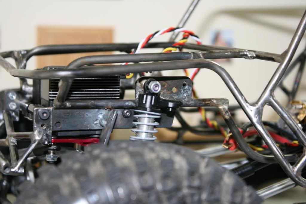

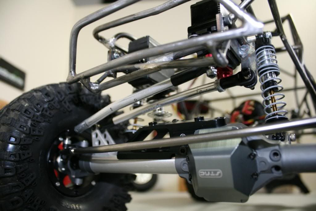

What did you use for the panhard mount on frame? Great build btw"thumbsup"
Thanks, its the VP mount, pictured back on page two or three.
The stock VP panhard mount works but really it could be extended further down and out. I am getting some axle swing but not enough to worry about. This is due to the SCX-HR frame rails at the shock mount points being moved up a 1/2"
