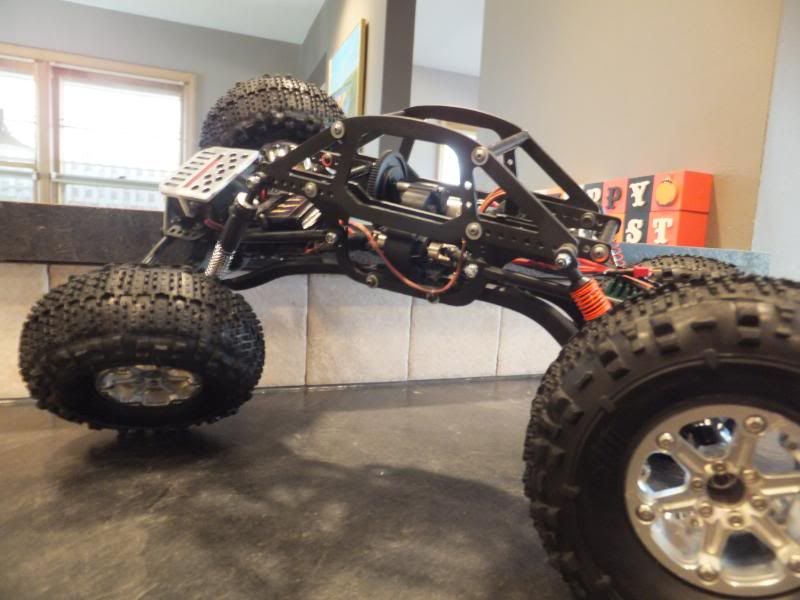

Anyways, its a great looking sporty. I didn't know they made a t1e shafty moon buggy...i guess i started out into the moa era :mrgreen: How much ground clearance does it have?

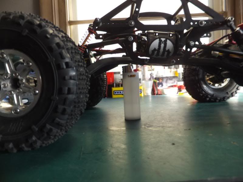

T1E has made a shaft chassis for a couple of years I picked one up last winter I ran it with a dig in the 2.2 Open class, it work really hard for me and was fun to drive best shaft truck I ever had. For clearance it has 4" at the rear and 3 1/2 at the front.
of the Bic plus 1/2"

Cool, thats about the same clearance i have under mine. I pushed it up to 5" of clearance but the cog rose way up and the super narrow losi didn't enjoy it so much.

Yep, my shocks I have about 1/2" of up travel left. I'm still surprised at how well it climbs and side hills with all that break over space below.

Yea, it's surprising, as long as the top of the motor isn't above the top of the tires, it seems to be pretty stable...but above that it starts to get iffy...i think its all the knuckle weight :mrgreen:

I'm running a 2" wide skid right now.. I could probably knock that down another .5". But my motor is already hanging out the side by about .5"...another thing that one would have to worry about is 4 link triangulation, just due to how the lcc links work. so i'm not quite sure what your info is referring too, unless talking about the mounting holes. As unlike on the ax-10 tranny, they're not all grouped together in a small area.

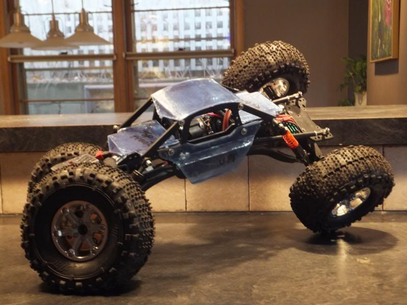

Ran the 2.2 pro class last summer my rig weighed 5.5 lbs. 10 1/2" ft. 10" rr. This new configuration is 4lb. 9oz do to a little dieting. and the wheel base is a 1/4" wider @ 10 3/4" ft. 10 1/4" rr.
I had it on the rocks, ran 4 packs tweaking all the way and it was real sweet I was having a ball but then it snowed so my testing is probably over till spring. :ror:
As far as the rear end the lighter mine got on down hills it was unpredictable. I'm pretty balanced right now with only a slight front bias and it's good now.
All this skinny skidplate stuff makes me want to remove some of the triangulation in my lower links. I love your truck stormin2u. You are an inspiration to get mine tuned better so I can lift it off the ground.
Hey thanks man, glad to help out. :ror: The diet program works well as long as you keep your rig balanced and wide works good. I was to heavy in the front as the weight came down until I figured it out and a tad more rear weight and it's good.
