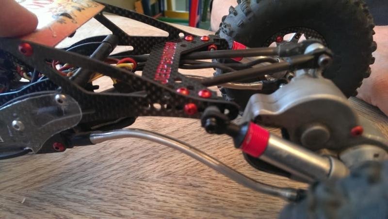

Well I spent a bunch on the Dlux links and they dont work for the chassis so that sucks. When just sitting on the bench I cant get full compression on my suspension if I push the chassis down (using scx10 shocks). Lifting 1 tire off the ground I can get full.
Ill try an take some pics later when im home im happy to hear its normal though lol. Your build has helped me for tons of this build and I thank you!
Thanks man. Glad it helps someone.
Yeah, You're not going to have your shocks compress all the way when pushing the rig straight down. You CAN make it do that, but not without getting really creative with your upper links and making custom cross braces to allow room for the upper links to move up. But that's a whole other can of worms...
my upper links hit the chassis crossmembers first
Not sure if he still makes these. I used them on my Stealth and they worked great."thumbsup" The pic is a T1E Sniper. PM him for info.
