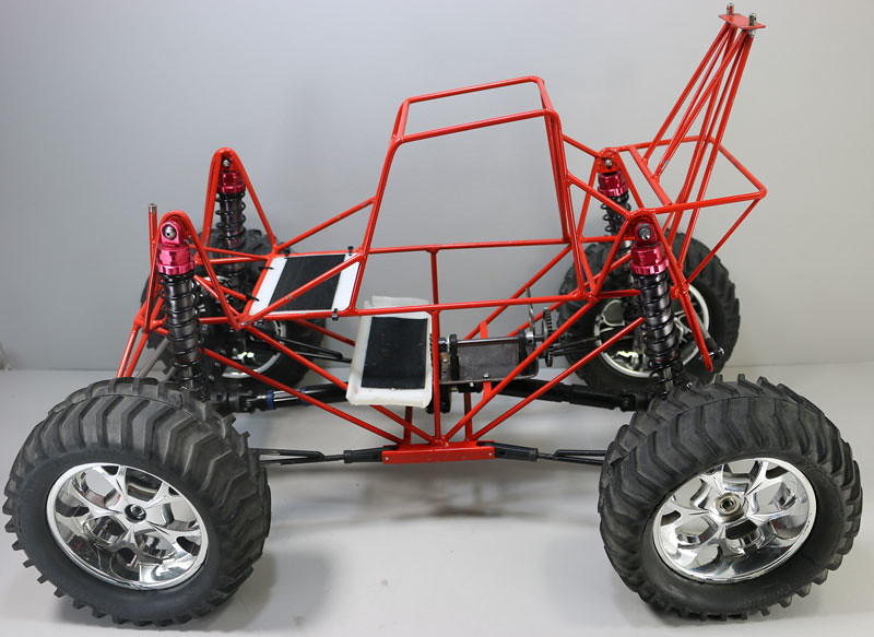

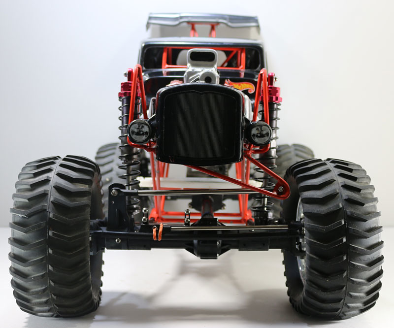

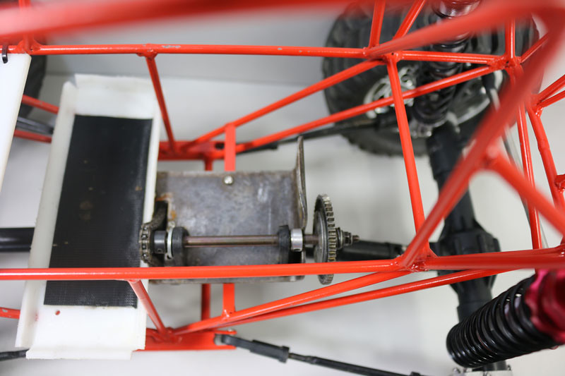

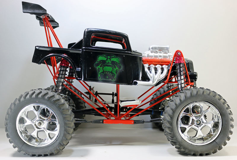

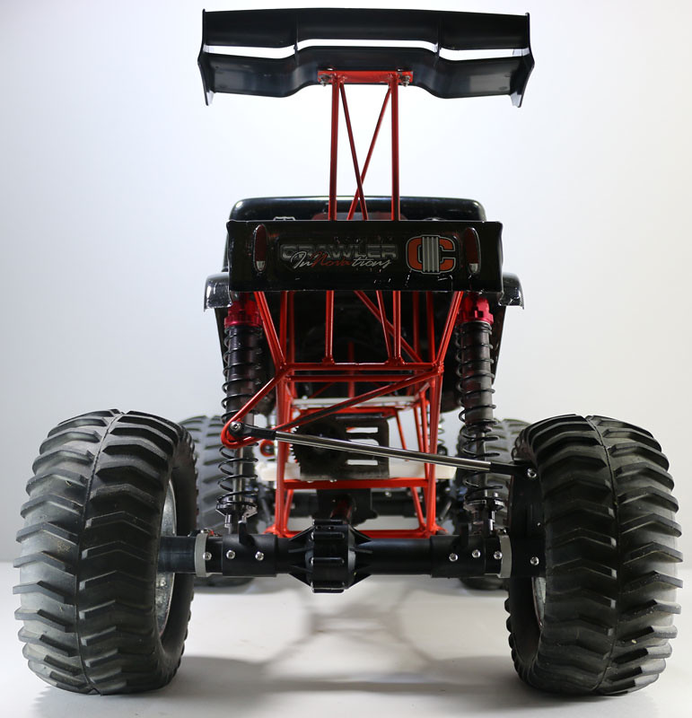

Current pics to update the thread for posterity and specs:
Specs:
Bart Bender solid rod chassis
VP 1/4 Titanium track bars front and rear
HPI 5b Aluminum shocks front and rear
Kyosho mad force transmission
44t steel mod 1 spur gear
Traxxas E Revo drive shafts front and rear
4.30 helical cut steel ring and pinions front and rear
Super Shafty lockers front and rear
Super Shafty delrin rear straight axle tubes
Super Shafty aluminum adjustable link mounts rear
Super Shafty delrin steering servo mount on front axle
VP 3/16 Titanium steering drag link
XTM Chrome Thorn 115mm Rims that have been narrowed on the back side and reinforced with fiberglass
Panther Soft Compound Plowboy Tires that have been Cut n Shut (enlarged)
Crawler Innovations Single Stage Soft foams
Custom painted body by Bart Bender
