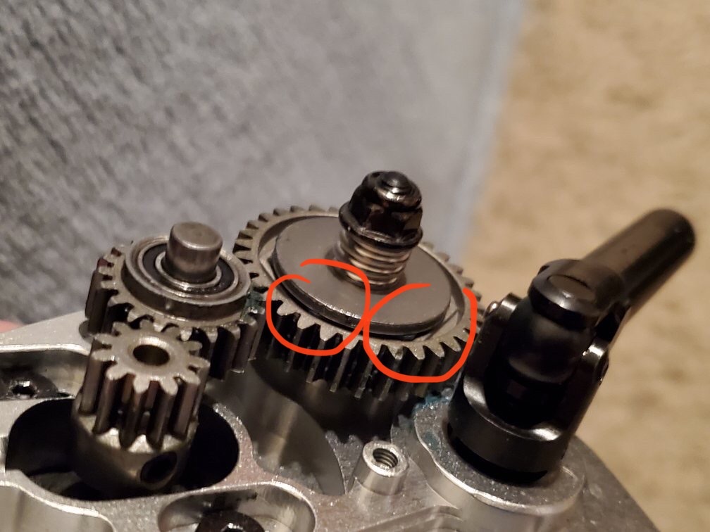

For those interested, I believe I've found the perfect slipper spring to replace the plastic "slipper" piece Axial gives us:
Traxxas part #1994
Officially, it's the "slipper retention spring" for the Nitro Rustler, Nitro Slash, & T-Maxx, but is a perfect fit for the Capra.

Your slipper pad isn’t seated.
I know. Topher Builds caught it already...and, to think, I didn't even notice. Now, I gotta take the friggin' thing apart again. Really getting tired of that...lol
~ More peace, love, laughter & kindness would make the world a MUCH better place
You may be able to loosen the slipper and then spin a driveshaft until it falls into place without removing it all from the cage.
Except that, in order to have visual confirmation that the slipper pad is correctly in-place, that requires removing the transmission housing piece covering the spur gear, which requires removing the trans from the skid, which requires removing the skid from the vehicle. Of course, removing the spur cover piece also requires removing the pinion cover piece, which requires everything else mentioned.
Axial did a great job on developing a vehicle that can do just about anything (that a scale crawler should be capable of doing), but they didn't do such a good job of designing a vehicle that can easily be maintained. From my Traxxas vehicles, to my TLR vehicles, and even my Trail King (which isn't 100% finished) & XRAY T4, all are much easier to maintain. Removing/reattaching the 8 screws (4 holding frame to skid, & 4 holding shocks to frame) isn't so bad, but it's the rest of what must be done, not to mention the "confined" working space.
I'm going to use the CA glue suggestion, using just a tiny 'dot' at 3 of the 6 corners...that'll hold the pad in place, yet without making it difficult to replace...but, don't so might have to wait a week (starting today, I've got a fairly busy work week, plus I'm busy working on my 'Project Predator' project).
Traxxas part #1994
Nice tip!
