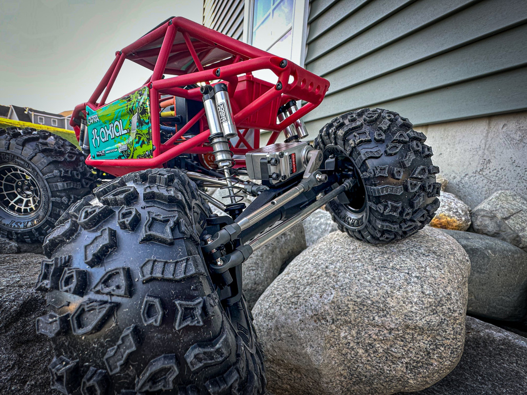

Great looking Capra ya got there. Those Treal wheels are sweet.
Thanks, buddy. Let us know what you choose and how it works out for you. Oh, and post pics!
Roger that, just finishing up a couple things and then I'll be starting a thread. With pics even. Should be pretty good if all works out...

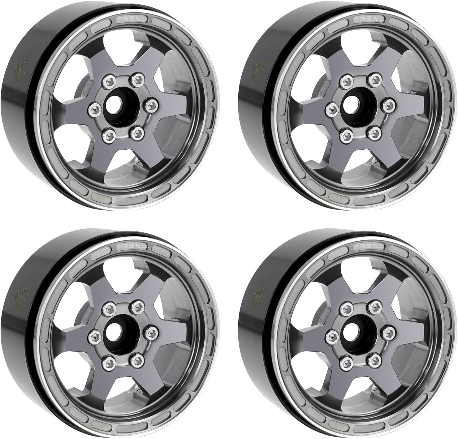

These are the Treals I got, along with some of their brass goodies
