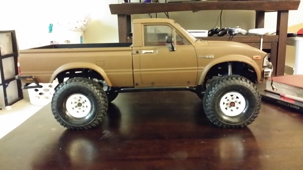

Here are some pics of when I used to run a mildly modded look
1.9 mud thrashers 3.9"

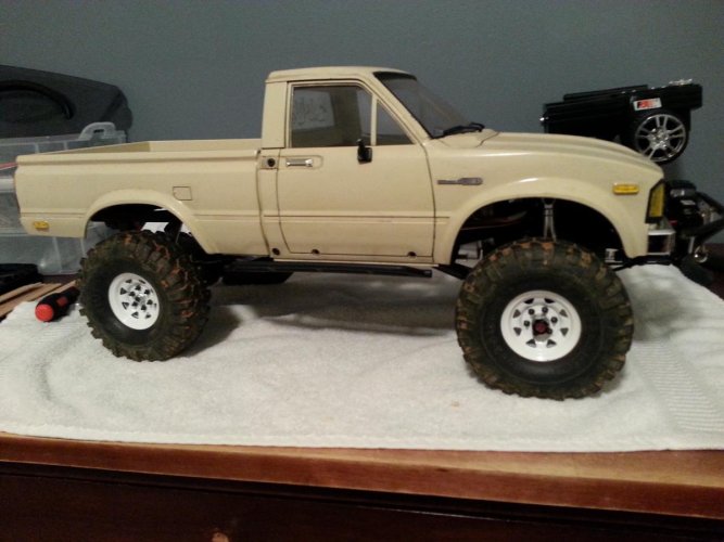

I would recommend the IROK 1.7" and the 1.7" wheels. IMO they are the best scale look and appearance and you will not be disappointed with the performance. RC4WD says the OD is 4.10", but I can tell you they are just a smidgen taller than the 1.9 PL Flat Irons.
I have them on my red truck, take a look.
Alternately on my brown truck, I have 1.55 Pit bull growlers. Their website shows them as 4.19". The are almost identical in size compared to my iroks (physical measurements).
That being said, I didn't have to trim a single thing anywhere in either truck. In only some very extreme circumstances does the red truck rub the front tire on the leaf spring. No issue to me.
Hope this helps.
Hope this helps.

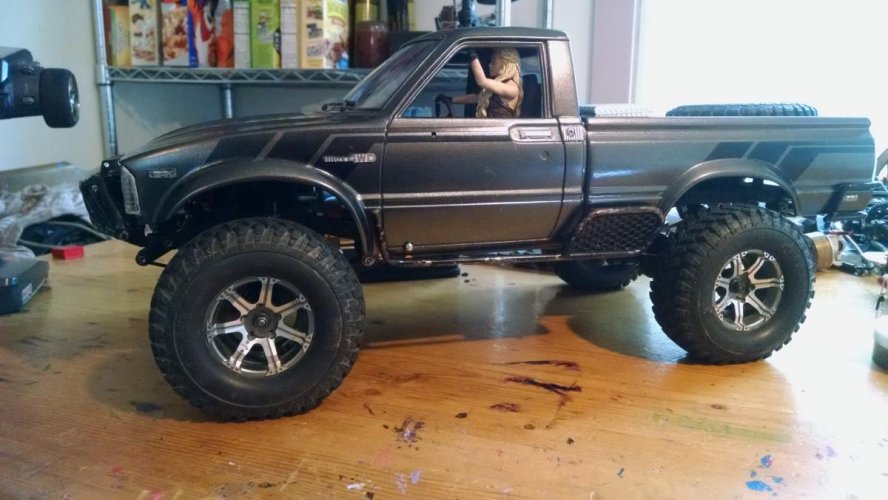

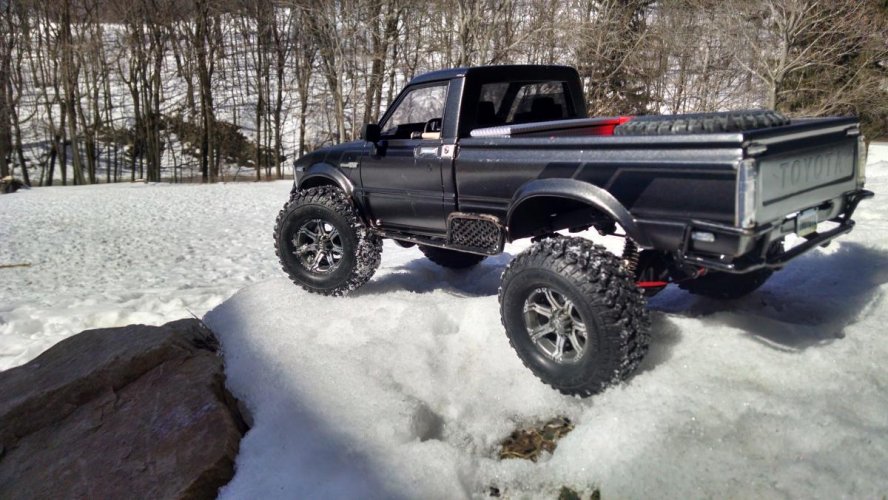

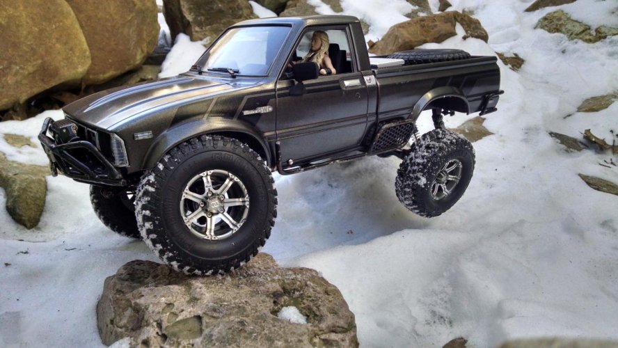

Here's mine with 1.55 Rock Stompers. As far as looks go, these are my favorite tires but not the best performing. I went a long time not cutting off the lower valance but got tired of the limited tire choices and fender rubs. My truck's no shelf queen, its become a trail rig. I did put 3mm blocks under the leaf springs to give it a mild lift.
Its weird how my first pic looks like the rear sits lower than the front. The stance is set up at level ride height. Crazy camera angle I guess.
Same here. I went a long time deciding whether I should cut the valance off. I'm glad I did
