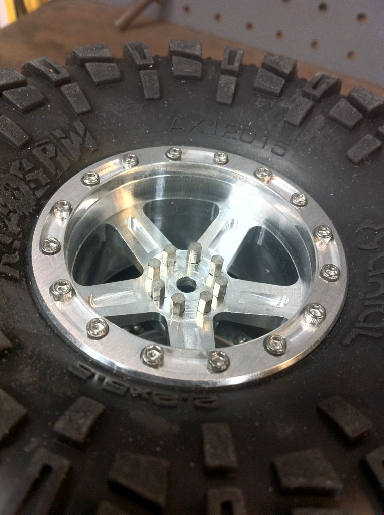

The Scale Shop "Versante" limited run wheels are gorgeous.
The machine finish is 8/10.
Assembly was 9/10.
Price is 9/10 compared to available wheels
Overall scale design is 8/10. (actually found this almost identical wheel on a few WEROCK rigs)
Availability was limited edition, so if you don't have as set, you probably never will. I have serial #001 and #010. Hahahahahaha
( I added the lugs)

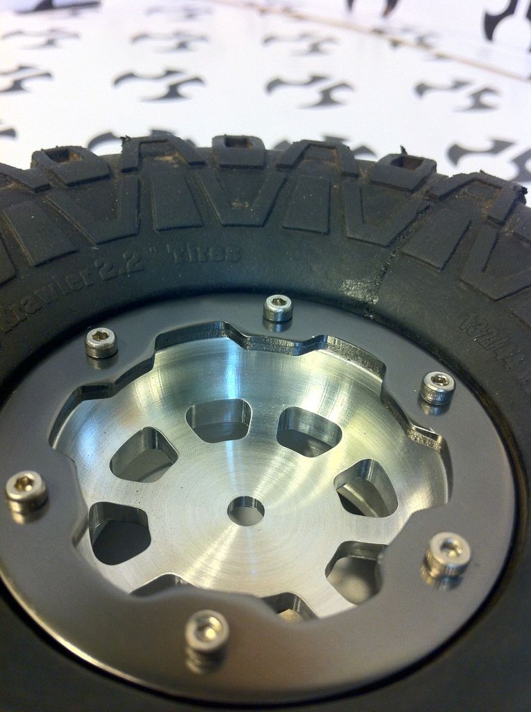

Mayhem Engineering 2.2 Monsters.
The machine finish is 6/10.
Assembly was 8/10.
Overall scale design is 9/10.
Price is 8/10 compared to available wheels
The 6 given to the machine finish is hopefully a fluke. I can see the tool path of the mill and one of the wheels was no fully machined. The slots milled into. The spokes are not full depth like the others. Also burrs around slots.
Availability seems to vary. Mine took 5 weeks.
They do keep an open line of communication and hooked me up with a "blem" for a spare, for the wait.
(custom rings)

nice review. the Versante is without a doubt the most unscale wheels ive ever produced. just a venture into something new that hadnt been done before. I got lucky and people responded well to it.
ive been told it looks like a Iroc wheel, but its actually based off of a 40 series wheel with 17mm hex i designed 5-6 years ago, but never could afford to produce. it actually looks more like a slash wheel to me:lmao:
so 8/10 scale aint to bad.
for future reviews maybe add a value category?
^ and done. And yeah they resemble a Iroc wheel but one that has been converted to a functional beadlock, which is cool. Real wheel with a real world mod
Get what you pay for. But that's also relevant to what we are talking about. VP has the highest quality but at a very high price compared to the rest of the market. And at the end of the day, these are toys. That said, if the right wheel is made, price has a little leeway.

I think these look very scale. My own personal opinion is I can't stand the look a bead lock ring because the size of the screws, it just throws off the scale look. To me, it would be like using 2" headed bolts on a 1:1 bead lock, that may be a little extreme, but you get the point.
I tend to use RC4WD stamped steel wheels more just to stay away from the huge rings.
This is very true, and about as scale as having big ass hardware bolting an adjustable hub to the wheel, and why it's nice to see the wheels running the small hardware and a regular hex. Get all the adjustment I need from different hexes and much smaller head than normal 3mm hardware.
I suggested VP keep their current design like the above pictured, but instead of putting dimples in the outer lip, machine it to look like a bead lock ring with tiny hardware. It's a WIN WIN. Get a functional bead lock with only 6 screws to mess with and über scale. Wether they do or not is up to them.
