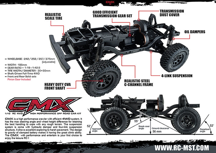

In simplest terms, CFX = front motor/transmission and CMX = mid motor/transmission
I have the CMX which is a centered trans like the OG SCX10. The CFX puts the motor and trans up front, but at the expense of being much higher.
CFX:
CMX:
I also find the MST CMX and CFX really enjoyable to drive now and again. The fit and finish and quality of their plastic is some of the best i've run across. The CFX planetary gearbox was a fun build, but if i had to pick one it would be the CMX as the CFX puts the motor a little too high for such a small lighter weight rig. But the CFX drivetrain is soo buttery smooth
