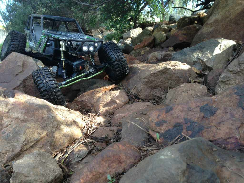

I've had my wraith for about a month now. I drive it a lot. It's usually full of power and runs great. :ror:
Lately it has lost all power after 2 minutes. I pick it up and it revs, but I put it on the ground and it is sluggish. :???:
It started smoking the 20T and 55T motors that I had. :x
I just put in a new 35T and it's starting to smoke that too. The motors get hot fast. Something is up. :evil:

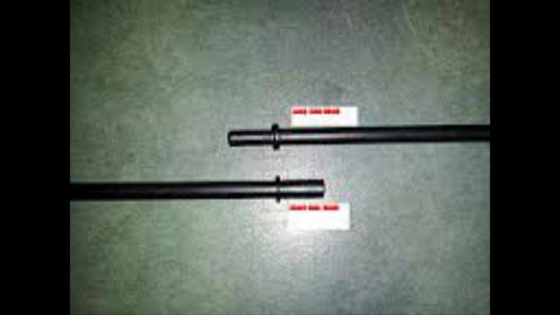

Check rear axle short shaft there is probs w that and post on here look it up I had that prob

The rear axle shaft had never been out. I've never cracked open the axles. I just opened it tonight and it didn't seem to have any trouble going back together.

The washer on the axle shaft that is by the locker should b razor thin if it is far enough that u can see the flat spot on the top it is the wrong shaft
Sent from my HTC One X using Tapatalk 2
Top one is the wrong one
I'm going with short shaft. I burnt up a few motors also. After drilling into the carrier a pinch, there hasn't been any issues...
