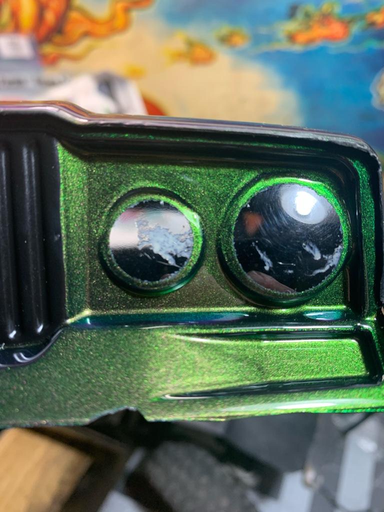

Hey guys, finished up spraying my new lexan cab for my rig. When I pulled the masks off. White axial window masks. I had some sticky residue left behind on two headlight lenses and one spot on the windshield. Anyone have a trick up their sleeves to remove it? Really don't want to mess up this paint job or my lenses. Thanks in advance for any help! It's greatly appreciated!!!
Try a piece of masking or duct tape. Stick it on and pull off repeatedly to try to pull off the crud.
Thank you again guys!!! The gorilla black duct tape did the trick!!! Now I can get the lenses smoked and start building light buckets. Can't wait to get this thing finished up!!! Super Stoked!!!
