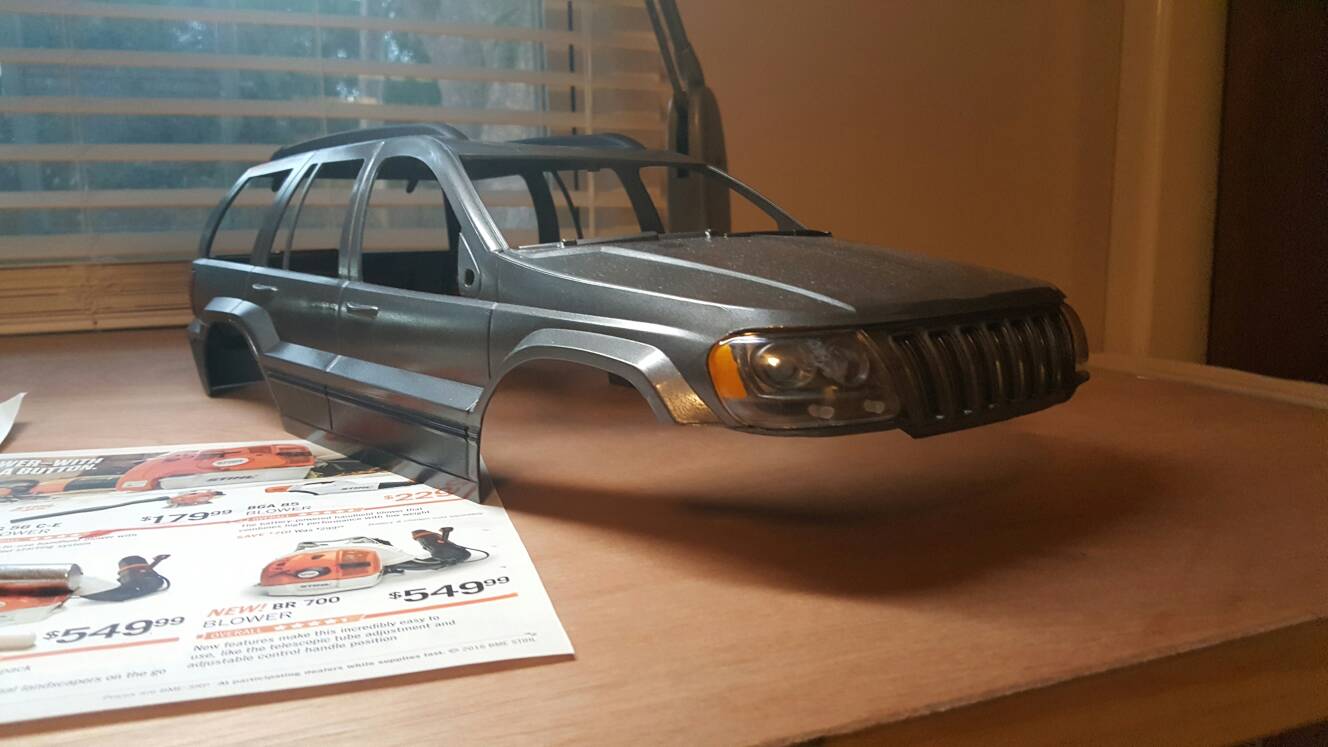

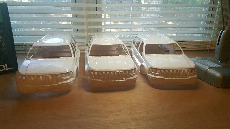

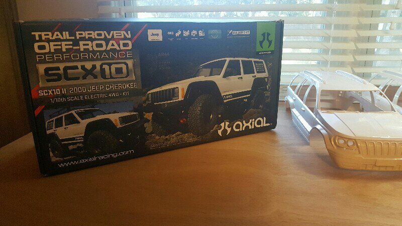

Finally got these bodies to the US
Gonna model it after this one
Here are the bodies.
I grabbed several as i can foresee a very limited supply of these
Got my scx2 a while back.

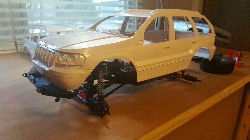

Mocked up on the chassis. Stocl bumpers need to be trimmed off the body to fit the JCR bumpers
Gonna use locked up for the wheels.
But i think im going to get some 2.2s to stretch over 1.9s to get the 17" look
More soon[emoji106]

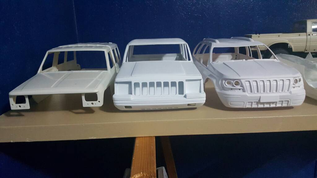

Heres a cool pic

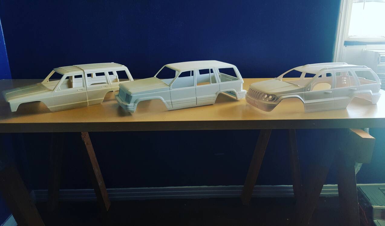

I now have a zj hardbody
Xj, zj, wj
All the solid axle cherokees.
More on the grand soon[emoji1]

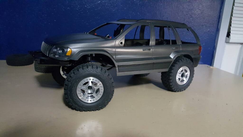

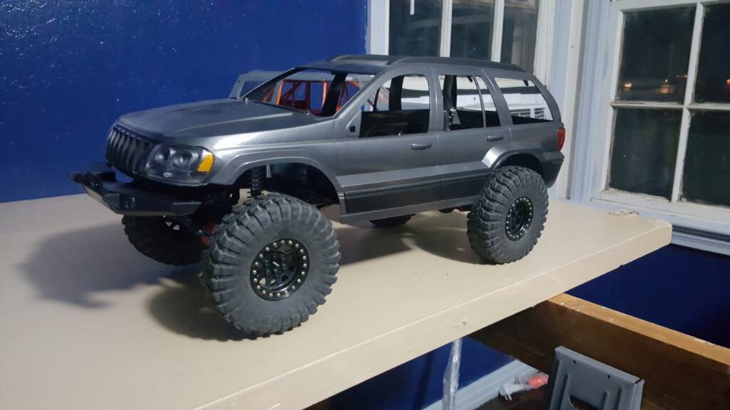

Well heres some pix you've been waiting for!
The first mock up!!
Next to the OR fab xj
Still have not gotten the 2.2s but decided to throw on some ssds to see what itd look like...
I. Love. This. Jeep.
Might have to get a new bumper, the scx2 one does not fit as well as i thought

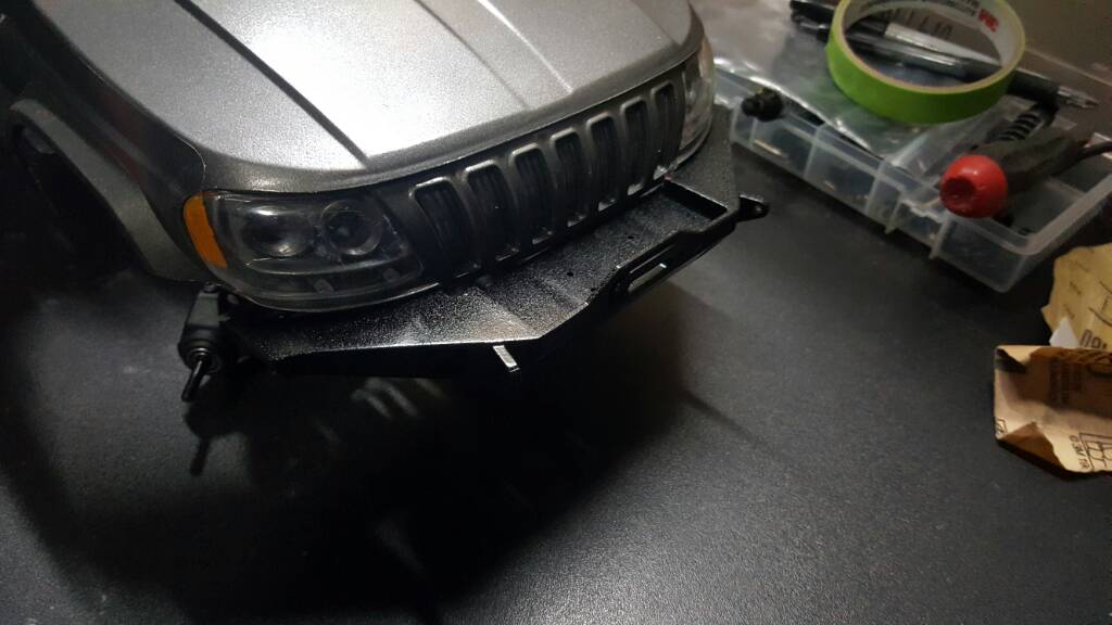

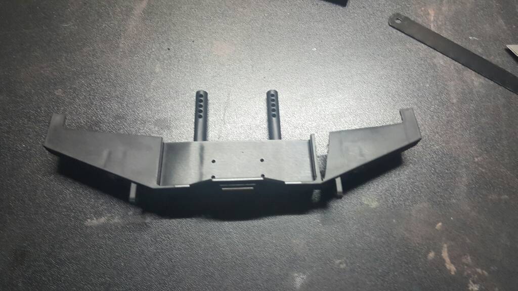

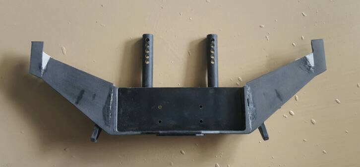

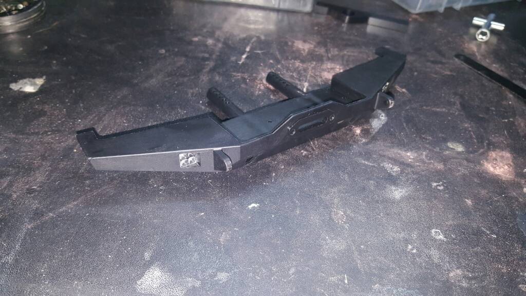

So i decided to get the bumper situation figured out
I really like the scx2 bumper because it is the same style as the one im going for
The bumper hugs the grill and headlights very tight on the wj version
But the angles are not correct on the scx2 bumper

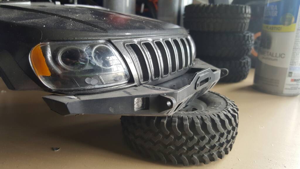

So! Naturally; I decided to modify the stock one.
I started with this
Then made some cuts to fold in the bumper sides to the correct angle
Here they are folded in and welded shut
I did the same to the ends to bring them out, and filled in the gap with some styrene so it will retain its strength
NOW it hugs the grill nicely[emoji106]
(Excuse the dirty headlights) lol
Finished with some spray on bedliner to get rid of that plastic look
Im happy with it
Sent from my SM-G920T using Tapatalk

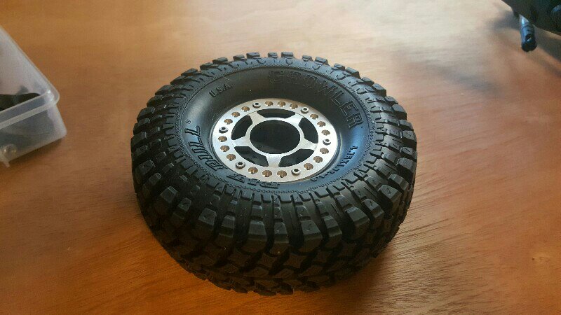

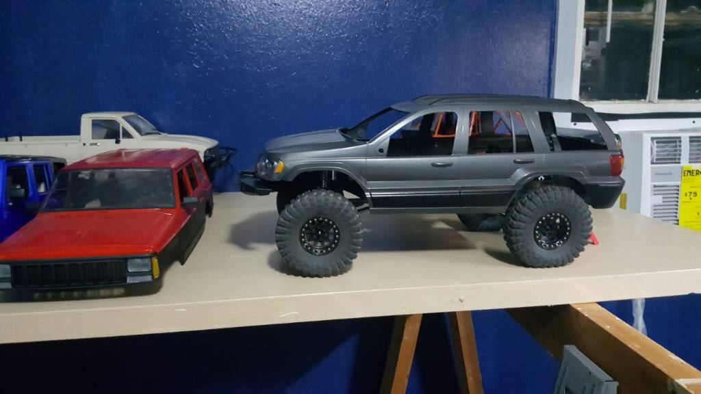

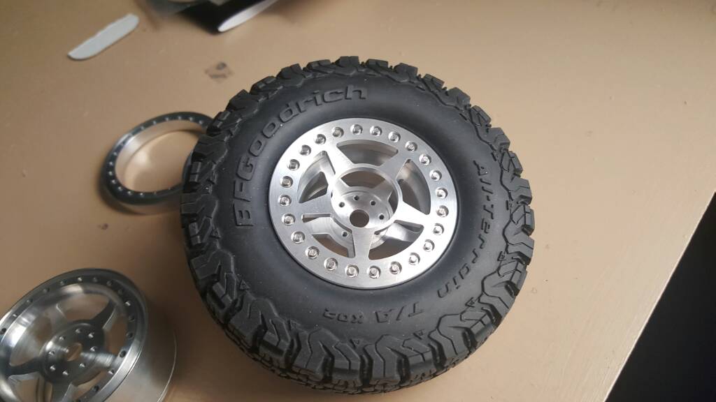

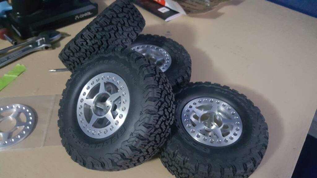

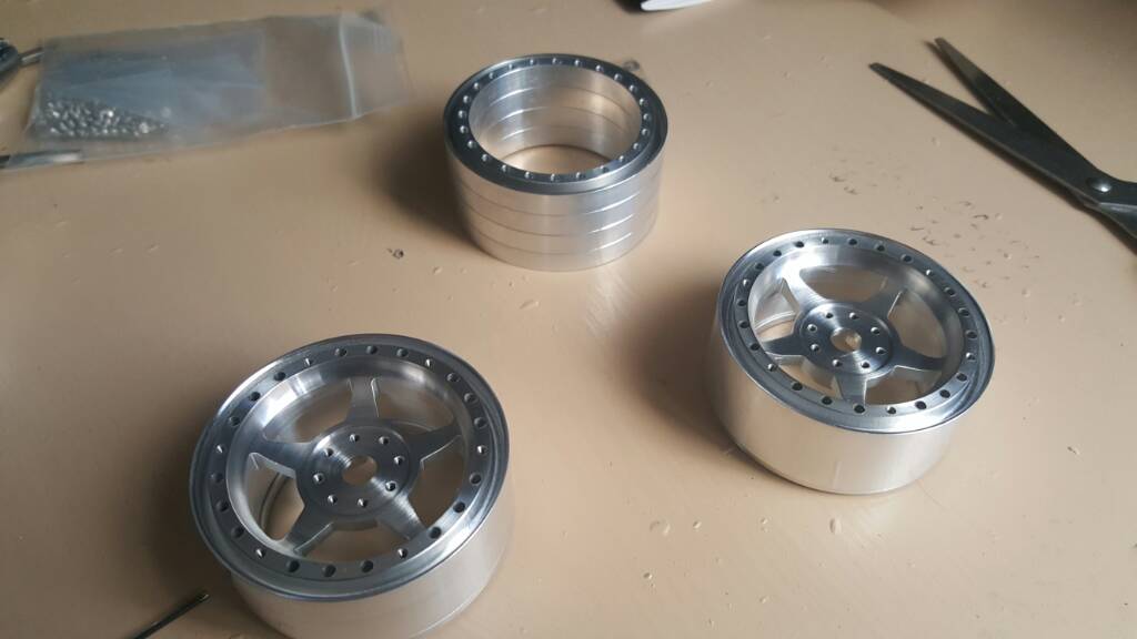

2.2s are in!!
Beadlocks and one widener for each wheel
1.9 stretched on these 2.2s
I really dig the look of the wheels...
However i think i need a skinnier tire, and probably a few mm shorter.
I will have to look around...
Any suggestions?

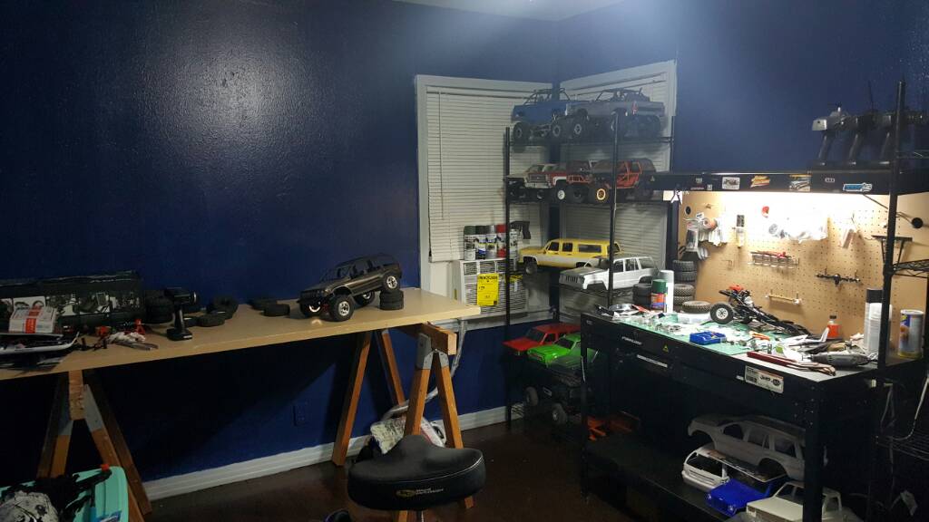

My new shop is coming together [emoji106]
