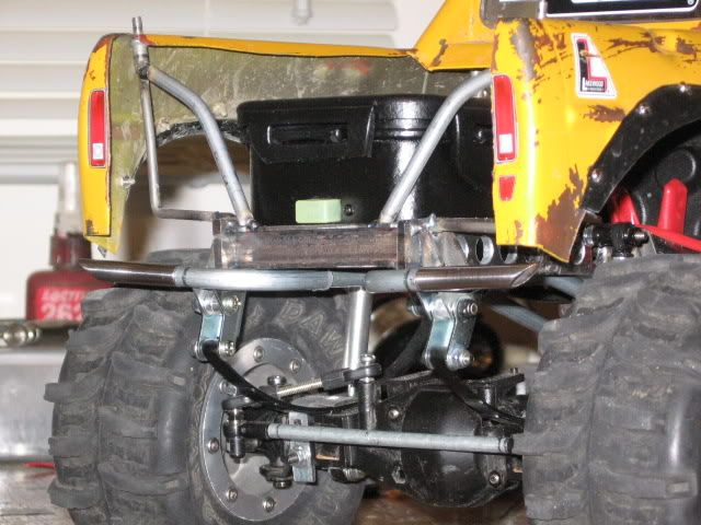

talking about scale like towing points. I built some removeable cleveses for my land cruiser using 1/8 steel rod, 1/8 key stock, and 3/16 brake line. I formed the 1/8th inch rod around a 3/16th rod to get the shape of the cleves first. Then flatend the ends where the pin fits through.I then drilled a 1/16th hole through the two flat spots. A corisponding hole is then drilled in the 1/8 key stock and a 1/16 piece of wire holds the cleves and the key stock together.
Then for the reciever mount I pressed another piece of key stock into the brakeline and hammered and dollied the line untill the key stock fit in and out easy. Then its just a matter of putting the cleves mount in the reciever and drilling a hole for a pin to hold it!
This isn't the greatest pic but its the best I have of it

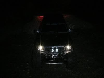

picked these up at the grocery store, buy 8 Duracell AA's get a free single-cell flashlight. buy two packs and you've got free headlights. takes a little bit of wiring to make 'em work, but the price is right
