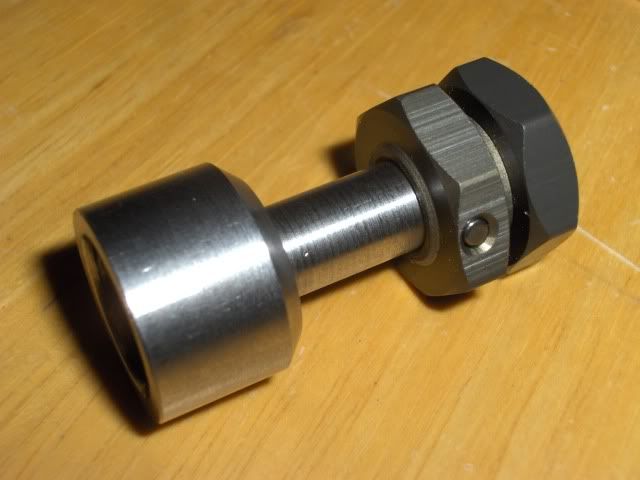

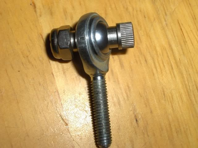

Ill have to go over to ace and get a couple, I didn't even think about that but that would look way better :mrgreen:. The only problem I can see is that you would have to use lock tight to keep it from rattling out.

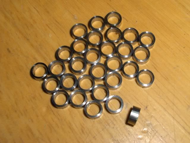

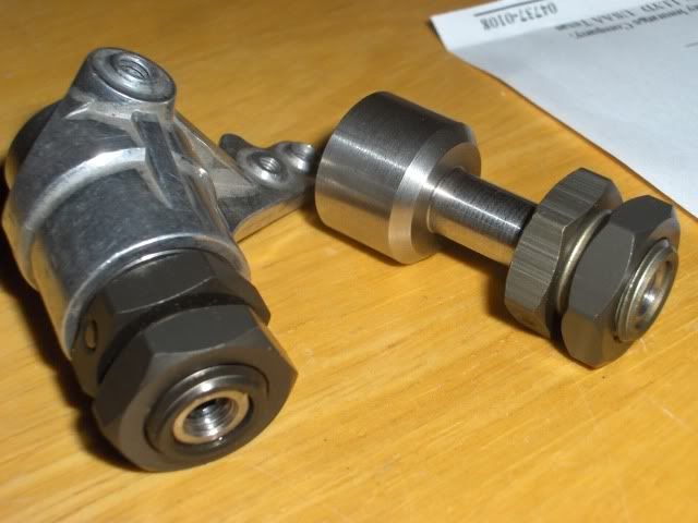

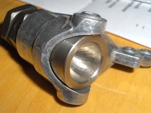

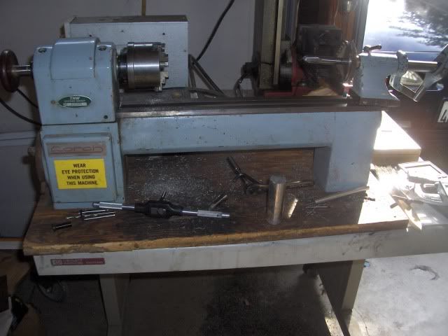

These are fresh off the lathe, they'll help these heims get a little more angle. They are made from 1/4" stainless tube.
The Axles look bad A$$ and I like the button head it's more low pro. I see we are neighbors!

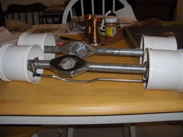

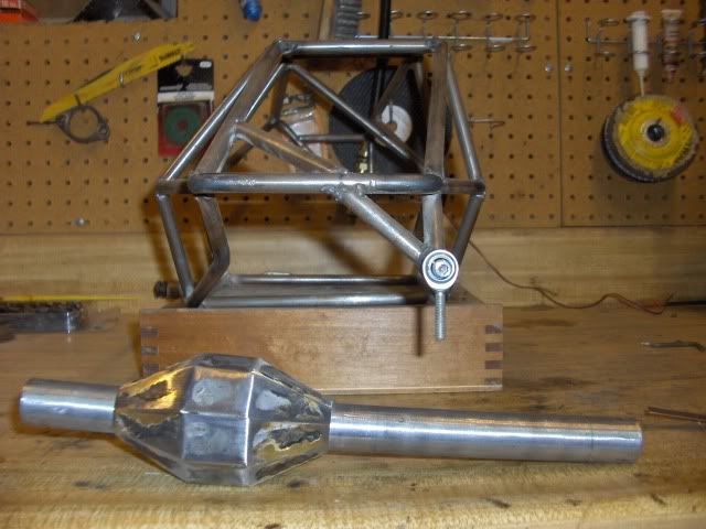

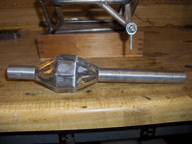

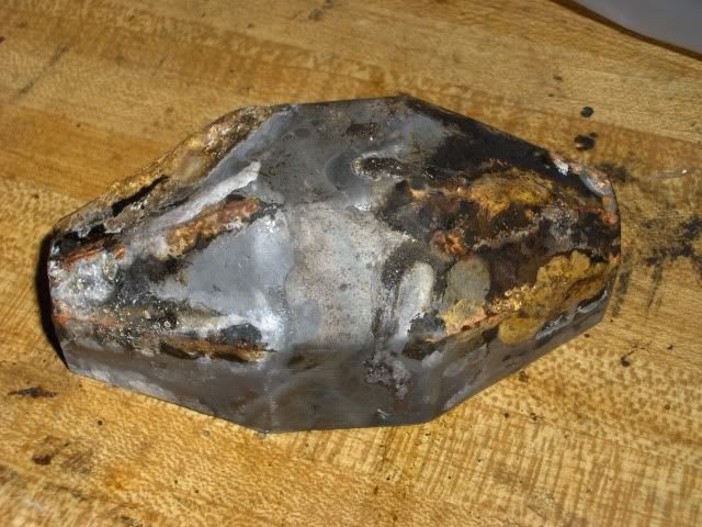

I got a little done one the front axle. I got the diff cover cut and brazed and I also finished the outdrives for the cvd's, except for the hole for the cv pin.
and here is the mess and what I made it on :mrgreen:

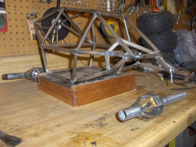

supercrawlerfreak: Nice build dudeman, everything from the axle fab to chassis fab is bar-none, you should be proud of this beast! Just a little constructive criticism though: GET THIS THING DONE, I MUST LIVE VICARIOUSLY THROUGH YOU AND THIS BUILD!!

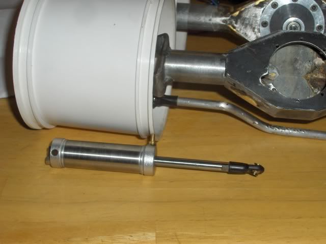

I got a little more done on the front axle today, I have to wait till friday to get another set of gears for the front so I can finish it. the last pic is the ram I will be using for the steering.
