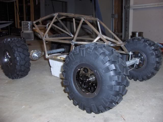

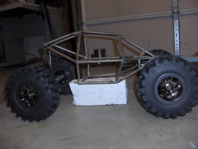

I borrowed JJR's tires to see what it will look like. I cant wait to beat the hell out of this thing. :twisted:

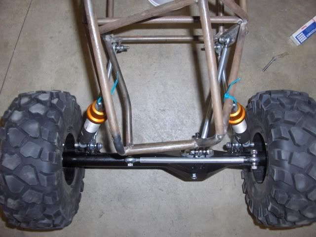

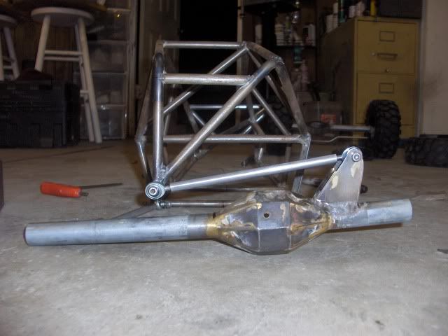

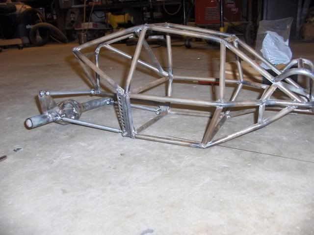

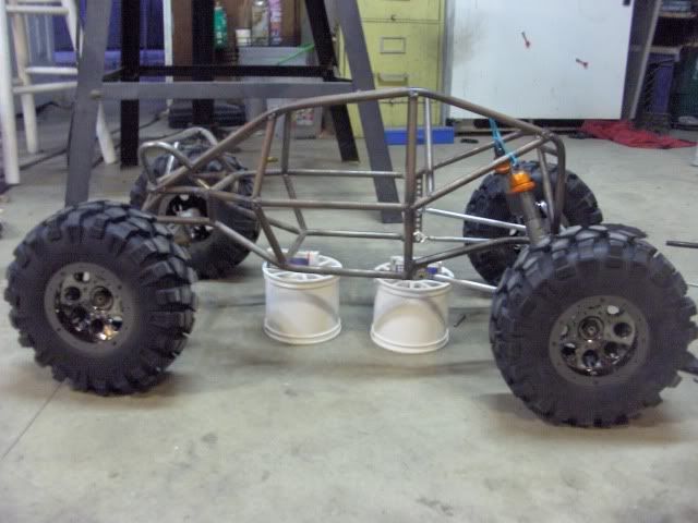

I got most of the cage work done along with all the rear link mounts. I started gettin all the link mounts on the axle done and I ran out of wire:evil: so that will have to get finished this weekend. Enjoy "thumbsup"

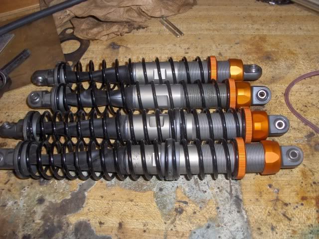

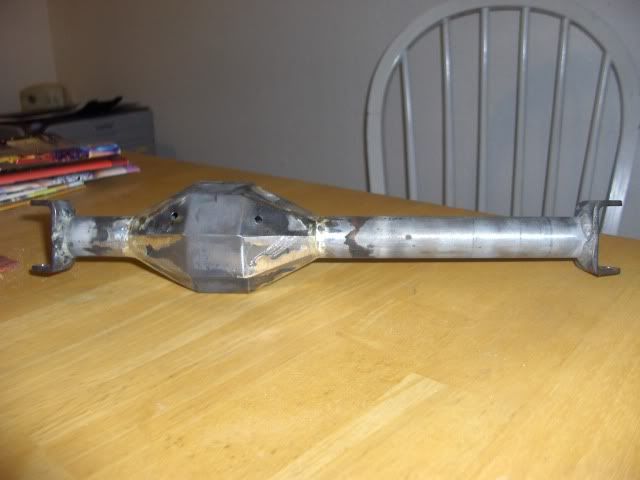

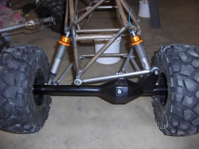

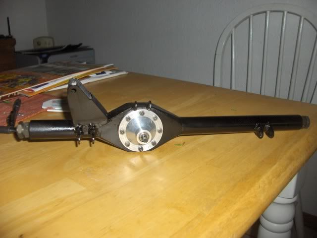

The rear axle is completely finished and the rear suspension is done minus the upper shock mounts. I need to get some wideners for the rig eventually, looks too skinny to me.

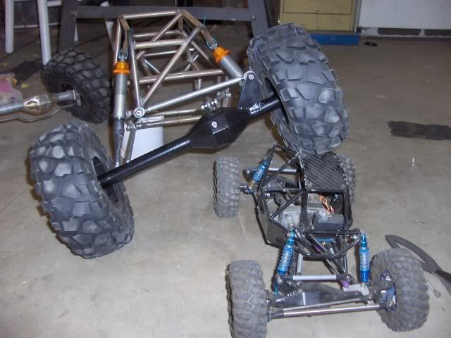

this thing is friggin huge:twisted:
I can't wait to see what it will look like when it's finished. It always bothers me when these buggies don't have the right proportions from the tires to the frame or WB or axle width but I think you're pretty close on that. I like the axles when they wernt painted too, lol.
How did you bend the 3/8 rod, use heat at all? Is it cold-rolled rod?
