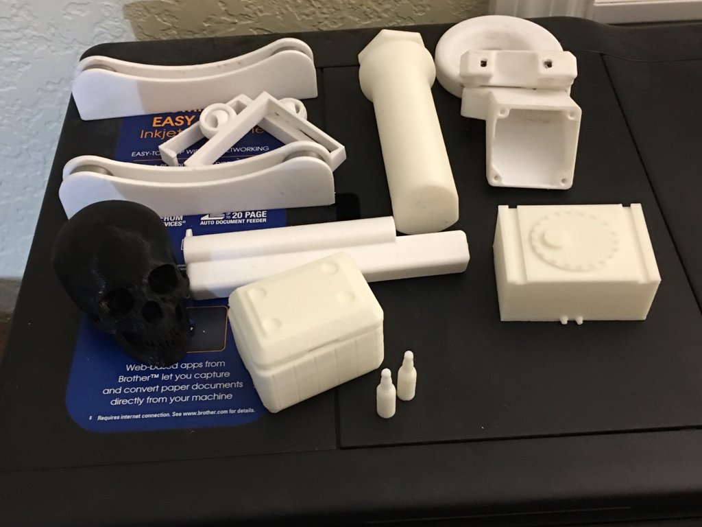

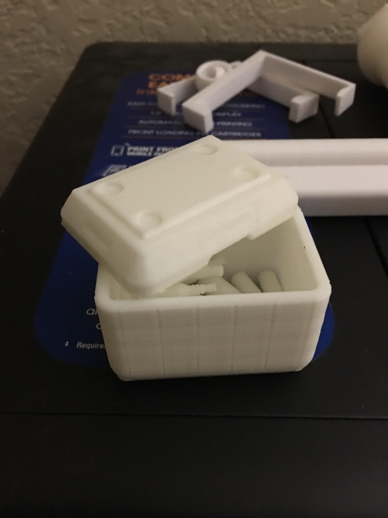

Did you do those or are they available for download? That cooler looks better ten mine. Ha Ha
Thanks, I’m getting there. The Coleman cooler and bottles are straight from thingaverse.

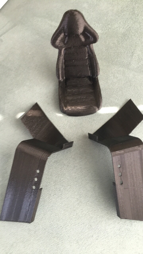

Long week of testing. Back to 210@50 I did calibrate the extruder and it was overextruding, but that was my stringing issue, and now all retraction is spot on. Last set of inner fenders turned out crisp, clean and strong. Seat is scaled up 1000%, worked out well.

Have been specifically looking for the inner fender files, where did you find them? What search for?
