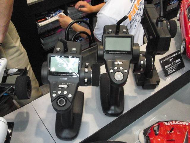

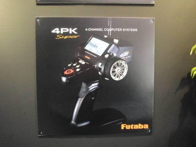

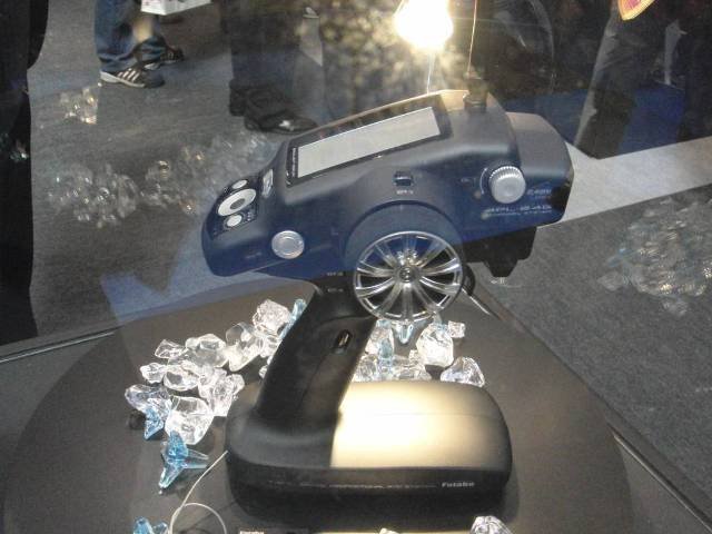

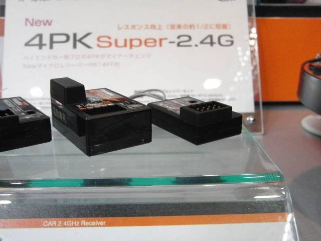

checkthis out - i just saw this on another site ..the 4PKS
I am posting the new info on this ASAP 8)
so wow this is the radio everyone is spending $400 on? what makes it so much better?
If you go to the first post of this thread I have links to programming of just about any setup you need. I also have video demo's showing the programming. For MOA crawlers there is no better option for ease of use and simplicity of design.
There is a reason it is plastered at the top of every podium 8)

Harley was just disappointed that its being called the 4PK Super. He requested it to be called the 4PK "Awesome." LOL

Sweet, smaller rx's! I hope the 4pks isn't that much better than the current model cause I don't want to buy another one :ror:
