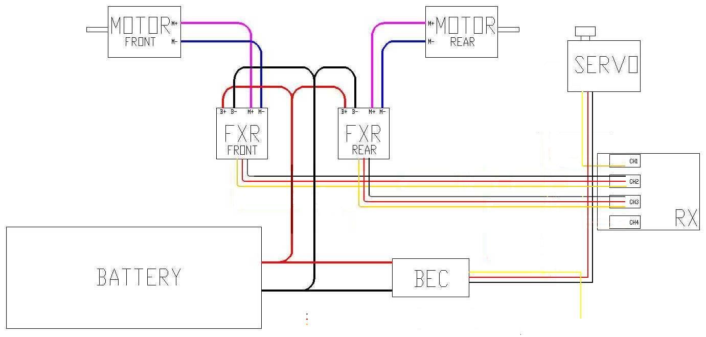

Harley, this is my wiring diagram, can you tell me if it is ok?
because i have 2 battery, one linked to esc with one motor, other battery linked to bec and to other esc splitting red and black wire from battery..and both red esc wire that go to receiver cutted..
do you understand, a diagrame would be better ehehe
I do not recommend two batteries. I suggest running the setup as I show. I will not be available to do a diagram anytime soon.
why did you reccommend me one battery instead of 2 battery?
one battery is better to operate current, to operate escs?
now i have 2x tp 850 3s 45c, can i use them or with only battery i have to move to higher amperage such 1300 mhp or higher?
ok Harley, this evening my friend and i weld the electronic as you you suggest me by the diagram with only battery and then i start to set up my 4pk..
