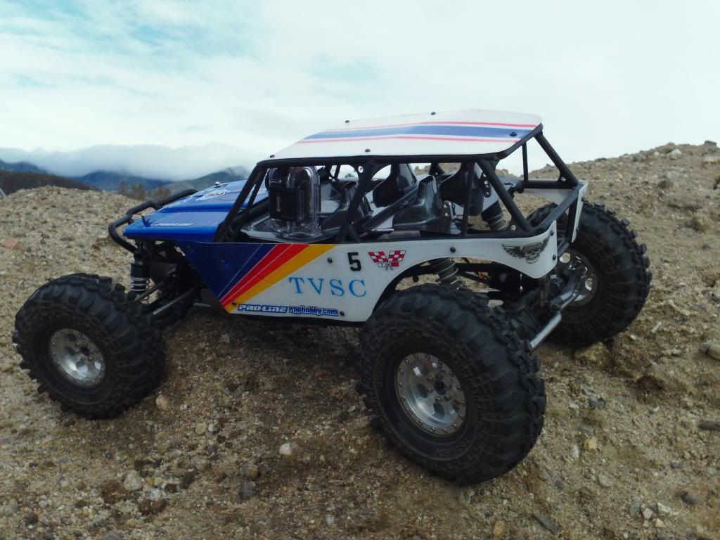

Thanks for the kind words, Steelfish. This rig is coming together but after driving it a little today I can say it has a little ways to go.
My current status:
I traded for some tires today that I'm going to glue onto SC wheels.
I've got some beef tubes ordered for the rear axle. Those should hold the C-hubs better (they're already loose).
I put on a stronger rear servo (Hitec 7955tg) and I think that should do the trick out back.
I was reading another thread and realized I didn't install spacers between the top plate and the exo diff case. Blue Monkey is shipping out a bracket to move the bell cranks forward, too.
I got some softer springs for my Proline shocks. I want to try out some other spring rates and lightweight oil.
Found some silly putty at Target. Thanks, Erin. "thumbsup"

I made it to the first round of the U4RC winter series today, and survived! I didn't get a chance to practice before the first heat but by the end I had a good feel for the new ride.
I did end up using 4ws to compensate for the poor exo steering radius. I used full time 4ws with the rear set at only 20%. It was pretty easy to control this way. I also used silly putty in the front diff and this worked perfectly. Thanks, Erin!
In the first heat I used a 2 cell battery and too heavy shock oil and too stiff springs. For the last chance qualifier I used a 3s and tuned my shocks a little better. This must have worked because I was first in the LCQ and moved on to the main. I could not get a good rhythm in the main but at least I finished without breaking anything.
