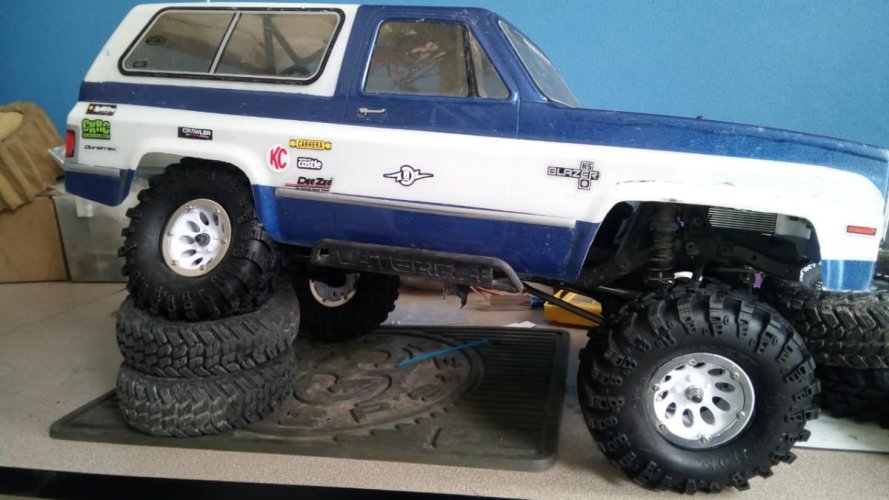

So every 4 months I post one of the few upgrades to my ascender, I haven't even got to installing the sway bar :roll:, but I did manage to finally try out the duratrax scaler tires, I really like these, I went with the Chinese knock offs and duratrax tires with stock foams (imho the only thing these tires need are good foams and you have a contender), anyways a couple of pics.8)
That's just a Velcro strap.
LOL ...i did the same thing...took me like 5 minutes to figure out it wasn't a piece of molded plastic...looked like a plastic box to me for some reason :lmao:

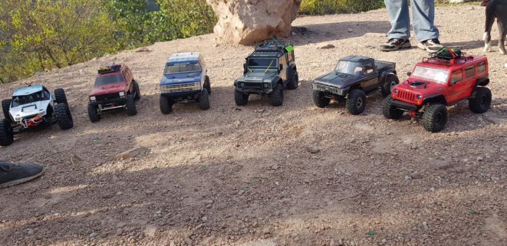

Another outing and the vaterra was great, my trx4 on the other hand driven by my son had a motor death, the traxxas titan had been through a lot of mud and water, so r.i.p. ... time for a holmes motor:mrgreen:

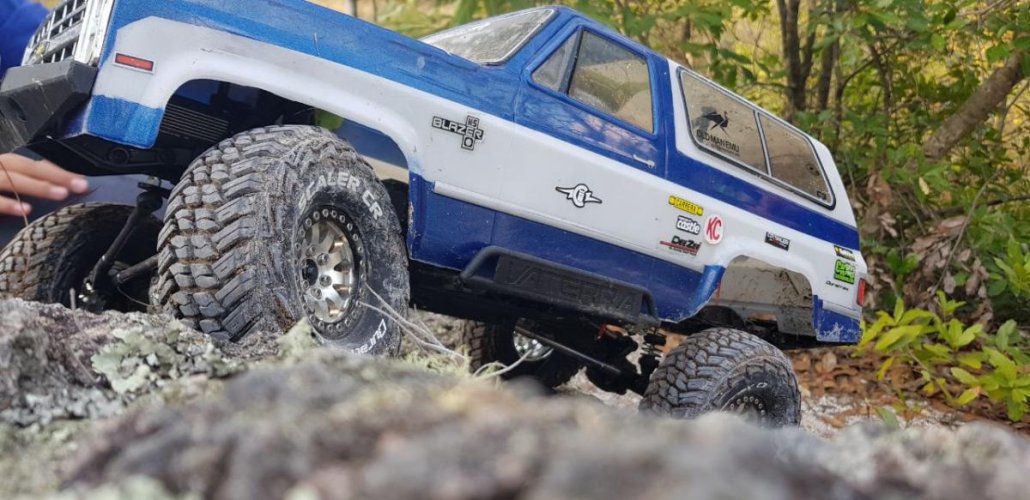

Another outing yesterday, i am having trouble with the 2 speed not staying in gear, i have tried all the adjustments possible and it feels like eratic behavior from hte servo, sometimes it will fully engage and other times it won't, shift linkage is smooth, i am even debating on going back to the single speed tranny...

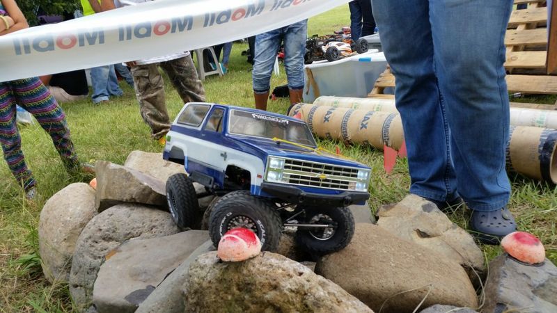

So i have no good news, scored a dnf in the comp, went class 2 , tires had grip, but the lack of practice and the boldness of going into a comp with an untried setup took it's toll, the wheels are some cheap plastic i had laying around and had no air holes, so although the tire had a nice grip they were bouncing all over, that added to a th spur gear and a 20t pinion plus a 3s killed the driveshafts...
Untested truck setup, OG driveshafts (not the update heavy duty) , geared too high for good crawling can do that. Vent tires, not wheels, is better imo. Tires look good on there and looks like you had fun! :)
