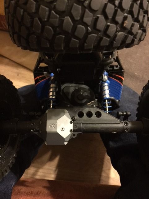

Went to put my VP diff cover off my yeti on, and the ring gear is on the opposite side.. Anyone else notice this or know why?
