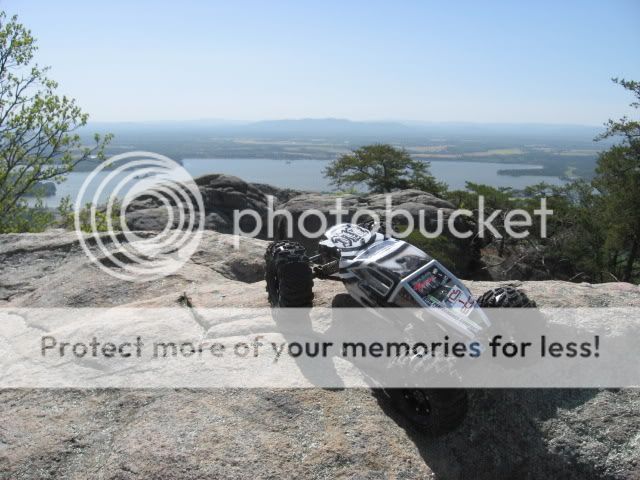

Managed to pull of an 82nd at ECC..Courses were brutal,had some issues that cut me short on time finishing a couple courses or I would have placed a bit better.Oh well...I had fun!! If anyone has pics of my rig on course please post them!!

Well I made some small changes to the rig after getting back from ECC..First thing,I changed out the axial comp shocks for Losi shocks,the losi shocks just perform more consistently in my opinion..I used 50wt in the fronts and 40wt in the rears,both with stock valving.Second I removed the 5oz's I had in each rear wheel which lightened the rig dramatically and improoved forward traction.Performs alot better now on vertical climbs,and suspension action is way more predictable.All around night a day difference.
