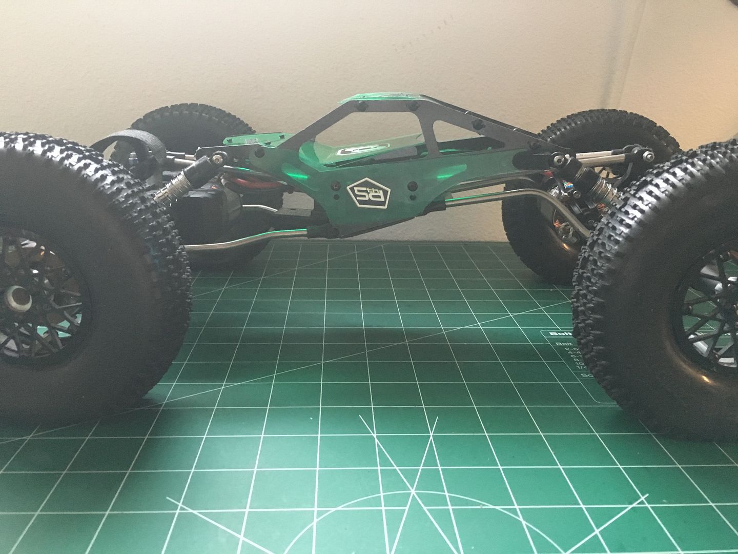

Swapped in the new updated chassis with new CF braces keyed into the chassis. Also running a new setup thanks to Snatch. Skid is moved up in the rear and upper links moved up one hole, also moved the rear shocks back one hole so they aren't layed down as much. You may also see our new "Bandit" wheels that we will be releasing along with the "24 spoke" that was on it previously. We've been running them for awhile now without any issues. This rig is really performing good! Sorry for the bad pic...
