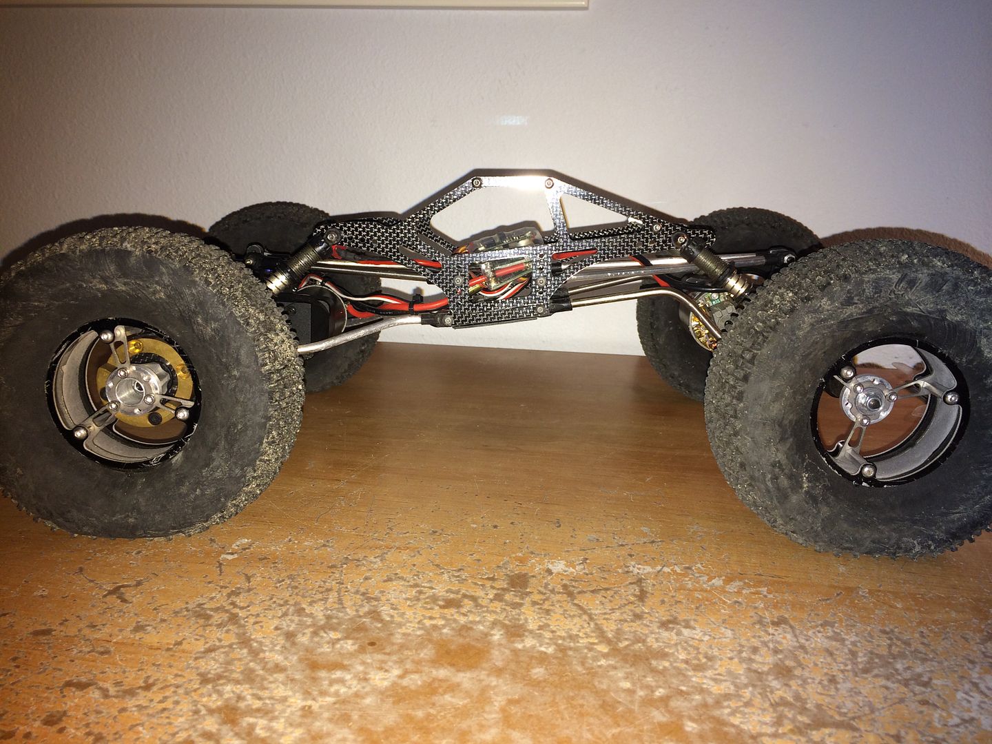

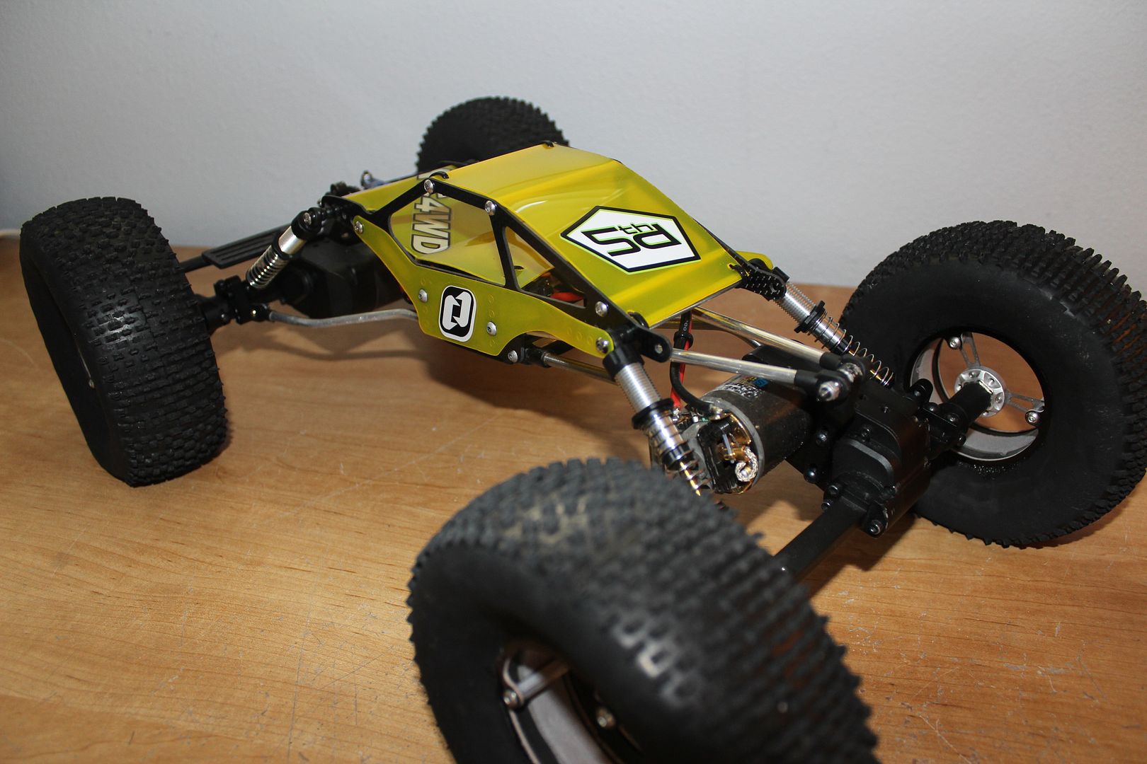

I don't think I ever posted pics of what this car looks like without the tires on it so you can get an idea of my link set up. Ride height at the front of the skid with Boss Claws on it is at 2.5"
I love that aggressive stance. :twisted:
After you clocked the front axles did you add any positive caster on them or are they centered? It is hard for me to tell in the pictures.
The knuckles are clocked back one spot from full, about 15-20*.

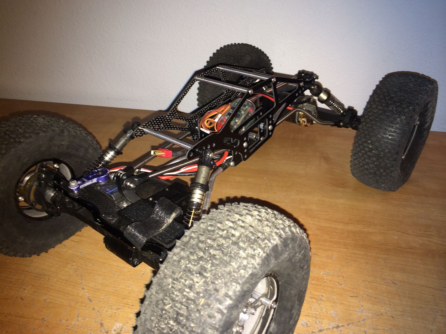

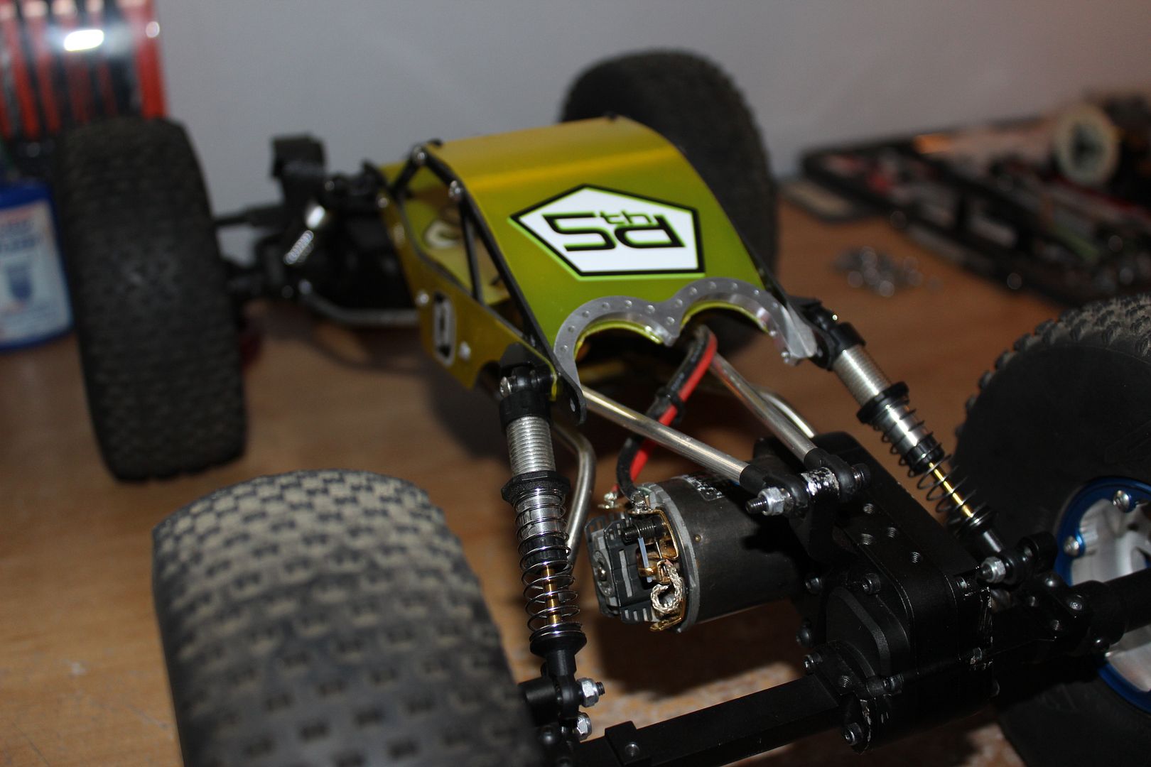

Update time, I got my 5th Dimension Dominator chassis in the mail today so I did a quick chassis change. The links transferred over fine since we didn't change the skid between this chassis and the bodied version. I also got some Icon shocks to go on this one. More to come later in the week during my days off when I got more time to finish this up.

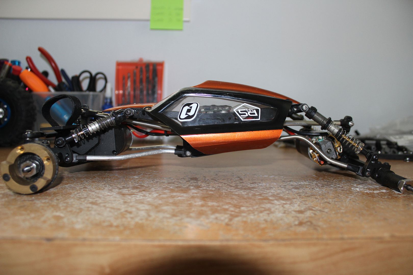

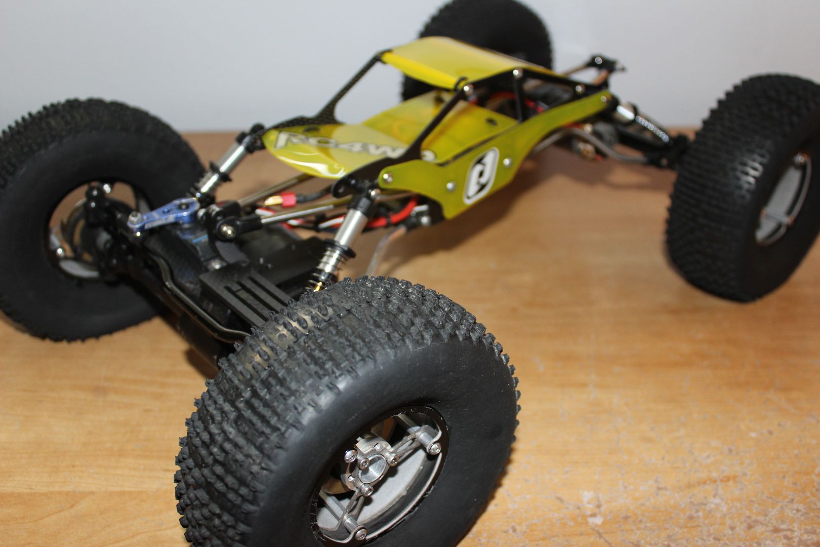

Icon shocks are on, running 30wt front and 35wt rear with mini-t silver springs and a plastic Axial rod end ball inside the shock for limiting. Painted some panels translucent yellow, now its time to add the stickers.

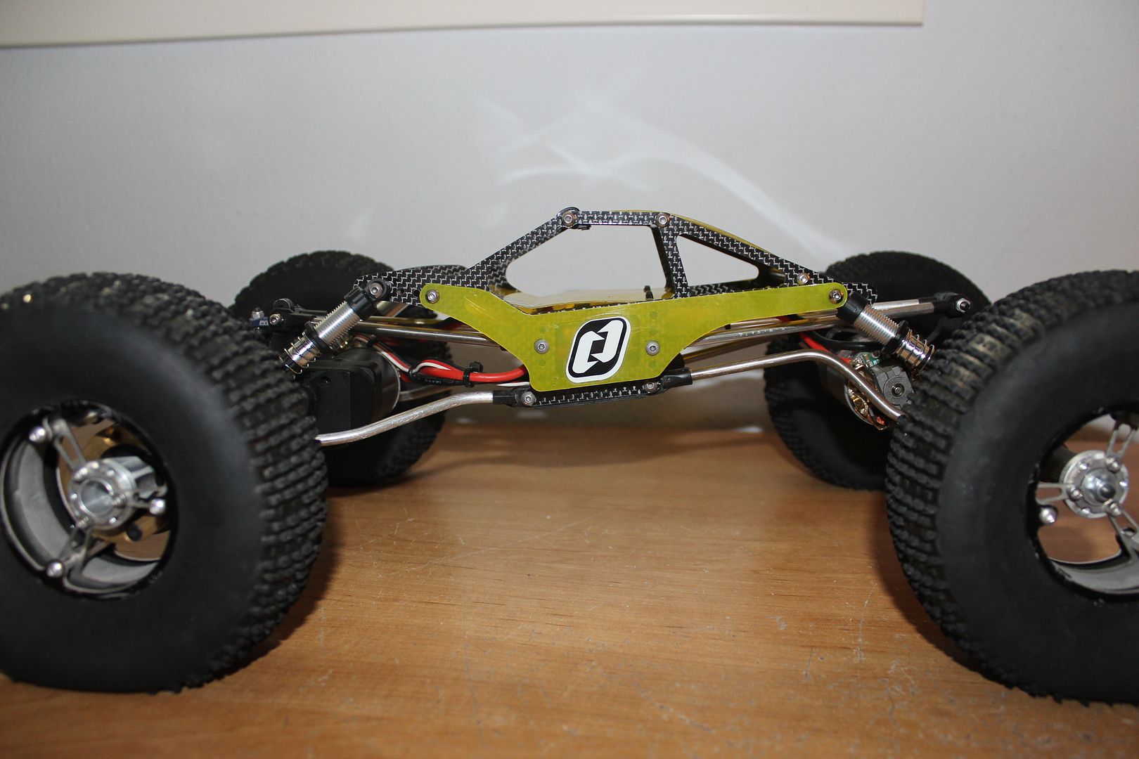

I've had a few people asking what my link lengths are so here you go.
Front lowers: 118mm eye to eye
Front uppers: 118mm eye to eye
Rear lowers: 131mm eye to eye
Rear uppers: 133mm eye to eye

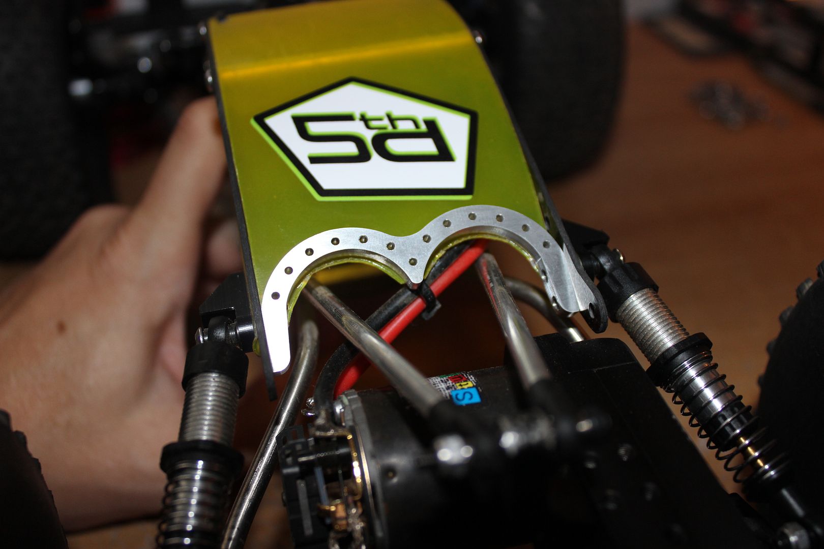

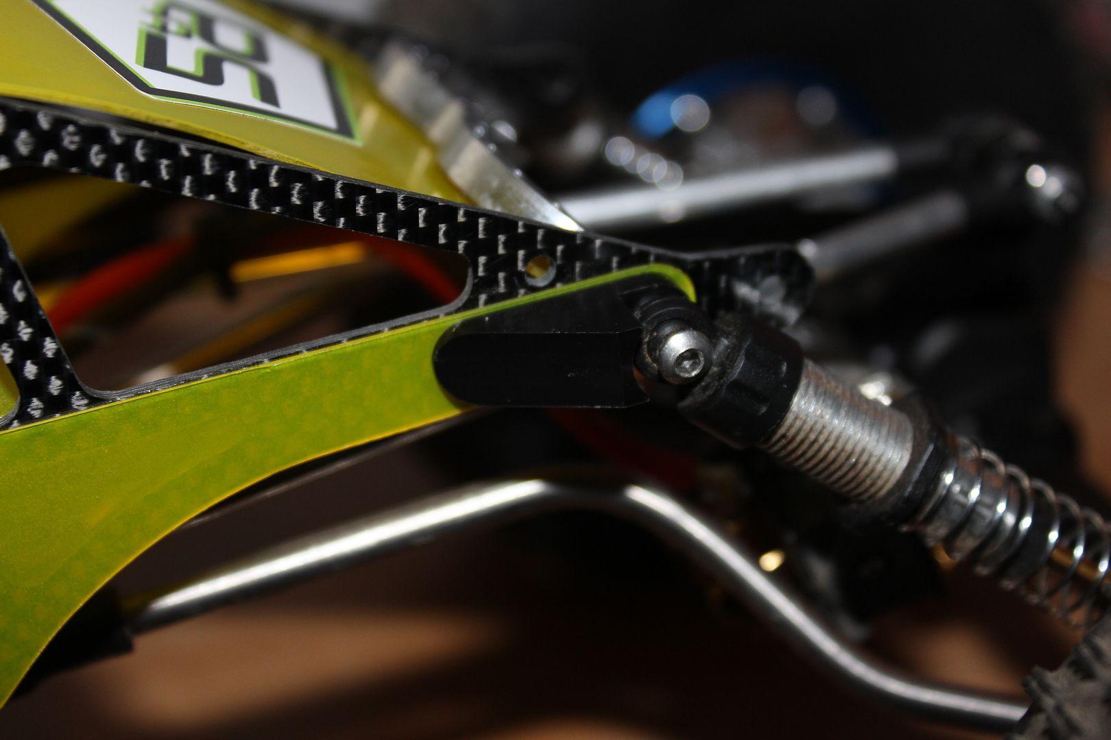

Thanks to Bruce at BDN I got my custom 2.5" BB brace and shock sliders in and installed on the 5th Dimension Dominator chassis. I absolutely love this rear brace and the machine work is outstanding. Thanks Bruce for getting this done!"thumbsup"
