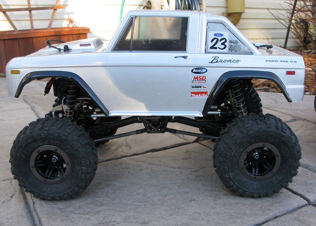

Ya I like your set up, if I have room on my rear upper link mount I'll probably run something like that. On another note were did you get those shock mounts or is that what comes with a crawler king?
Shock mounts came with the Crawler King conversion set/kit. I made a new link and moved it to the other side of the 4 link mount (still going to the left rear wheel). It was in the way of the shock mounting holes if I want to lower the chassis. Still works fine.
I'm going to have to get some mounts like that,I just flipped the stock wk ones so I'm limited to two mounting positions. also what tires are those I'm looking to ditch my slash tires, I need something a little bigger to match the longer wheelbase.
