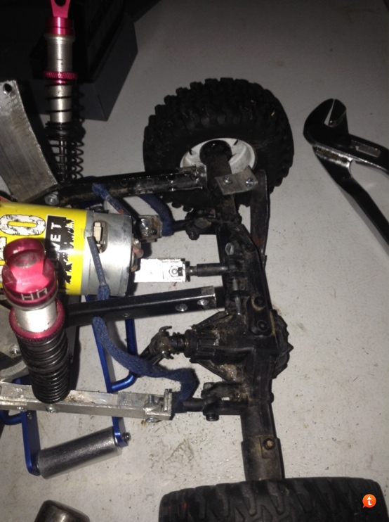

I also decided to change the frame a little bit
also got the rear plat drilled some holes and mounted it
I did this to enable the axle to go higher into the chassis.
Gained about an inch of up travel almost.
Also did a little servo mod to ad some steering.
just made it longer. I'll post more pictures when I get the transmission in.

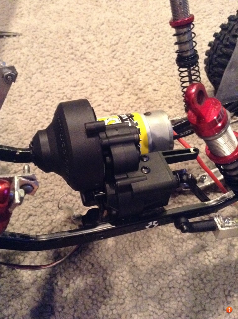

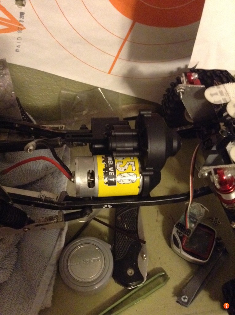

Here is some what of an update I got my transmission in.
decided to put it in the regular mounting spot (wich I moved back in order to make a straighter line for the driveshaft.
I will have to figure out a different way for the electronics. But it looks clean.
it has the 80 tooth spur it came with still looking for a new one. I was looking at the venom and the wraith trans. And it took about one full turn on the spur to spin the output shaft once. It took the venom like three full spins of the spur gear. So the motor will be faster with the wraith. Can't wait to drive her. Have to shorten the droop strap on the left side by the drive shaft it's binding to much from the droop. Then I'll be good to go. Enjoy y'all.

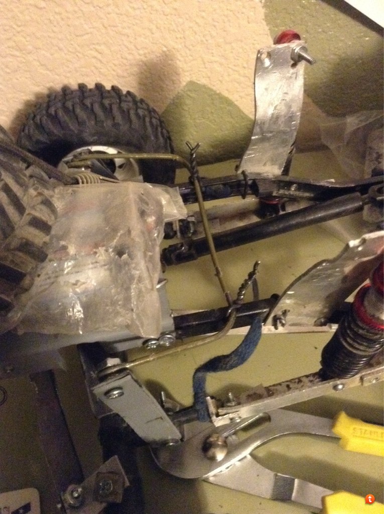

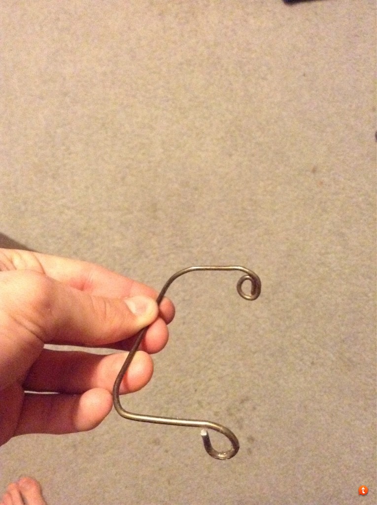

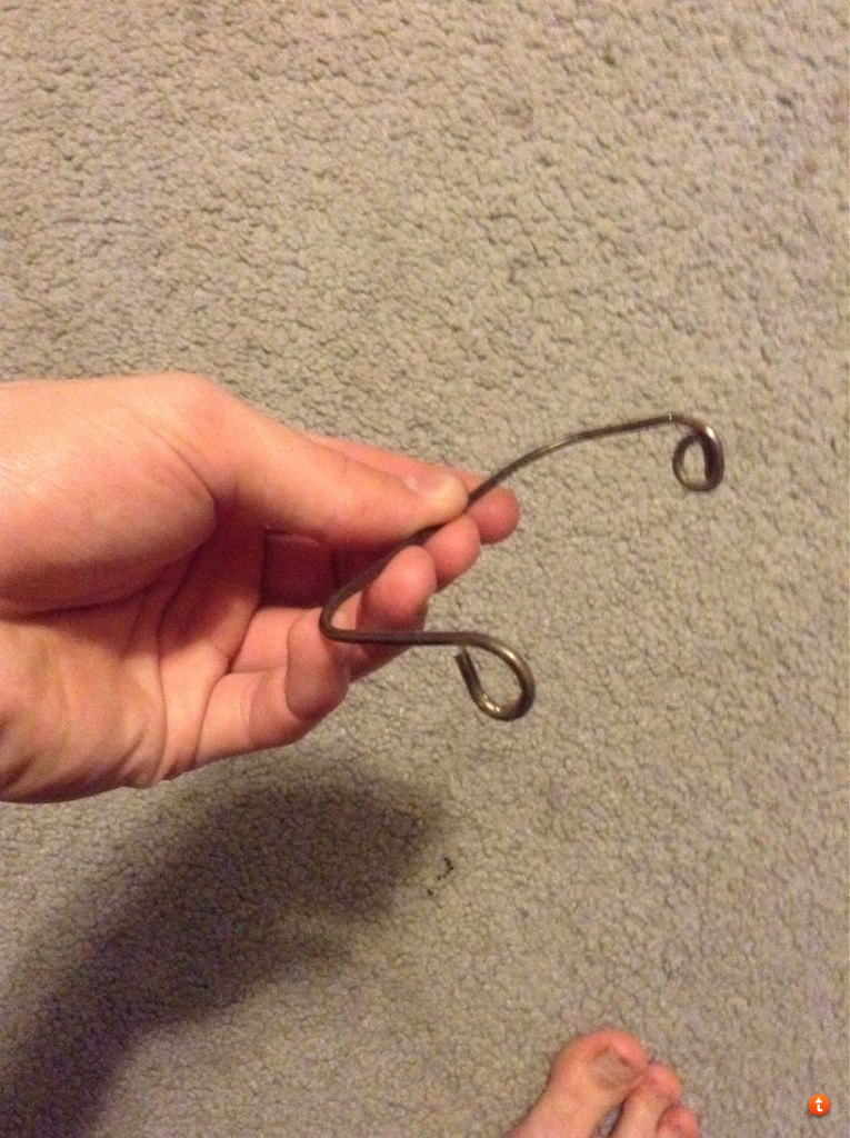

Hey guys little update. Still waiting for the new 49 tooth spur gear. But I drove it a bit the other day worked pretty good front end is right as I want it. But still figuring out the rear suspension. But I am a bad driver my front skid plate was pretty bent up. But she worked good. Anyways back to the update. It rolled to easy around corners. So I made a sway bar. I have a couple coat hangers laying around. Made a couple put the medium thick one in yo start we will see how it works.

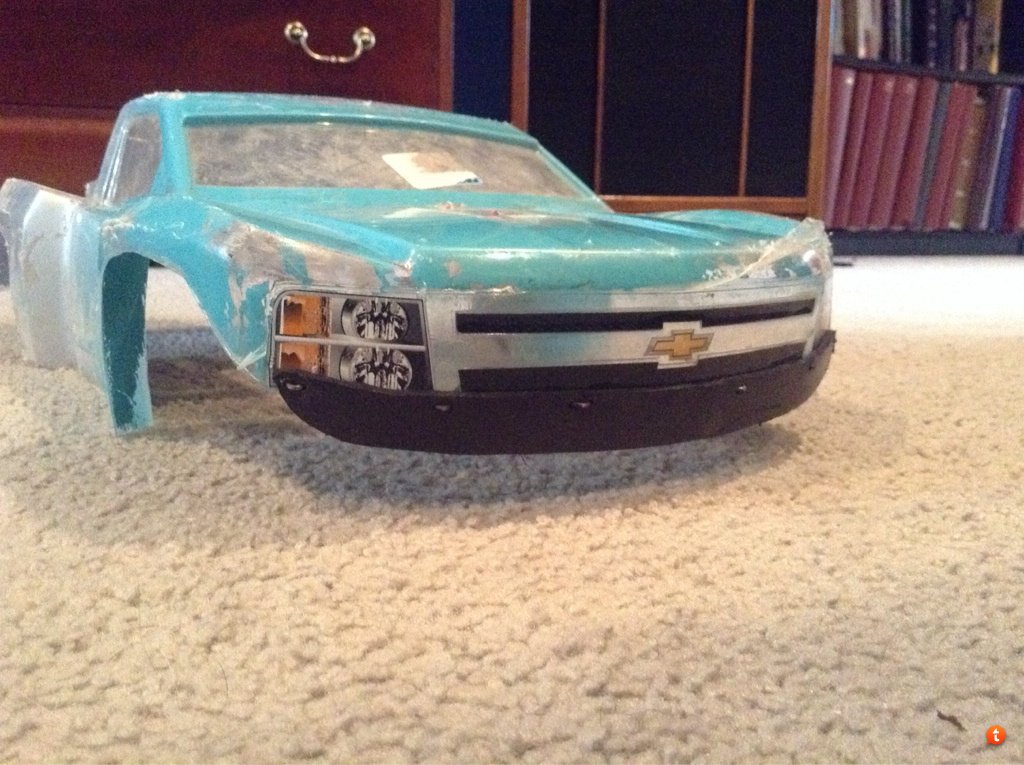

So I made a custom valance for my trophy truck. The sway bar really helped. My gear should be here soon. Hopefully! But for now you can see the valance.

Put some real links on it and lower your shock mounts. I doubt that your wire coat hanger sway bar is doing a lot.
Why do you think that putting "real links are gonna change anything?" Sway bar actually works great. And how is lowering the shock towers gonna do anything but push the axle down more?
The links won't change anything with the suspension, it'll just make it look nicer.
The swaybar is probably too stiff to make the suspension cycle properly. As far as what you're asking, it's very confusing. As you accelerate the back should squat not lift up. Sounds like you have some major torque twist going on.
