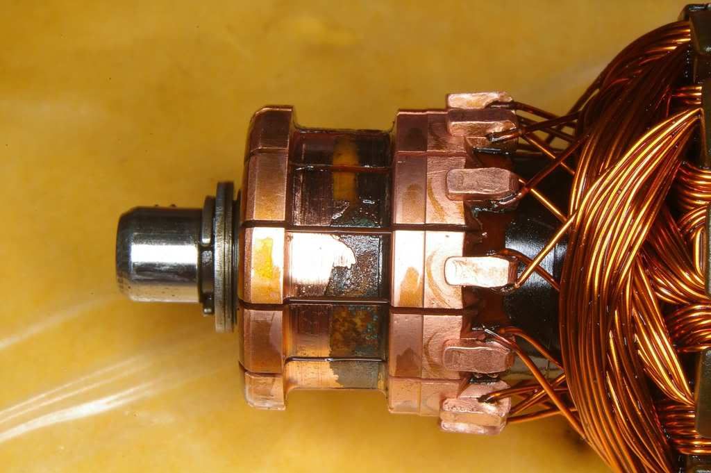

Got my lathe last week, an Integy/Xipp 3 lathe. I needed to turn down a threashed mag mayhem 550 arm which would not fit on the lathe out of the box so I made it fit.
Stock Plate
After Machining
Fits now. Cut 1
Cut 2
Cut 3
Cut 4
Cut 5
Cut 6
Cut 7
Cut 8
Finished
Comm was in bad shape and I took light cuts. Out of the box the lathe cut a .001" taper. After I stoned the knick off the one way and tightened the gib screws up it cut true.

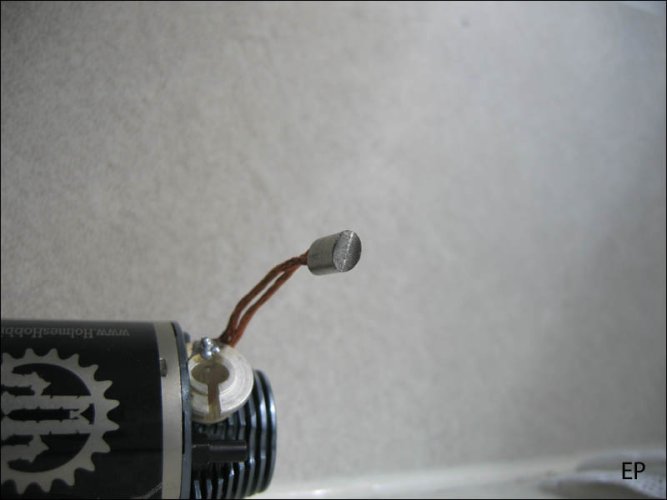

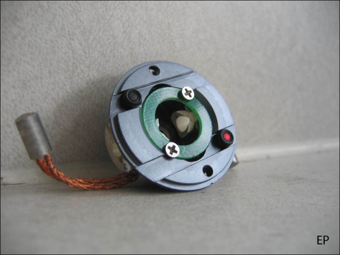

New stuff. Taken apart before I ran it. Looks like the brushes need a longer break in. Hard to tell, but they aren't fully seated.
The brushes on the motor look like the XX.
