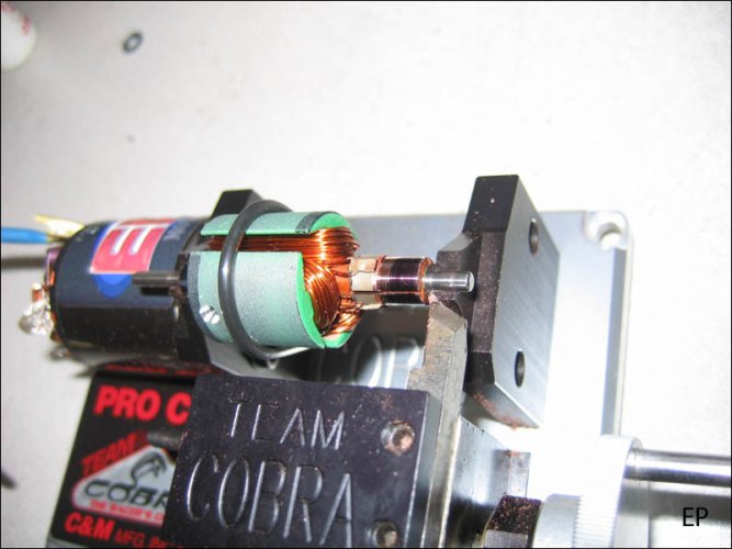

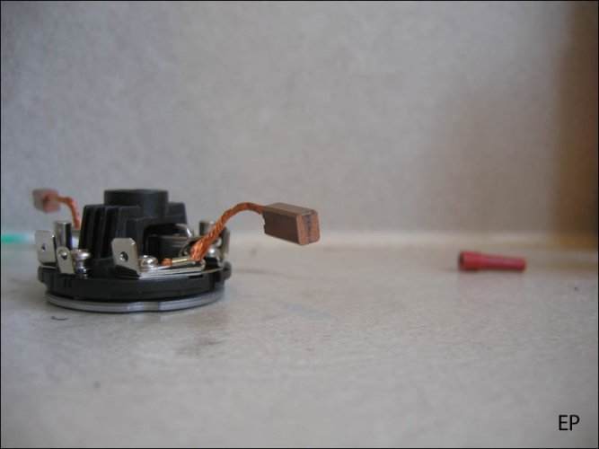

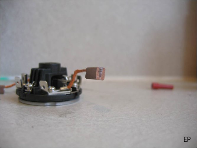

Good picture which shows where the comm hits, and therefore, hood shift needed.

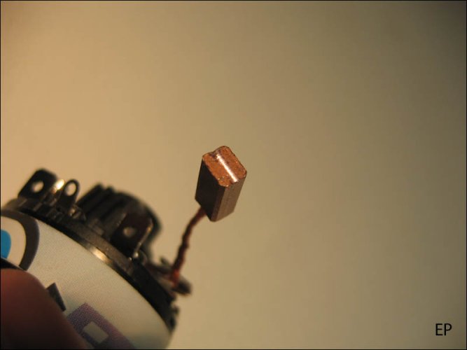

Here's the other Integy 45 turn.
I took the brushes out first. Pretty centered. Both showing a fat on one side comm.

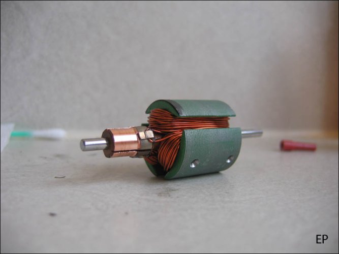

Oh, and here's the arm, wire winds are alright I guess, much better looking than that one I posted back a few ago.

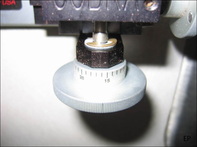

If you have not cut the comm yet, mic it before and after. Curious as to how much your taking off.
I don't have a tool, but I got the numbers on the dial and I'm keeping track.
First cut was at .135

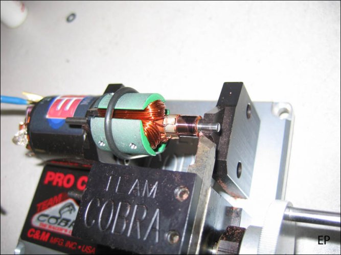

Second cut at .140 looks like this.

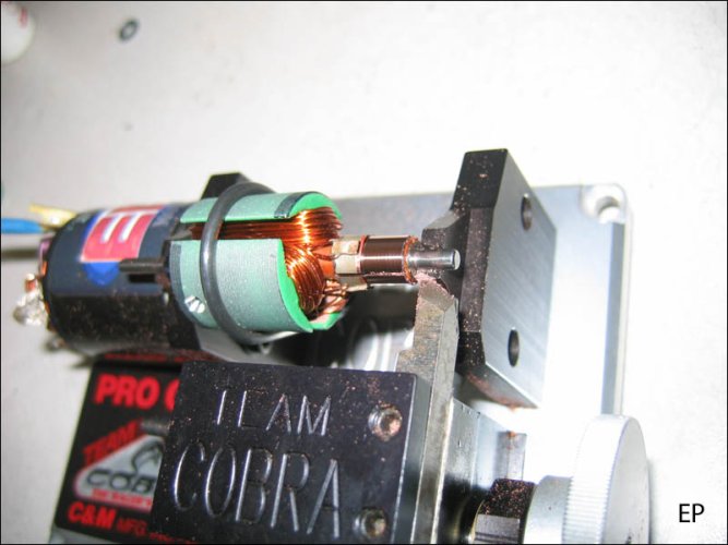

Here's where it gets good. This is what I was expecting. This is the 3rd cut at .145
The three pictures are of the same cut. One's almost clean, and one is barely touched.
I didn't keep taking pictures until I was done.
Notice I'm showing the same side that was nearly untouched on the third pass.

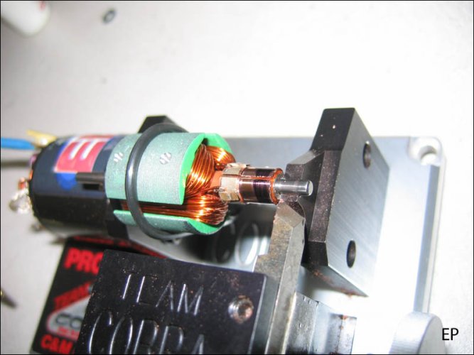

Only eight cuts. Four until the 15 mark, then I cut it up into thirds for the final few.
