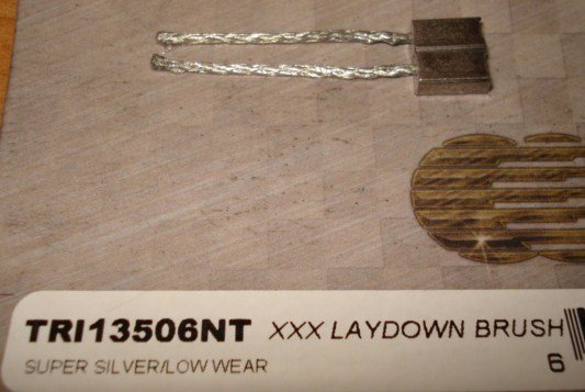

Anyone looking in ever try these. Found them on the Bay for a buck per set. Picked up 14 sets. The OG listed for 12-14 bucks at one time. I'm not really familiar with them.
