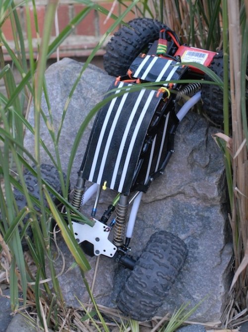

Porsche crawling...that is definitely a new one! Hahaha.
Nice one Dasher. I bet you will really see the stability shine once you install some Razors out back, as to get your lower links more triangulated.

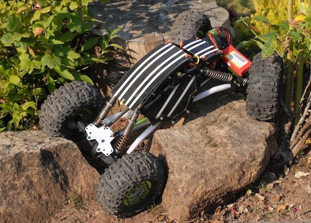

Yeh, Speed bumps can be a challenge.
Working on getting some Razors (or making something similar).
Having tempted fate by saying Boris can stay as he is for a while, I spotted KOM's quick fix of a small addition of toe out. Now getting a similr angle for both wheels when on lock.

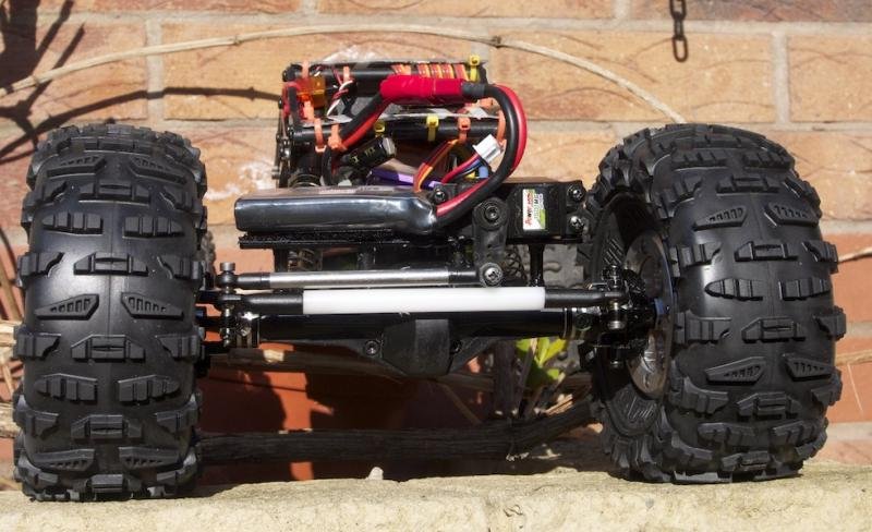

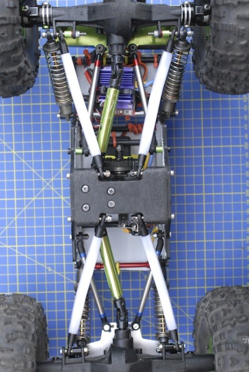

Boris finally got his hind legs up a little, thanks to some Razors. (Thanks NorZepal:)). This allows for much more triangulation of the rear lower links and it's much more stable now. It seems more flexible too.

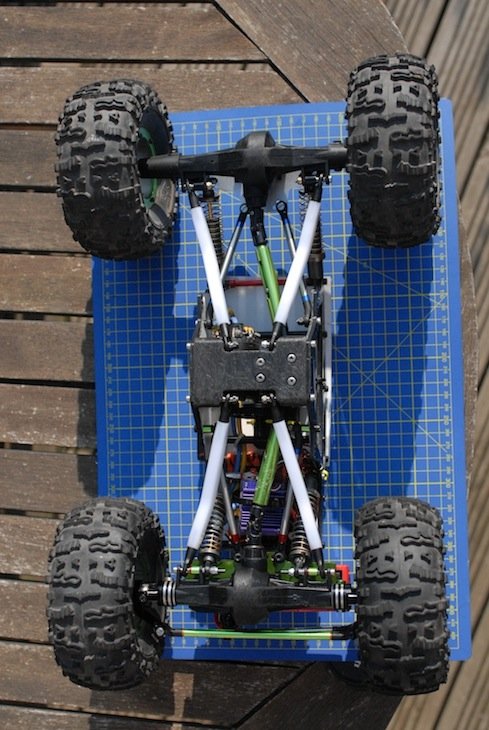

Boris has remained relatively unchanged for a while as parts have been accumulated for his stablemate "Eric", the Poison Frog. Eric is spending longer as a tadpole than originally planned and so Boris has been treated to some well earned new bits.
After a bit of measuring, playing with different rod ends and using Eric's PD legs for fitting out I decided that a set of four rear PD Frogs legs and some Traxxas 5347 4mm ends would set Boris up nicely. Luckily Casey had enough legs to spare!
Boris sits much better on these legs. They've also allowed for a little more triangulation at the from. Rear skid height is up by 4mm too. I beginning to think that I could also run slightly heavier springs as, although the Losi golds allow for really smooth articulation, they don't hold the chassis weight too well.
Sadly the legs don't allow me to get the front shocks inboard - biggest restriction here though is the size of the Rooster esc.
having given him new legs, Boris can also look forwards to some Gunner pins and Toobs in the near future as they too have been sat in the box a while (why is it that when you have a set of pins waiting, the old ones never break)?
So here's what he looks like now and if you're still running your OG Frogger, I strongly recommend you chase Casey for these legs before he sells out (unless of course he's thinking of using the same length legs for his MOA project).

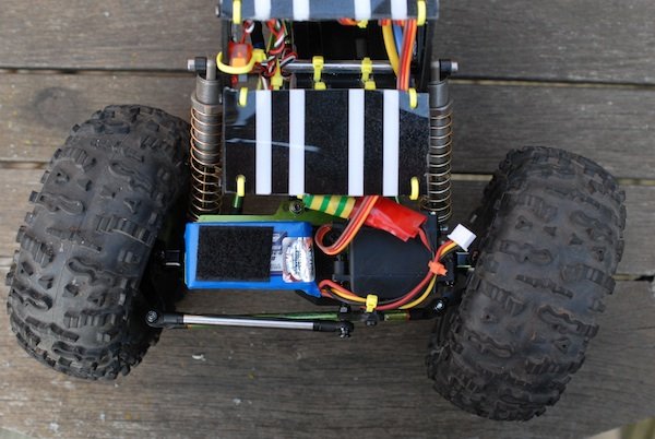

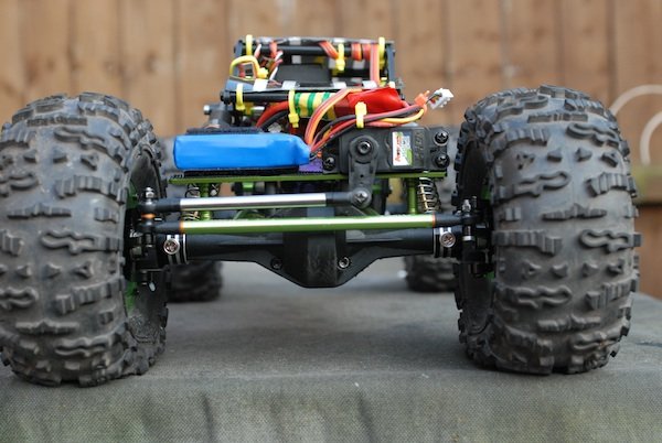

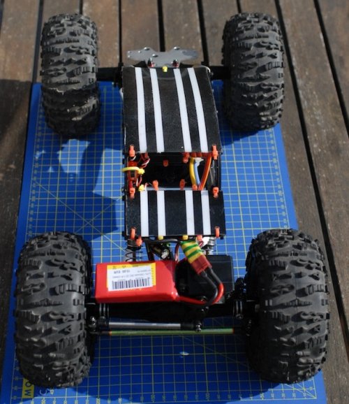

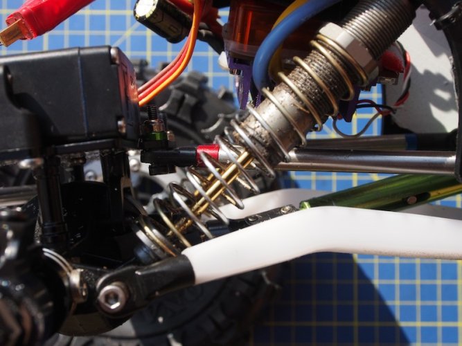

After much fiddling and adjusting, the Frog's legs have finally allowed me to bring about what I was looking for all the time - inboarding the front shocks. I may eventually move the Rooster, but the only way is up, and I don't want to raise the cog (an fxr will fit nicely though)!
Got another few degrees of steering out of it now, the tyres don't play on the springs anymore, stability has improved and climb over ability has improved too,
Not done the beef toobs yet - pins still not broke! (obviously not trying hard enough.
This is where Boris is at now.

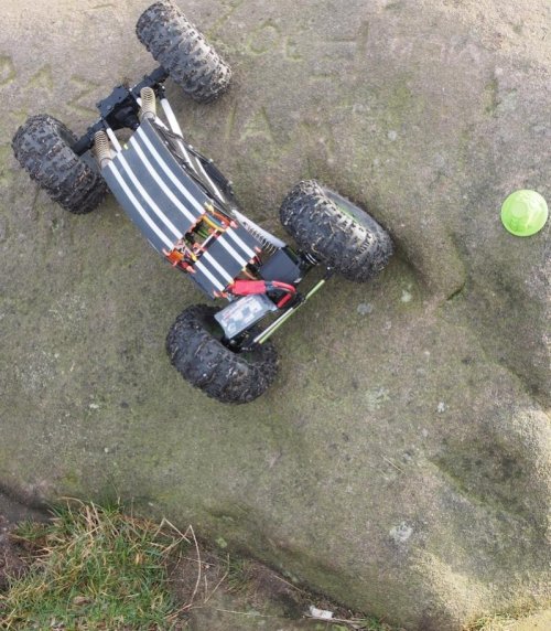

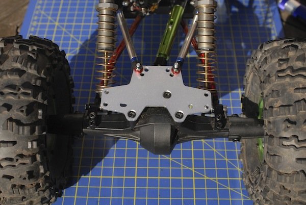

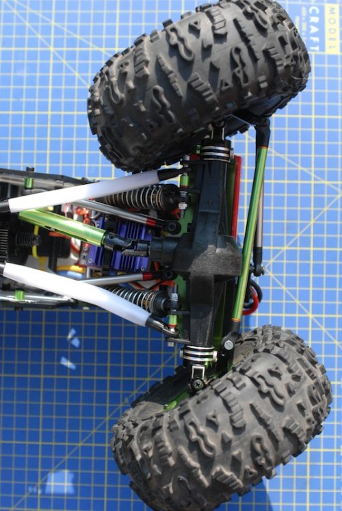

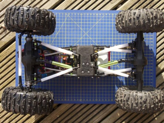

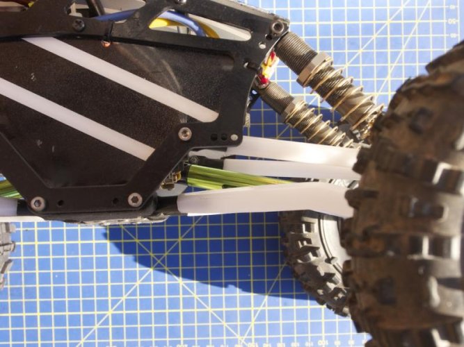

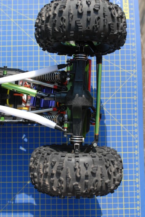

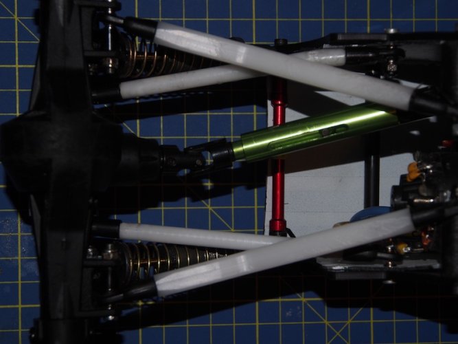

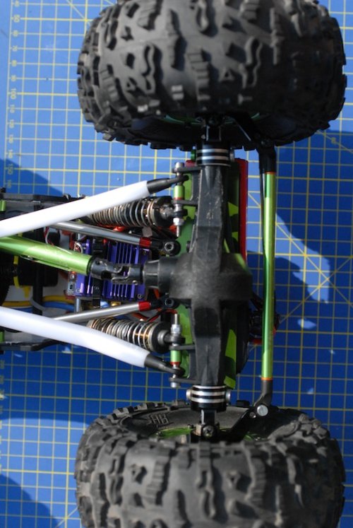

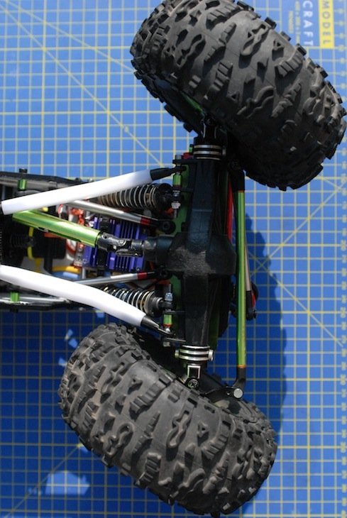

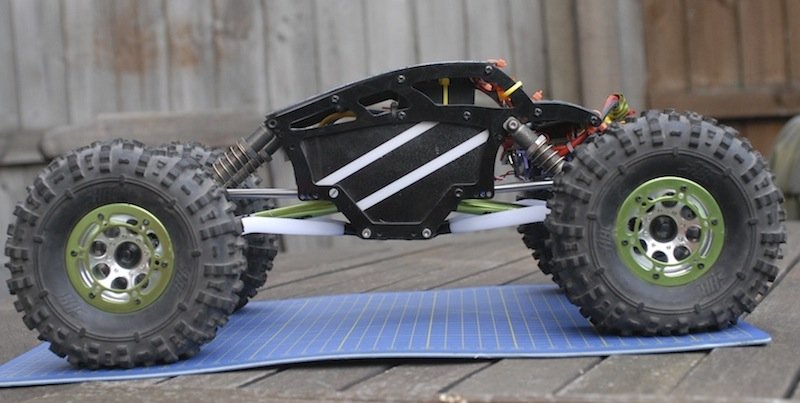

Boris is getting a bit of attention after a year when I just ran him in the same trim and set up. He's acquired on of Duuuuuuuude's D links and this has enabled the use of longer rear uppers - something that has been needed for a while. Initially, yesterday, they were mounted so that the link was above the axle. After running it yesterday afternoon it was flipped over so that the links are under the plate - it's much better this way. The real reason for changing things around on Boris was to get some link making practice in before cutting and shaping for the Poison Dart - which will also have Duuuuuuude's D link.
Rear axle control on the Frogger has been markedly improved by the use of longer uppers and reduced triangulation. The Frogger chassis is not the last word in sophistication, it's actually very similar to stock in terms of mounting positions available, but it does actually perform very well once carefully set up. It's been a good chassis to learn about how a crawler actually works!

The OG Frogger has done me proud. It's had more tweaks recently. If you're tempted to make your own links (it is worth it), and you go with 4mm ends then use the 8mm Delrin stock on both uppers and lowers. I thought that I could get away with 6mm on the uppers, and you can with 3mm hardware, but with the 4mm you need to use 8mm rod. I've just swapped mine out after bending the link at the rod end. I've also gone for a delrin tie rod too, again in 8mm - this way you can shave it to take in the pumpkin without losing to much strength.

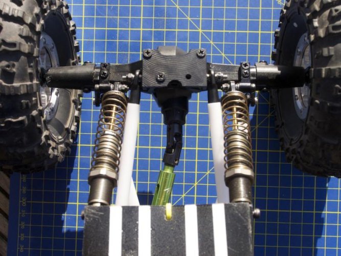

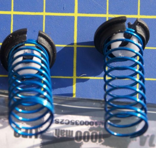

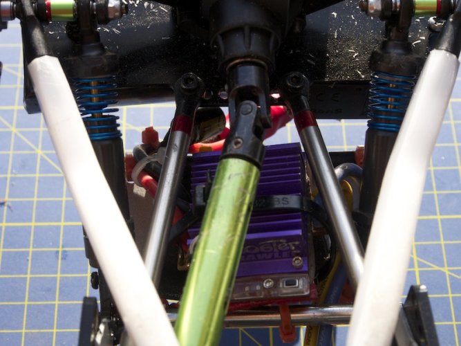

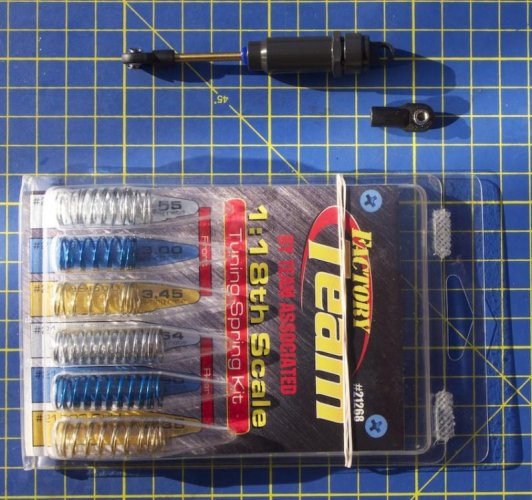

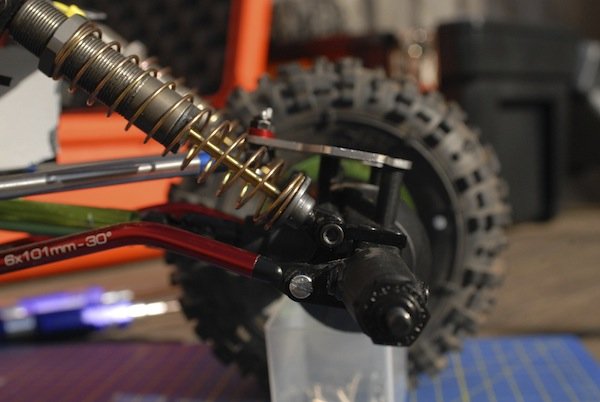

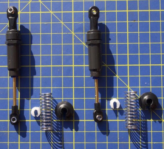

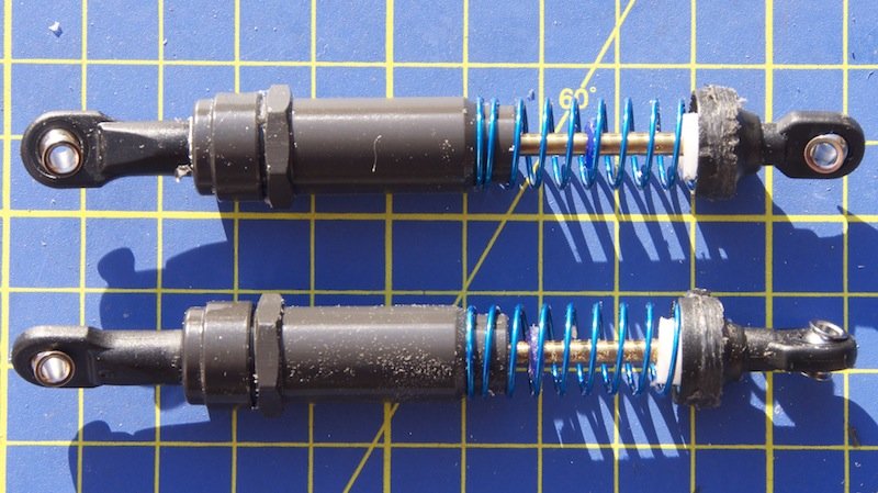

I'm sorting parts for the Poison Dart build that is ongoing (long. slow, build) and had set today aside to work on shock cap mods. As I had Boris out to do some measuring, I took a second look at him and decided that the Losi 4" on the front would go nicely on the PD, and in return Boris could have some Traxxas Big Bores up front, modded to 4" with the Jato ends. I'm not going the Losi Mini T spring route and instead am using the Associated springs. I've also modded the Traxxas cup by fabbing a small delrin inner to hold the spring in place - this has been fixed in place with cyano. I then took off the original lip.

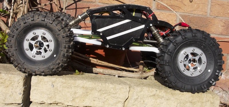

So this is where he's at now. No excuse for going AXR10 now as I've made room for the increased steering angle. It can wait a while though! PD build to do first. New Sedonas up front too (his old Rovers are going on the rear of the PD).
