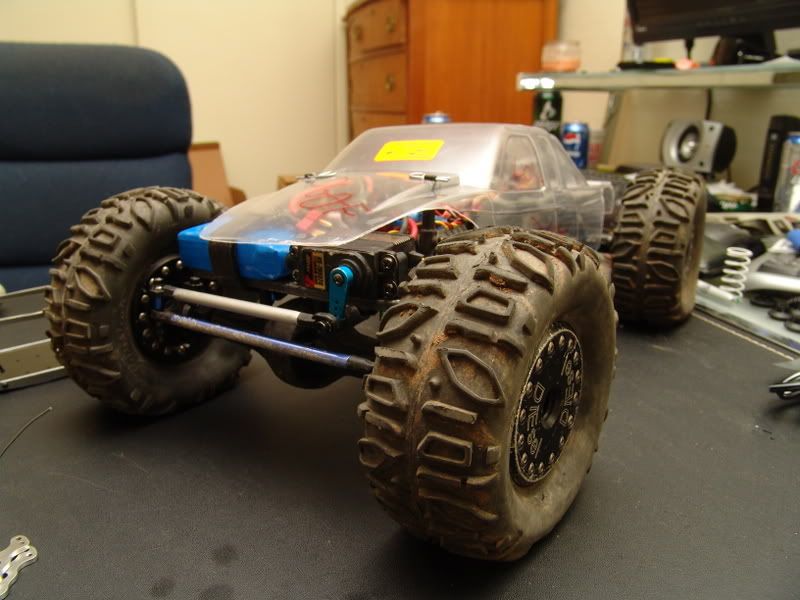

One of my biggest problems i was having with the Revo shocks is Articulation, and no im not talking Degree's
It seems with to thick of a viscosity they dont like to do/allow shit, So we put that 20wt in there (AKA WATER) and it Loosend her up a bit, was predictable and the axles finally moved.
Yeah thats what I am seeing as well. It takes for ever for them to bound and rebound.:shock: Other than that I am VERY happy with the setup.;-)
try some 10 wt in those shocks if you run it sprung with yellow fronts and pink rears. 30 wt with no internal springs works great full droop
Ok so I guess I just need to get an assortment pack of oil. 10-20wt. I am soo used to running the heavier stuff that 30 is as lite as I have right now. :lol:
diezel can tell my how long your up and lower links, and also what rodend are you using? your rig has got alot better snice sd comp.

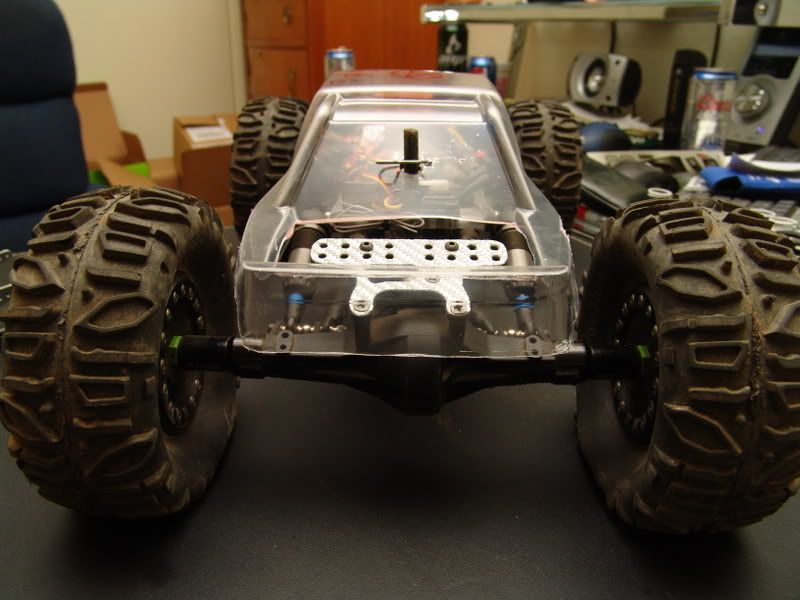

New body. Losi Grappler.
Hard to tell how low it is. But its low... LOL
After seing this....my rig looks so lame.......:-P Nice build. Nice to see a rig that's "high dollar" getting used and scratched up and not just posed for pics!! "thumbsup"
