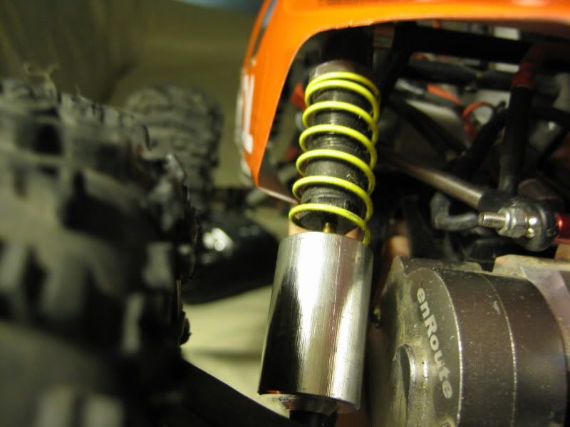

I used to run my shocks inverted but got tired of the air gap between the piston and shock body, so I started running them normal and liked it much better. "thumbsup" But then I got some Super 300 CVD's and the extra steering was kicking the crap out of my springs. Also at full lock I would get clod stall on the front and it turned in a jerky motion.
So I had a 2 minute conversation with JeepinDoug about how I wanted a machined sleeve spring cup. On his first attempt he made my dream a reality. Nice job Doug!
I have a small nut on the inside to keep the sleeve from sliding up the shock shaft. Now it spins smoothly with the tire at full lock and turning is smooth as can be. "thumbsup"
great Idea!! I think you should have them made longer though....seems like it has a small chance of getting caught up under the shock body??
if the sleeve was just a hair longer it would never have a chance to get hung up.
great idea...might have to try something like that myself.8)
Thanks. There is no more chance of it getting caught under the shock body than the spring. you'd have to see, it does not move side to side. And the big issue if you made them longer would be figuring out a way to hold the shaft while installing the rod end.
