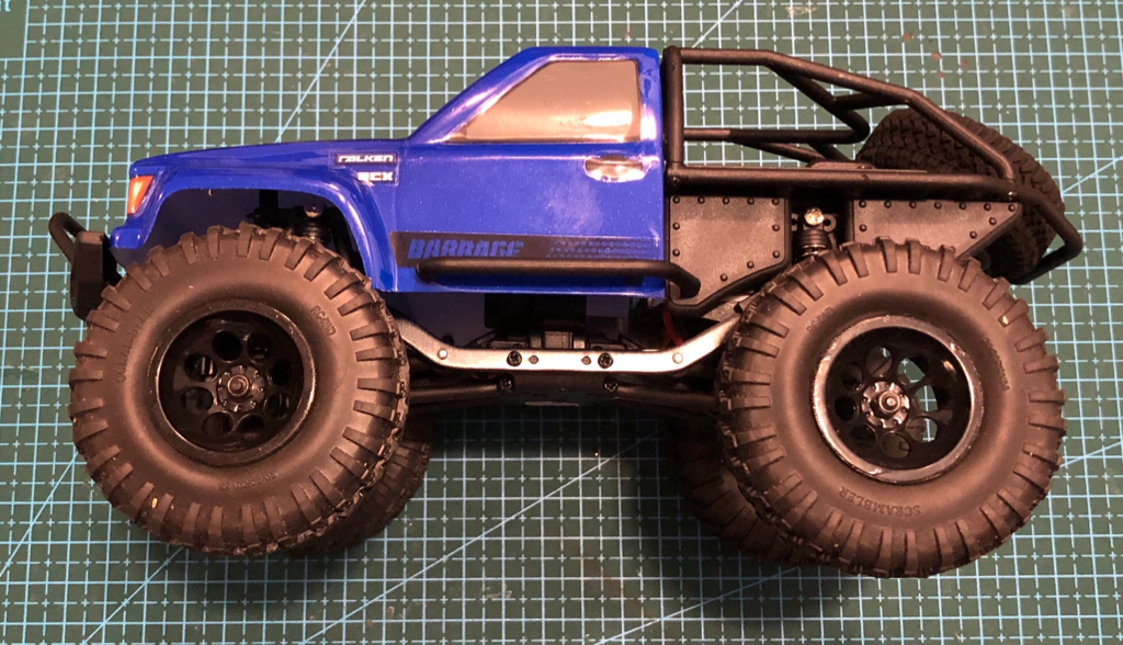

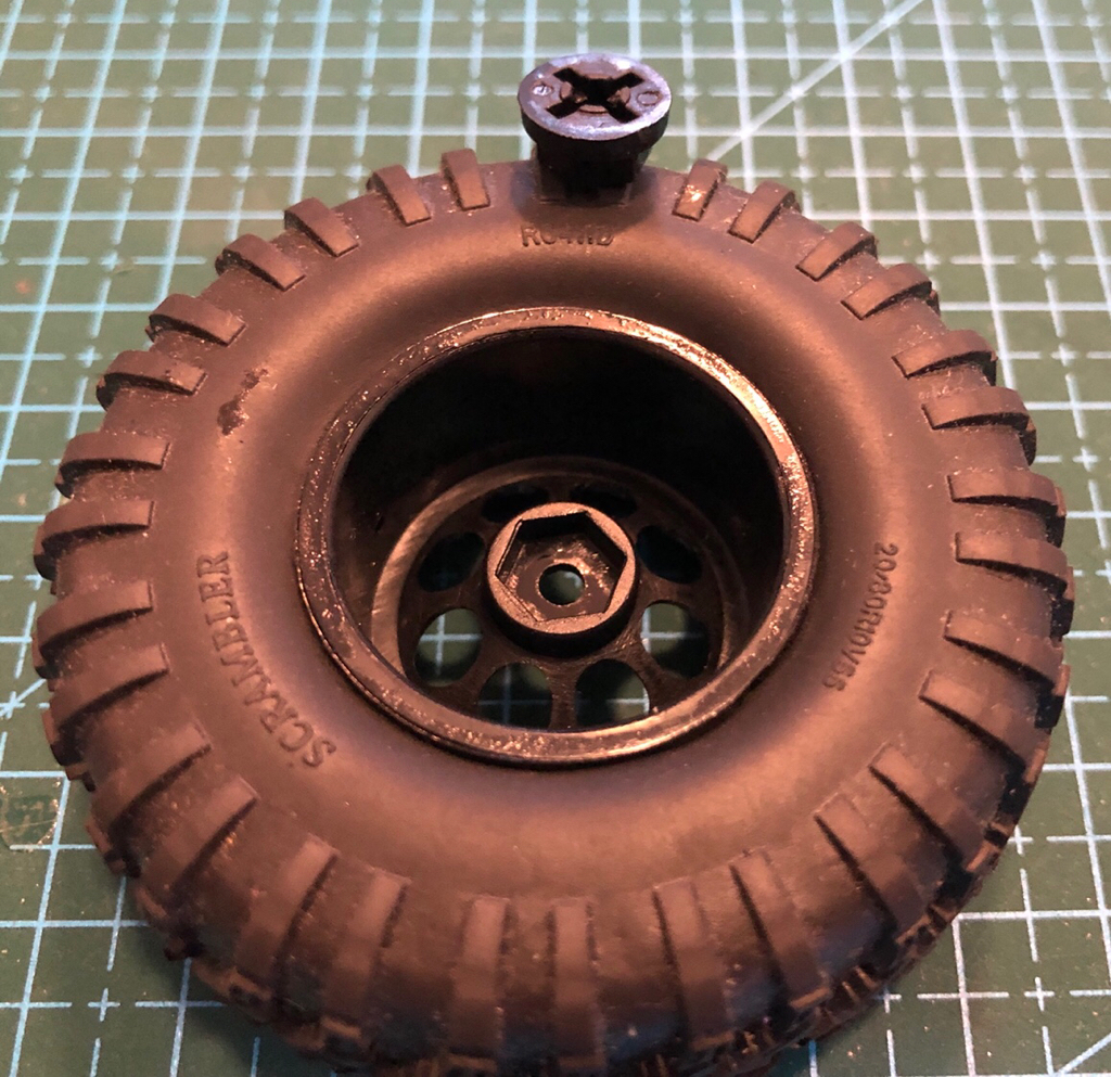

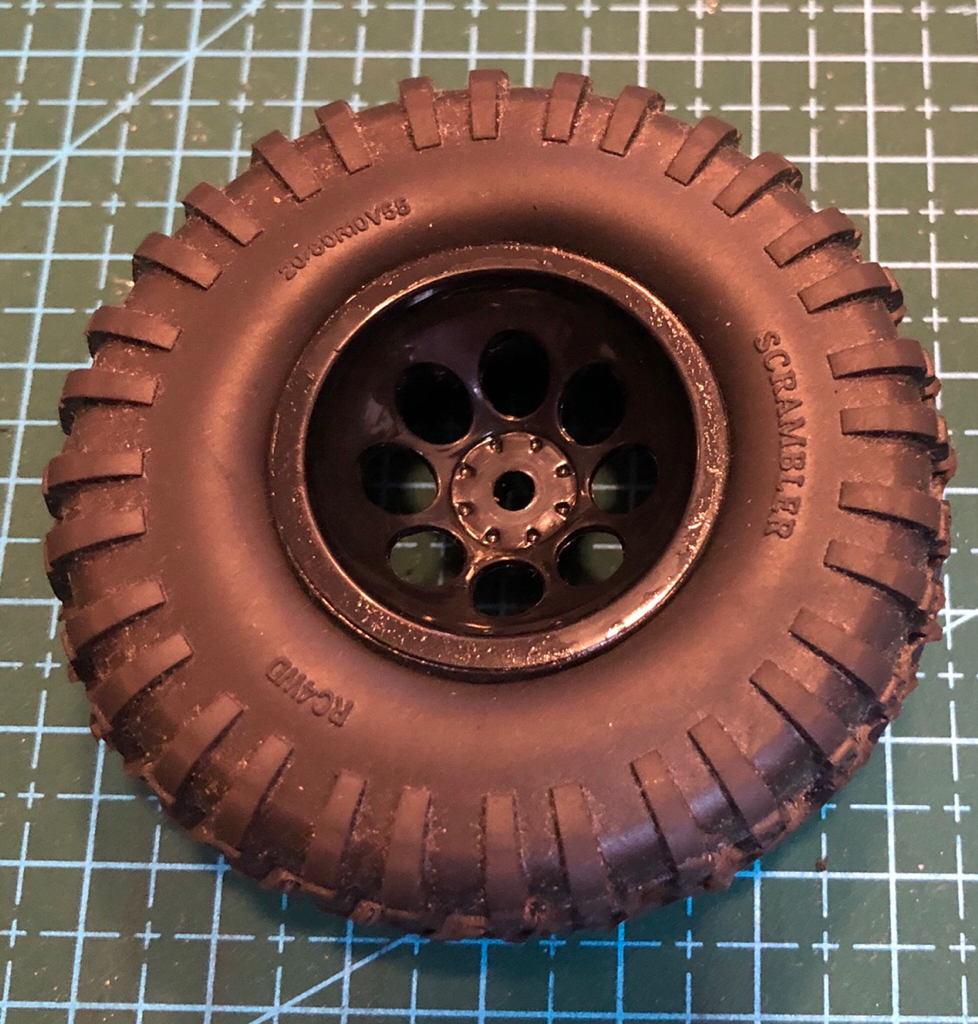

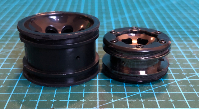

Well, I was rummaging through my junk today and happened across the hulled remains of a never built Basher RockSta. I looked at the wheels and wondered if I could pull the tires off. Tossed it in the freezer for a few hours while I did other things like finding a set of Scramblers. I was able to pull about 80% of the tire, bead, and glue off. I trimmed the rest with a hobby knife and voila.
Here’s the RockSta next to a Trekker wheel.
Significantly wider.
A little taller.
The gooder pics.
Hopefully more tomorrow if I can get the other three wheels stripped.
Meh. It may work for someone else but it’s too much for me. I guess I’ll swap the wheels/tires and put it back into the box.

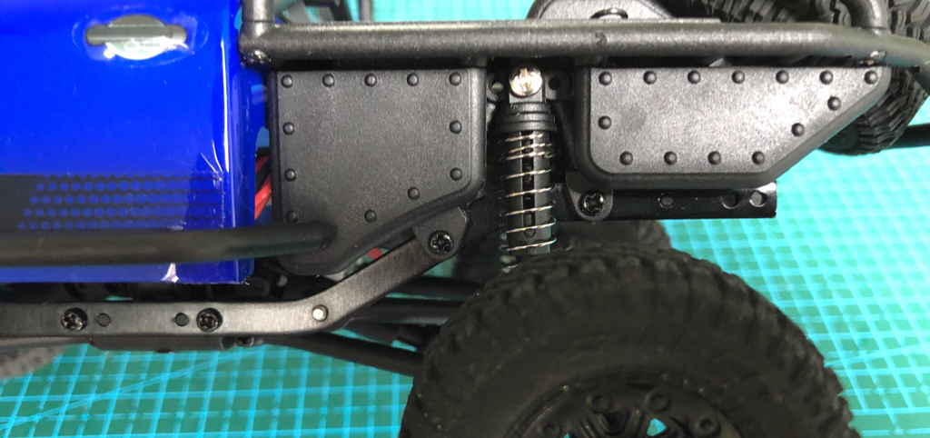

I cut off 1.5 turns of each spring.
It’s just the width of one wire plus a little rise in the coil. Not much at all but it gives a couple mm of droop.

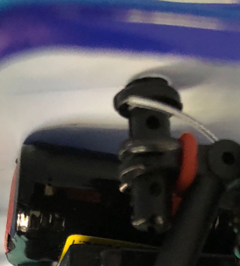

Next I tried to lower the body posts to make the sides of the flatbed flush with the frame. The battery would not allow this so I moved it forward like previously mentioned. In the forward location over the CMS it will contact the body some. In this case there is no fear of rubbing the paint through since the body is white plastic.
By lowering the body posts one notch I was able to use that to hold the O-ring in place. Note the contact with the body. Also, with the battery over the servo the front-rear weight is nearly 50/50. Using the wheelbase as it’s about 55/45.
With the body posts lowered one notch it closes the rear gap nicely.
