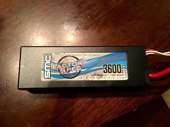

The beauty is, if he does want more, he can just drop in a 4s battery. That's what I recently started running in my crawler Bomber with the Puller Pro 2200. It's nice to be able to dial in performance to the day's adventure just by choosing the appropriate battery. It's so easy that I carry the 3s with me and if the trail tightens up and gets more technical, 2 hood pins and I throw in the 3s battery. Voltage 2 speed. "thumbsup"
This one. Fits the battery tray perfect and lasts an hour and a half or longer for me.
Cool, i'll have to pick 1 up for testing purposes. I'll really be breaking shit then! :lmao:
