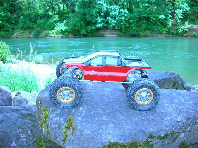

Finally done making parts for my clod
Yep, them portals are awesome! Like others have said, if they are a bolt-on you could make some $$ I'm sure rc4wd has already called you tho, so you already know all this :lol:
Let us know how they hold up. They definetely look beefy :)
Got the body Painted

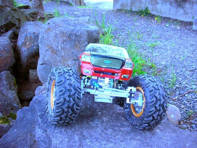

Well got the truck done and on the rocks. Found my weak link, I've Blown 2 rod ends and 2 hitec 5645 servos. I just order 6-32 metal rod ends from mcmaster and I will be ordering two titanium gear robot servos. Portals are working great stump pulling power.:-P

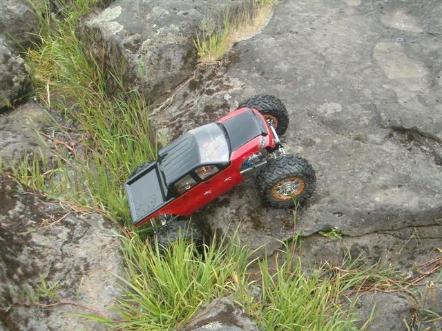

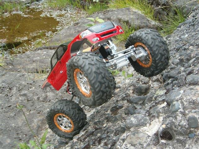

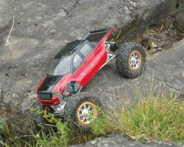

That sure is some nice pics my daughter took.Glad to see you got them.:flipoff:
I just realized.She only took the good ones(pics 3,4&5).:flipoff: :flipoff:
See you at work.
Ya I was pissed my camera was messed with by someone who will be nameless, to protect the innocent:twisted: :twisted:

Just weighed the truck and it is a plump 11 pounds :shock: and I think I need about 12oz weight in the front tires and I am installing meatal rod ends because I 've been blowing out plastic ones.
When Crawling really steep rocks it likes to do wheelies so I think the weight will help things out. I really like the portals because the gearing is so low you can stop on a very steep surface and stop and the truck will not roll backwards. 62pyro has a video with the truck attempting to crawl up a very very steep man made concrete structure. It messed up my body pretty bad I hope he can get the video posted :-P
Is that concrete face really slick? Seems like that steep face should be no problem for the almighty Moabs. Bouncing....Weights in front should help. Will be pushing 12 lbs.
There's a lip part way up that likes to hold you back.You can kind of tell by where they had the most problems.My truck has 6 ounces in each front wheel and he has since then added the same amount to his.
