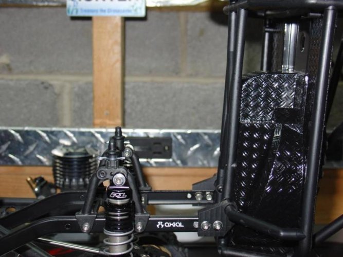

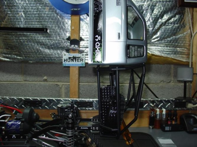

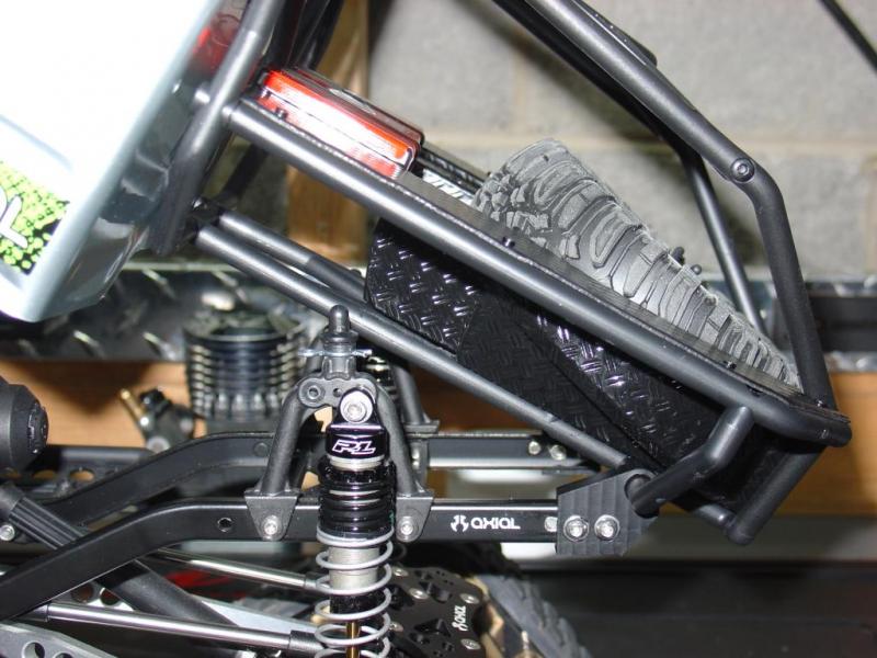

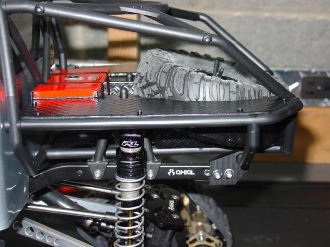

You have two holes in the side of each bracket but you only have one screw holding each one on your rig. Does the second one line up with another hole in the frame? Could I add hardware to utilize it for over kill strength? Do you think it needs a second screw or will one and the over the frame rail design be enough?
The second hole does line up with an existing hole in the frame, though a tab on the stock rear frame cap fills that hole. All you need to do is drill it out and insert a bolt.
Drill to 2.5mm if you want to screw into the end cap, or drill to 3mm and nut/bolt it.
I will make an instal tutorial tomorrow.
One should be enough, but if you are going to really flog it hard, I recommend two.
