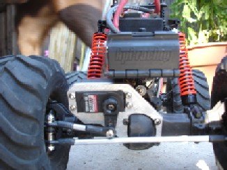

this is how I have mine mounted...it works great with a 2/3 pack shown is a 8 cell pack from holmes hobbies, it works great and its a great place to mount a battery pack.

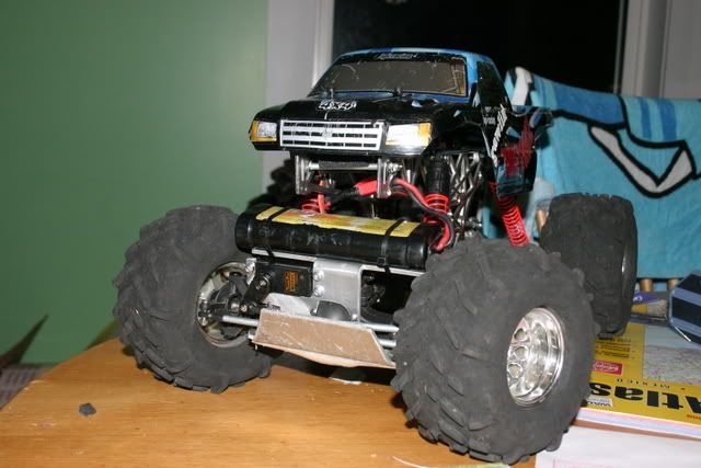

He builds them custom so whatever you want...this is one of the 1500 cells in a brick pack let him know how much tail you want on the plug and sit back and watch the mail "thumbsup" I made the mount out of AL and mounted to the steering bracket and the hub screw then placed velcro on it and the battery and secured it with the ziptie. VERY STABLE.

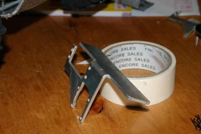

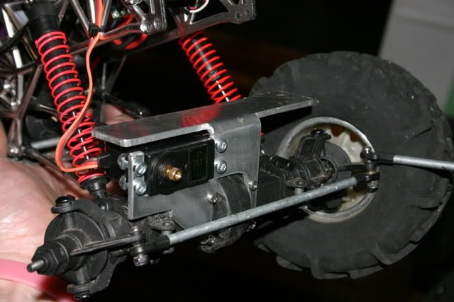

Here's a servo/battery mount I made using harley0706's servo template as the basis for the servo mount and the inspiration of mwrightt's parallel axle mount for the battery. It is constructed of 1/8 aluminum. This was all done with a drill press, a hacksaw, a cutoff wheel on my dremel and a file - so its easily made by the masses. I printed the jpg file and it was to scale - on my printer anyway. This is the prototype so I can't be held responsible if there are mistakes/flaws in the design or design drawing.
This is why I call it The Hammerhead!!!
