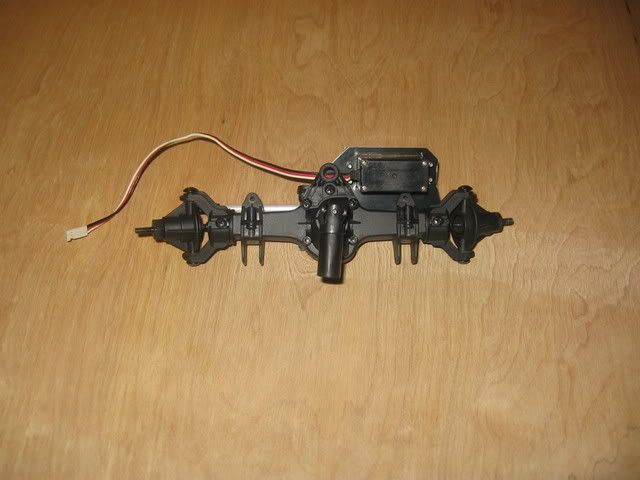

Good template Harley, someone else actually sent it to me and I used it, worked out good...here's the pics...
Thanks again!!!!
*edit*
Whats up with your link mount on the servo side?
Not sure what you mean?
I did have a problem with things binding up when turning to the right, but I wanted to get everything put back together to make sure things were gonna fit/work right. I'm not sure what to do with this problem, any suggestions?
Also, does anyone that has used this mount have and pics from the rear of the servo? Was looking at things and the shock mount is really close to the servo...I turned my link mounts on the axle because I'm going to make a 4 link but now it looks like the shocks might interefere with the servo, in fact, I had to move the shocks to the backside of the stock upper mount in order for them to clear...
Edit: Duh, now I know what you meant, I don't know what was going on there, I did have to trim it up a little after I took the servo plate off and on a few time and realized it was rubbing...guess I could've trimmed the plate up instead but that dremel on aluminum screaming was starting to drive me crazy..

To make a long story short, the only drill bit I had that was the correct size to make the hole in question broke while I was making the holes for the servo to mount in, which is part of the reason I'm only using three of those four holes - it started to deflect so much on the last hole that it's out of place. I'm going to remake this mount at some point, probably in aluminum, but that's better than it was stock - now if I could just find guts for the front axle!
