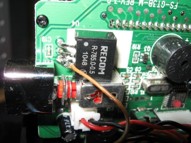

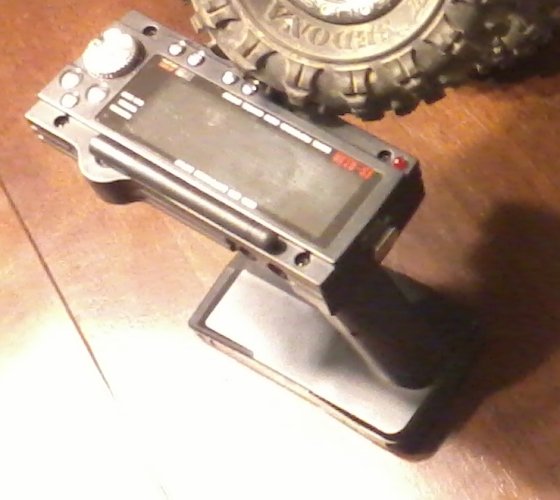

I put a red flashing power LED on mine and tied it into the 5v VR pin but it dims the backlighting every time it flashes. It annoys me to the point where I might just pull it and put a constant LED in. Would a cap inline help with the current sags? Pics of where I tied in the power for the LED and of my radio.
Your using a current limiting resistor right? 20ma shouldn't cause any noticeable dimming of the back light....also you can set your backlight to never turn off. It pulls 20ma just like a led does.
It's a Radio Shack special but I can't find it on thier page. It was rated to 5v so I'm running it direct.... is that my problem?
I'll have to get back to you, I don't have it handy. I don't know if my meter will react fast enough to catch the flashing mA draw. I'll see what I can get and post up.
