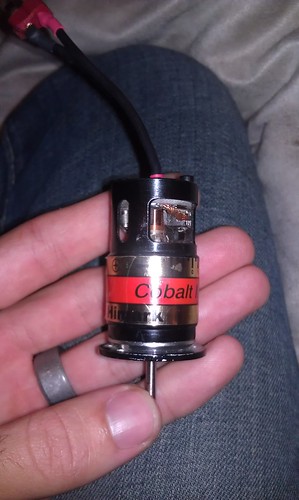

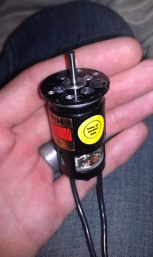

I just acquired one of these cobalt motor from a friend with the stickers a bit beat up with the turns unreadable. Is there a way to determine the turns? Any other marking to look for? Wire Size?
Thanks in advance.
You can normally count the winds on the bottom of the armature, that is the easiest way.
