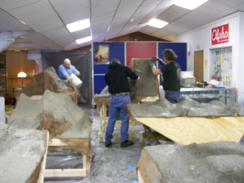

Had to have security keep the riff raff out of the build day the guy on the right side of the pic is trouble kinda like a stray dog crapping in your yard and then stepping in it and dragging it around your house.

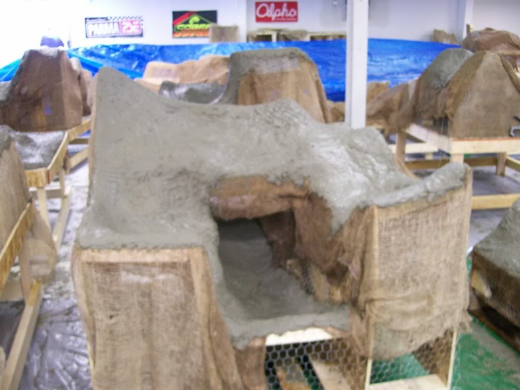

We still need to do the finish coat and patch a few more spots but its starting to come together.Thanks to all the WiRCRC members for all there hard work great to be associated with the group Hope to see everyone this weekend for comp #8 at kaspers setting up a trail truck course for this weekend make sure you bring your trail rigs as well.Thanks again everyone

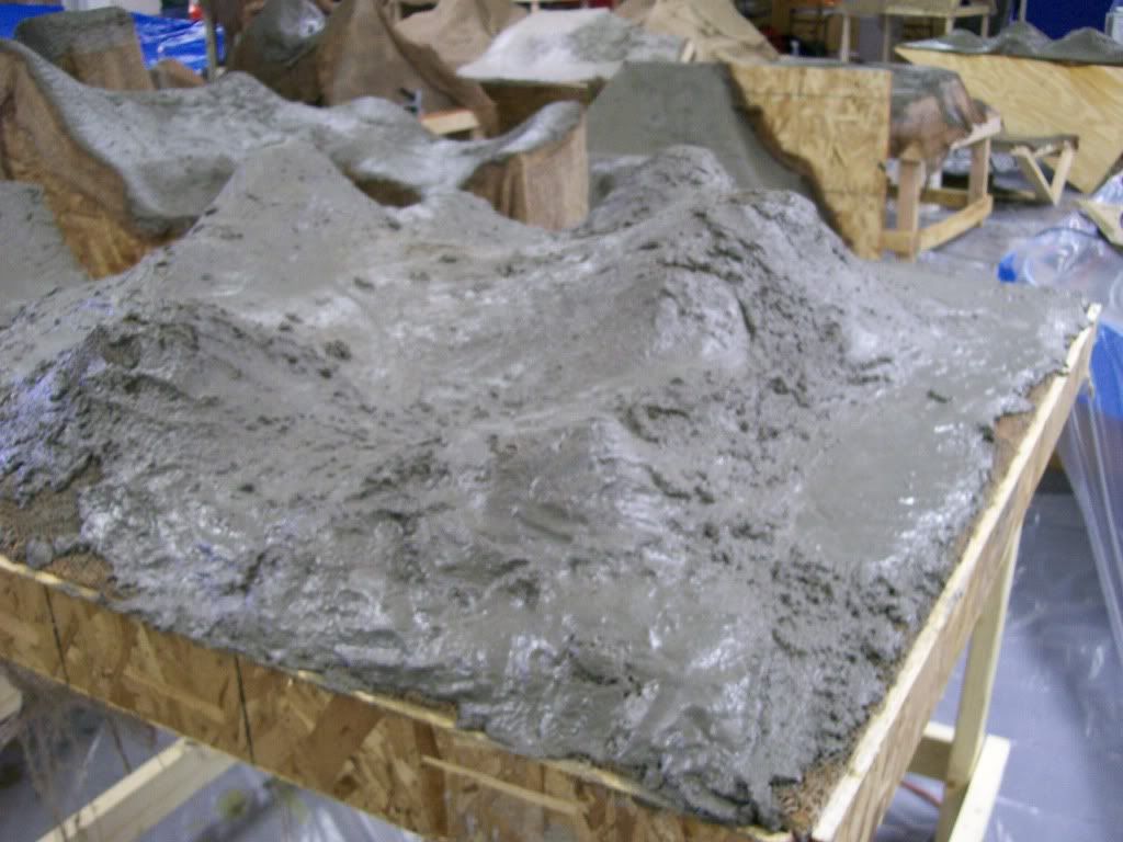

MAJOR Kudos to Creeper for the way he did the finish work after we did the slop it on job. I don't know how he gets it to stick the way he does but it works....
Yup, he has the golden touch. I think he has special gloves cuz the concrete just sticks to mine.:mrgreen:
Thats called the hand of god he sure did have the touch thanks to T-buck for the slow speed video nice work.

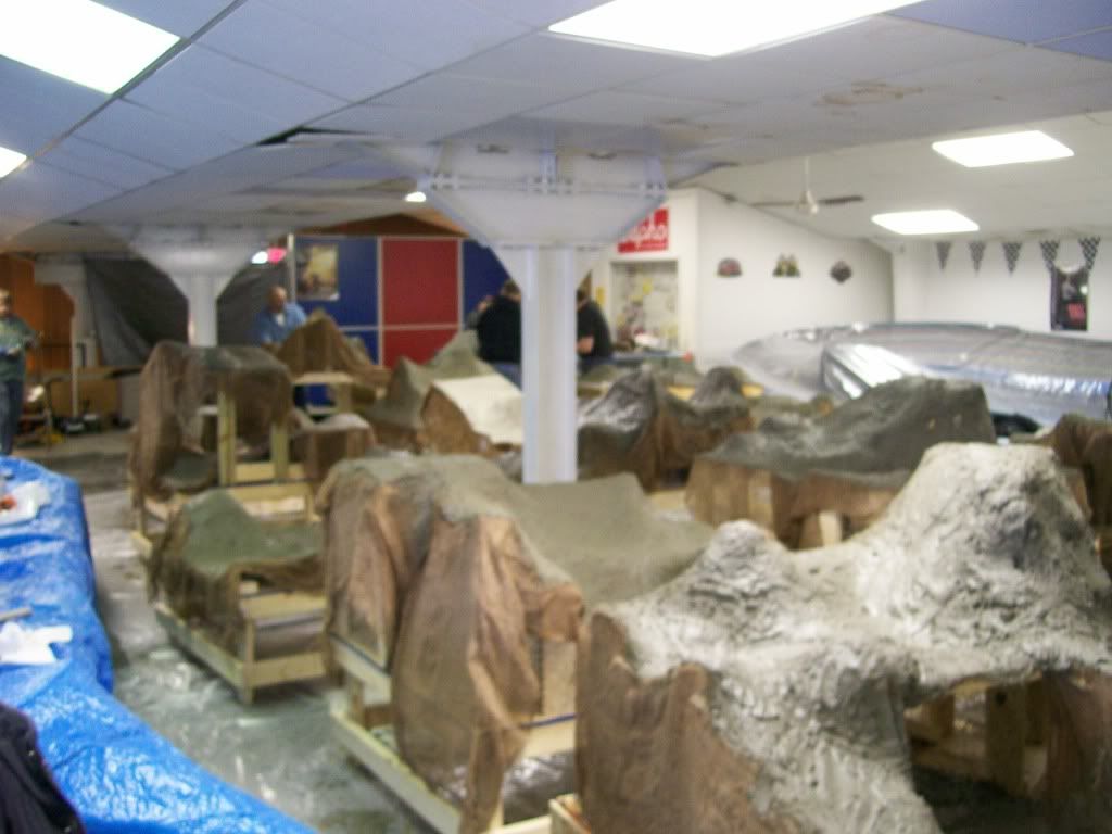

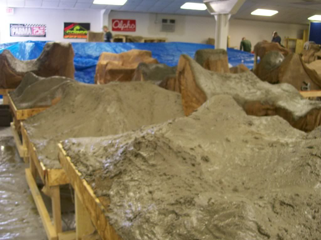

We went through 8 bags of create 94 pounds each to 56 bags of sand at 50 pounds each seemed to best suited for our build we got a lot more to do and a second coat yet we have 18 4x4 sections and 8 approach ramps with climbs at 60 degrees and several tunnels going under and over on some so actually we had a few that took more then others.
If my math is right you used about a 4:1 mix then and about 35-40# of crete per section. Looking at the pics they are a little bigger pieces than what we did. So my figures were a little low but not too bad. That's some good info to know for calculating our next builds.

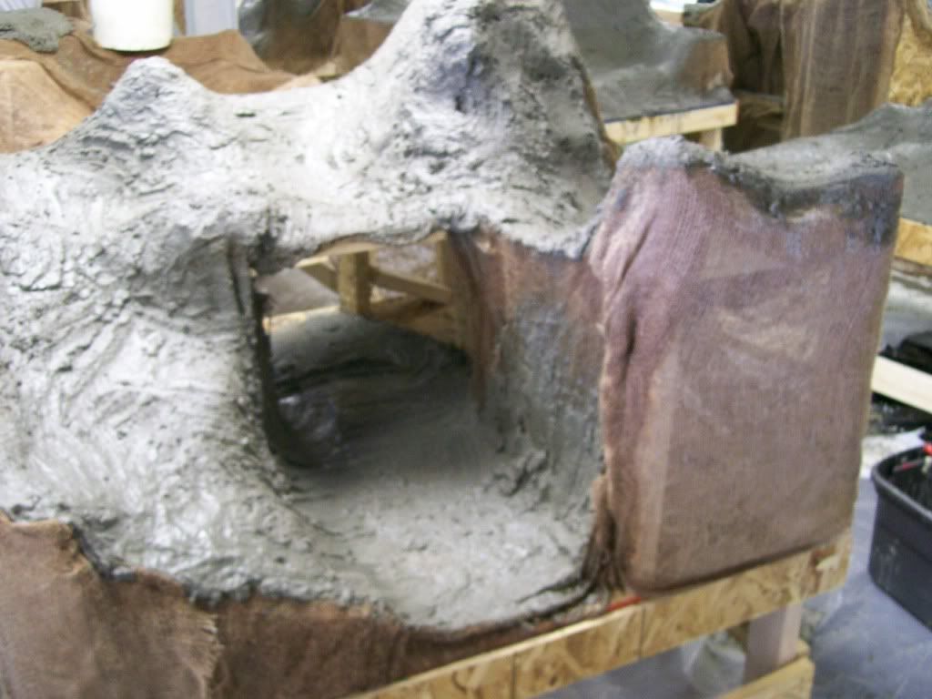

Carl(creeper) has been working on the track three days straight and he finished up all the side pieces and the tunnel areas we all need to let him know we appreciate all he has done.We will be laying a skim coat on all 24 pieces this weekend and if all goes well we will be crawling at the oshkosh location soon anyone who is free and would like to help hope to see you on sunday.
