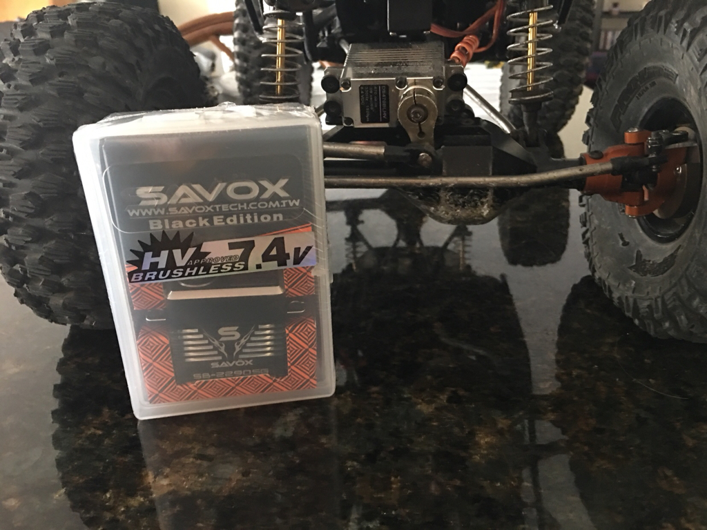

FWIW I poopooed on people who were super recommending a savox 2290 because of its excessive torque and I thought it was overkill. I now have a HH 500v2, and I love it compared to the servo it replaced, but it still doesnt move the tires in situations I feel it should be able to. I run the CCWP2.0 bec as well. I feel like running your 470 at a lower bec rate would not make you very happy with its performance, but it really depends on how you feel.

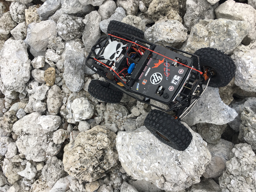

Here’s a reason 500 oz won’t work.
11# of Wraith on 3srunning tall , big tires in rip rap. I ate 3 Holmes servos(V1&V2) ripping the gears out. I bound up a PM470. The 2290 centers every time , and will allow this pig to turn.
