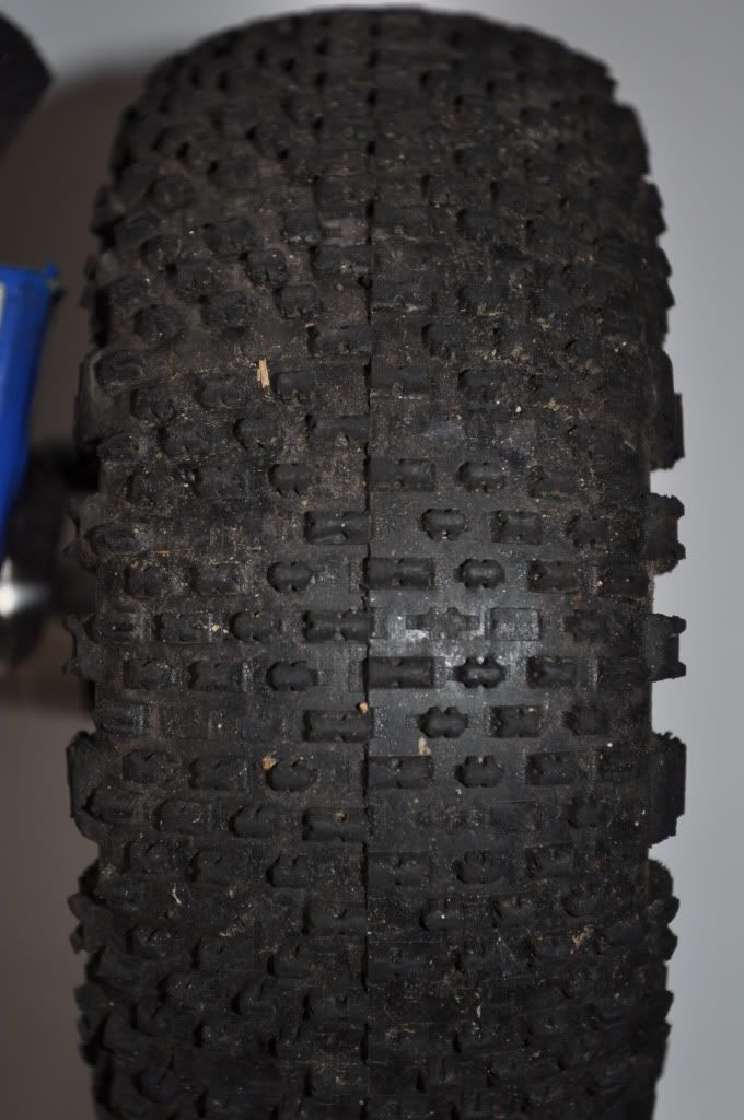

I was checking clearances and such last night when I noticed my DH2's were rubbing the steering knuckles!!!!! Under power at slow speed on a vinyl floor I could see the front tires hesitating every so often like there was something binding up so I picked up and looked closer...that's when I saw what was happening. The slop that still exists in the bearings and knuckle assembly even with NEW parts throughout was allowing the wheel to wobble enough that the tips of the inside of the DH2's were catching the edges of the knuckles. The right side was even catching on the steering arm! Here's a pic of the "tips" that I'm referring to...

Ok so in my struggle to figure out how to get rid of the slop in the knuckles (just one of those things I can't stand) I replaced the kingpin bushings with stock replacements, installed brand new Avid rubber seals inside and out and even installed a new front housing while I was at it. I went with the rubber seals this time to see if I could feel any difference between them and the revolutions, which I have another set of for later.

Yes, There was someone who posted in my build thread a while back with the exact same issue. He also posted some pics detailing theproblem he had and the possible root cause. His issue was the axle shafts of rather the drive pin placement. He had broken a axle shaft and when he had gotten a replacement, its pin hole was off. Therefore causing his wheels to rub the exact same way. Check there first. Post 97"thumbsup"
I remember that post about the pin hole being off, but they were rubbing with the stock shafts in and I actually just replaced them with a new pair...I forgot to mention that. I had picked up an extra set just in case a while back and since everything else was going to be new I went ahead and threw them in at the same time. There's plenty of room between the wheel and the knuckle where the hub is, but the play or slop that exists allows the wheel to move enough that it contacts the knuckle...on both sides...its not just one wheel that's hitting.
