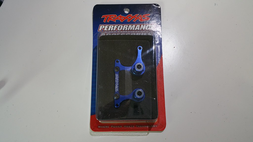

I received and installed the aluminum bellcrank. Of course I forgot to take photos of that. Still to come.
I did find one issue. The aluminum steering knuckle, or steering block as Traxxas calls it, is hitting the A-arm. I was going to remove some material from the A-arm, but I didn't want to weaken it. I found that under its own weight the knuckle lifts up just enough to clear the A-arm. This is even with a Teflon washer installed at the top. So I'm going to leave this as-is unless I run into binding or other issues.

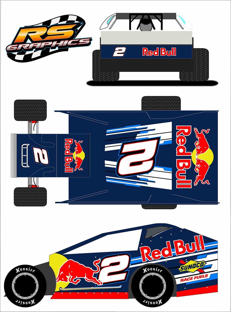

I got the final proof for my custom Mudboss body. I'm pretty happy with the way it turned out. I can't wait to receive it!

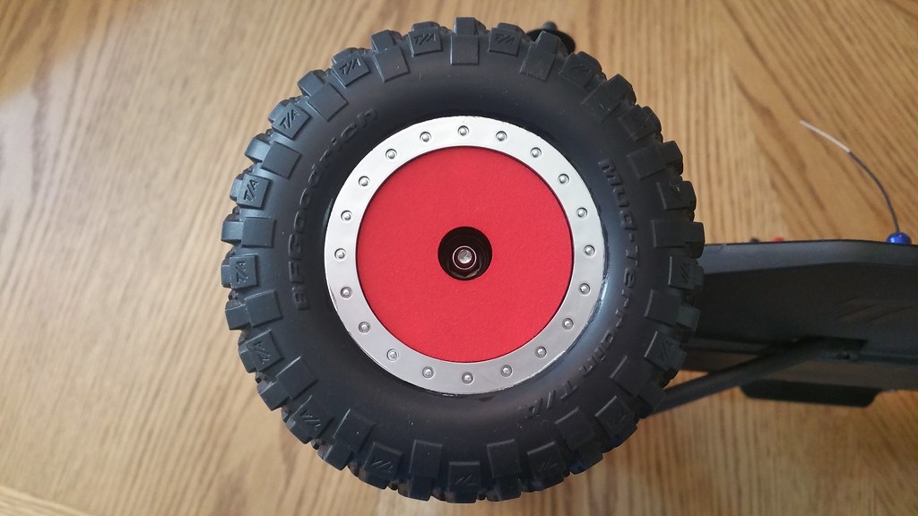

I'm not a fan of wheel dot stickers. I think they look cheap. I still wanted the wheel insert look of full-size dirt oval cars so I modeled some up in SolidWorks and had them printed by Shapeways. These snap onto the stock Traxxas Raptor wheels. I left a center access hole for the nut driver for ease of use. I didn't want to have to remove, and possibly break, the wheel covers anytime I wanted to get to the wheel nut. I love how they turned out.
