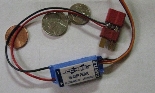

I recommended a Tekin FXR and 45T motor combo to a friend, after he just got a new AX-10, his first crawler ever. He asked me what I thought a good set-up would be, and so with a bunch of research, I found this thread and the Tekin products sounded great. I showed this thread to him, and told him it would worth picking up. He bought the set-up, and I helped him solder and calibrate the ESC. I am really impressed with the Tekin FXR and 45T motor combo. It is extremely nice. Excellent control, and I am amazed at the small size of the FXR! I like this set-up so much that I will be buying two FXR / motor combos for my own crawler, except that right now, they are so popular, no has them in stock!
When I soldered up the connections for my friend's crawler, we also installed a Castle 10 BEC. I installed the Castle BEC with a Deans mini plug, so he could disconnect it, if he ever wanted to, or had to send it in for repairs/replacement, without having to un-solder anything. I simply soldered the two BEC wires right to the male plug of the Tekin FXR, and then cut the BEC wires about halfway back, then soldered the male/female Deans mini plug in between. It makes for a very nice, clean install, and the BEC can easily be removed anytime he wants. Make sure to solder the female mini plug to the 'hot' side of the input power, so that when you run without the BEC plugged in (if you do) there is no chance of the plug pins shorting out.
I'll ask him to get some photos of the set-up, if I can. Because of the external BEC, we simply popped the internal BEC red wire out of the Tekin's FXR plug and wrapped it up with some electrical tape, so that if we need to, we can always put it back in place and use the internal FXR's BEC like normal.
